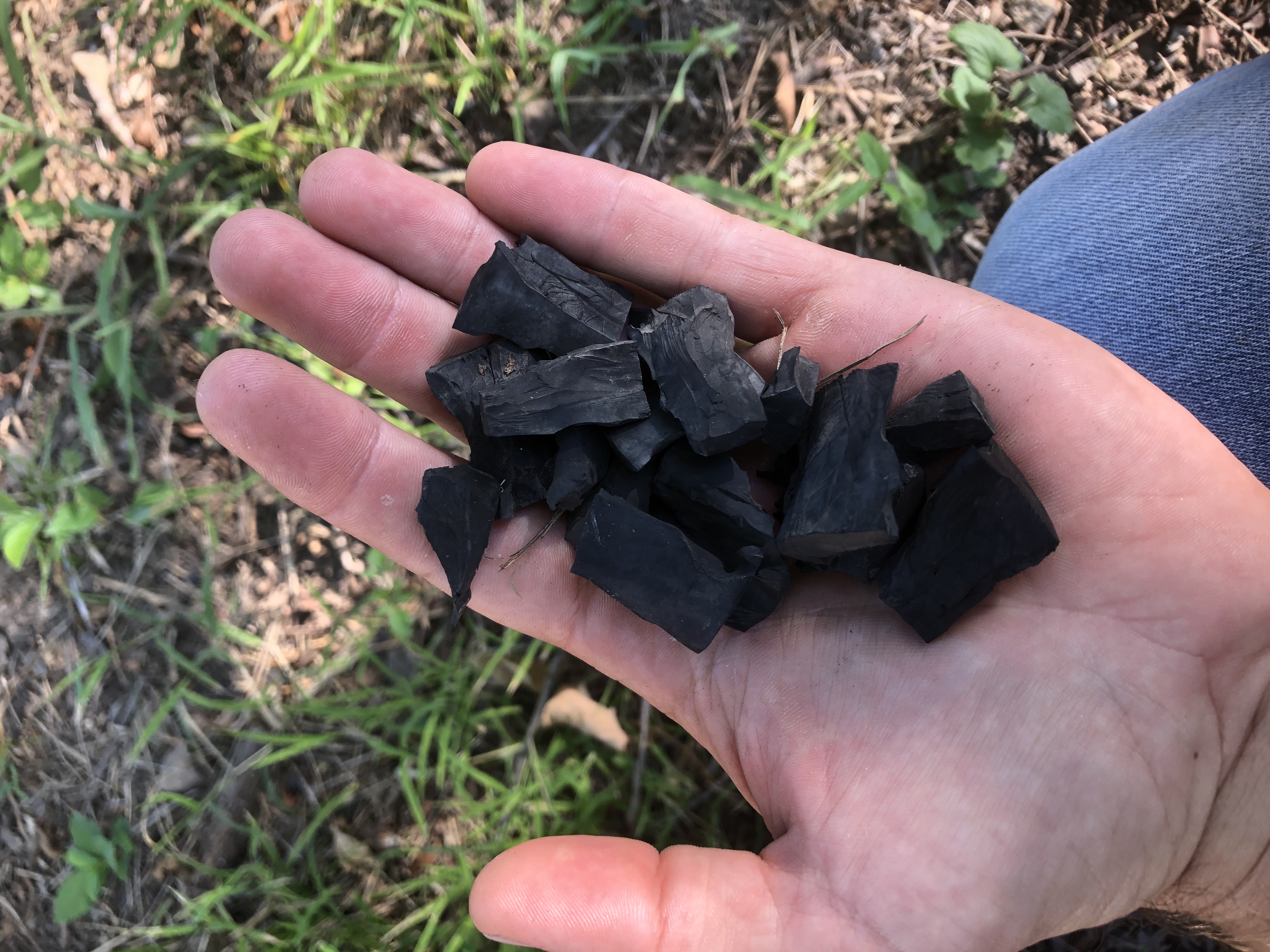

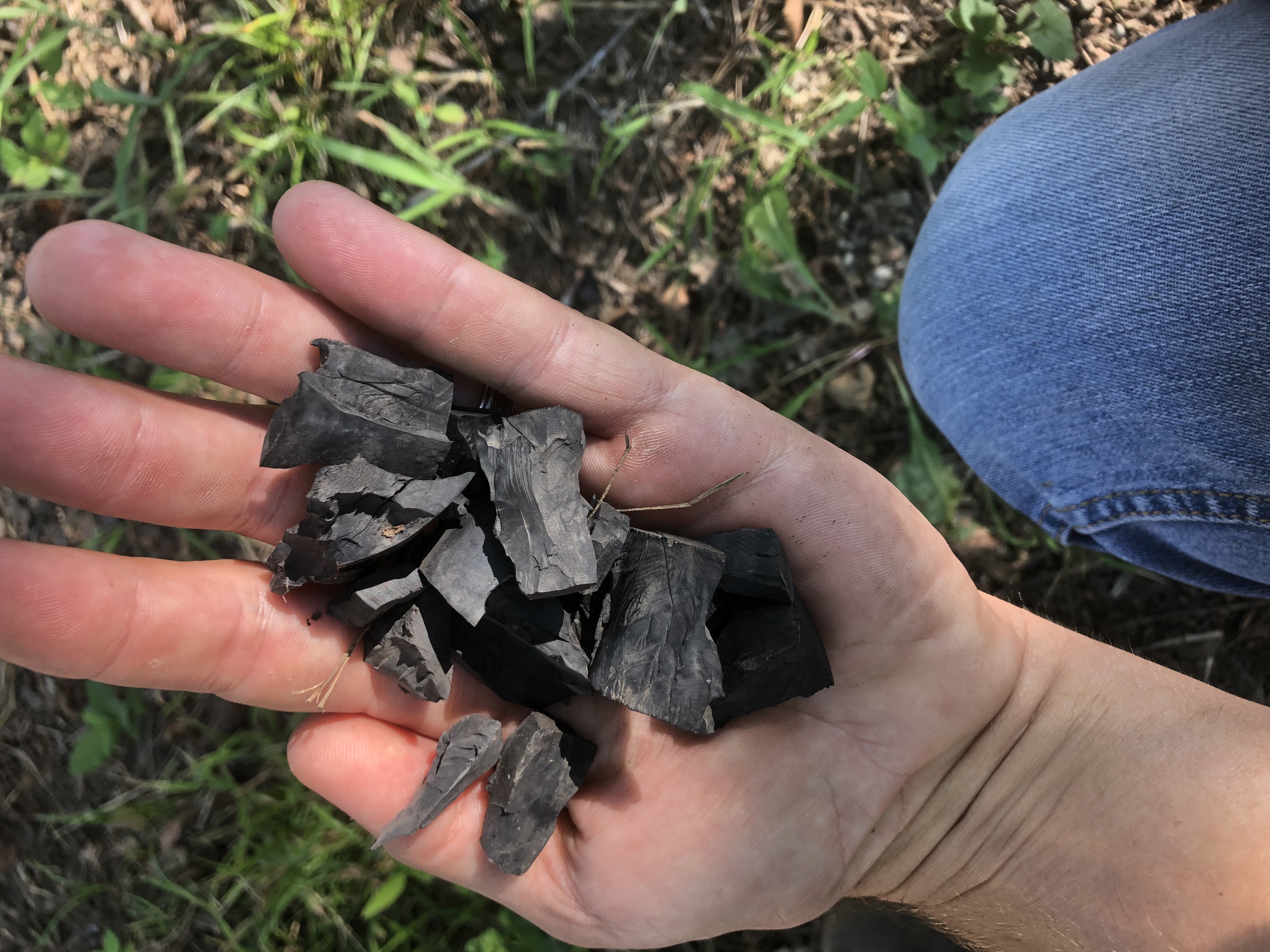

59390857-5CB8-42A3-9B9F-41C689239193.jpegCEDC1B78-5478-46EA-8E0B-65820F3B109C.jpegSo, I checked all of the test port pressures and didn稚 get a reading. While I was under there, I found some shredded rubber inside the tunnel opening where you access the hydraulic filter and test ports. It looked like it was possibly round and about an inch thick, no telling what the diameter was though. I went back to where it quit working and there in the grass were a bunch of the same shredded rubber. It痴 about the density of a tire cleat. I知 assuming this could be the culprit but have NO IDEA what it could be. Any help would be appreciated.
   / JD 4200 won't go forward or backwards and PTO won't function #35
That's the remains of the torsional damper. It is item 3 in sub-section 6 (crankshaft & flywheel) of the engine section (20 Engine) in the catalog link above. The engine is now mechanically disconnected from the transmission input shaft.
Time to split a tractor. But I think you will also need to pull the bell housing to remove the torsional damper from the flywheel. The front jacks mount to the bell housing, so the rear of the engine block will need to be supported. Perhaps with an engine hoist from the top side. Be advised that the engine will tip on the axle pivot if supported from only one point on the bottom.
