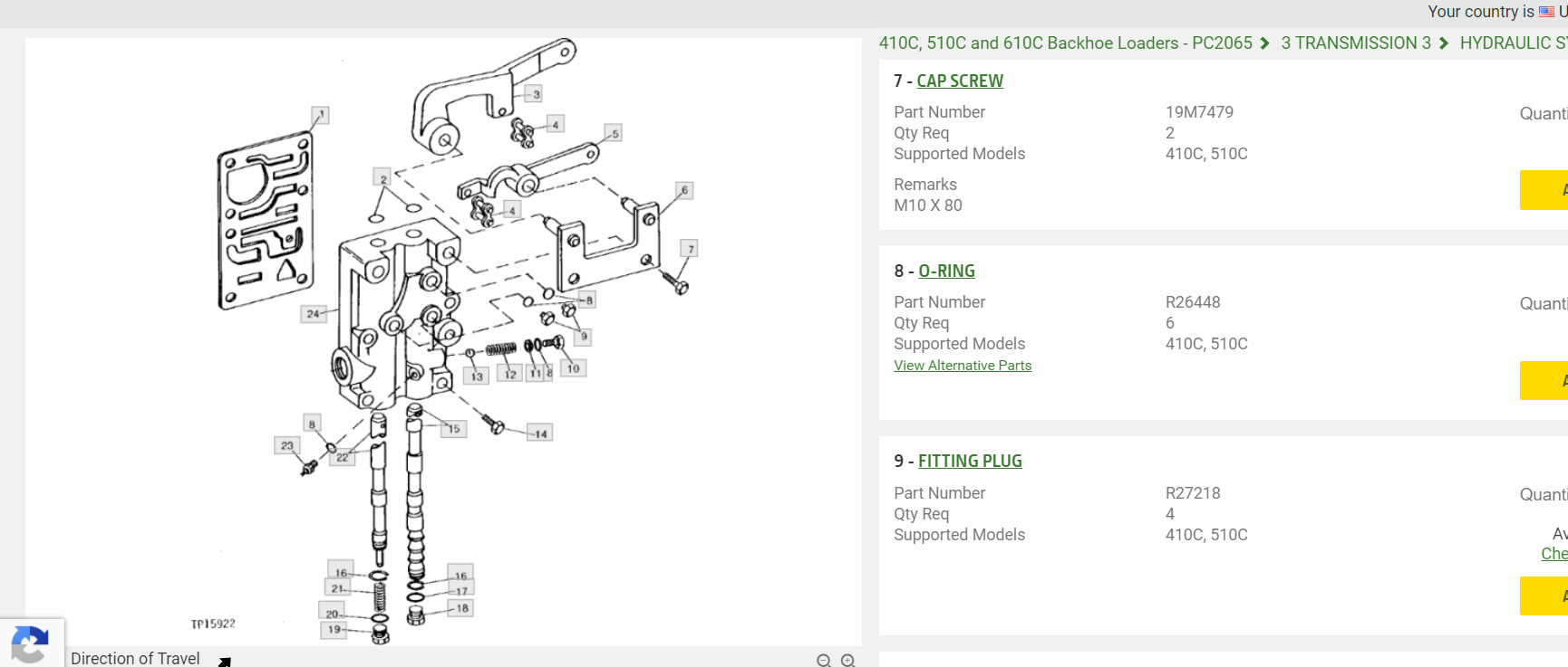

I suggest to check shifter linkage to be sure it's attached correctly & is operational. Also check pressures on reverser control valve.

I did check the linkage and it seems to be operating as it should. After this started it did work perfect again for a bit, then failed.
   / JD 410C shifting problem #6
It's possible the gasket in the photo I posted has failed allowing hyd pressure where it shouldn't go.

Jim, I think you hit on something about the shifter linkage. It is very sloppy but I tried adjusting it and reverse was now neutral. More adjusting and its back to reverse is sill forward. But it did change for the better so I am going to explore that more.
   / JD 410C shifting problem #8
Older JD BH's have a history of faulty reverser linkage but I was guessing on your model.
