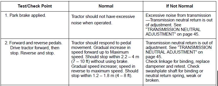

/ JD 4100 HST, roll adjustment? #6
How long does it take to stop? The service manual for the 4100 shows an allowed range of 7 to 10 feet. Agree there is no simple adjustment for this.
I have not measure the distance but, even when I mow is will roll over 10 feet. And If I were moving forward at full speed I would say the roll is closer to 20 feet. Where is the "neutral return spring", is it a tension spring located below the RH foot plate or internal to the transmission?

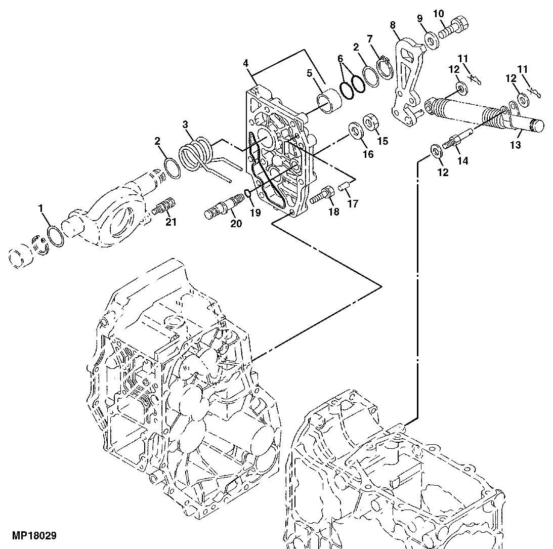

/ JD 4100 HST, roll adjustment? #8
The torsional damper is part #13 and is external to the tranny case. I believe #3 is the spring-and it's inside.
#9
Mine looks the same, I remove #13 and it appears to dampen correctly. I evenn drove the tractor without #13 installed. The tractor stopped quicker after backing but, did not change in forward. The lever #8 just returnes slowly, could be a weak spring but I would think is would break instead!
