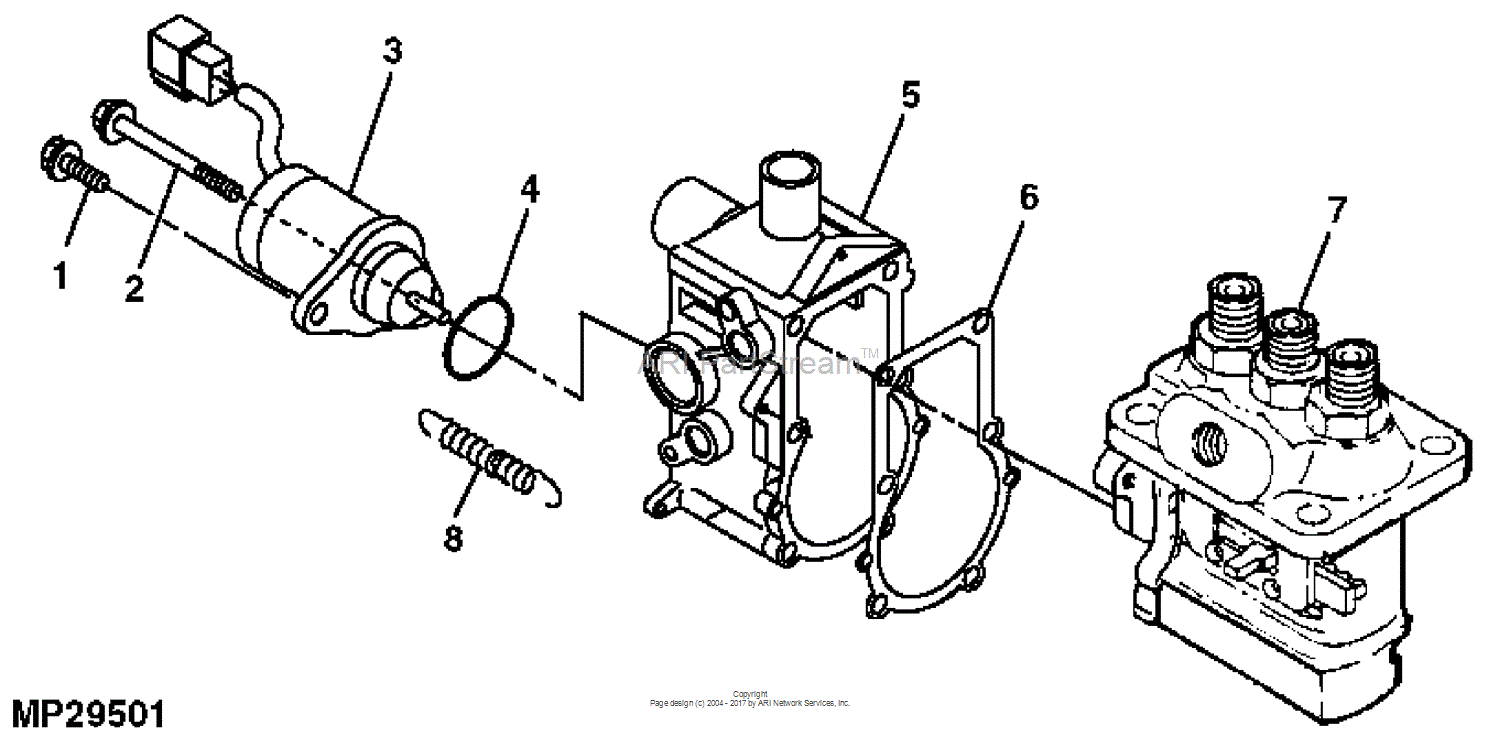

I'm alittle lost Bucky.. does it run WITHOUT the solenoid.?? Try it..
IF it doesn't.. look at how the sol. works.. it PUSH'S the control rack to shut it off.. & a spring pulls it to RUN.
So reach in the hole w/ your finger, a cut-off coat hanger or a scribe & see/FEEL if the pumps control rack is moving..
U should be able to push it & have it return..
IF this problem is because the helper put gas in it{no lube in gas}.. the rack is probably stuck.??
Have the throttle position in the RUN WIDE OPEN position when checking the rack..

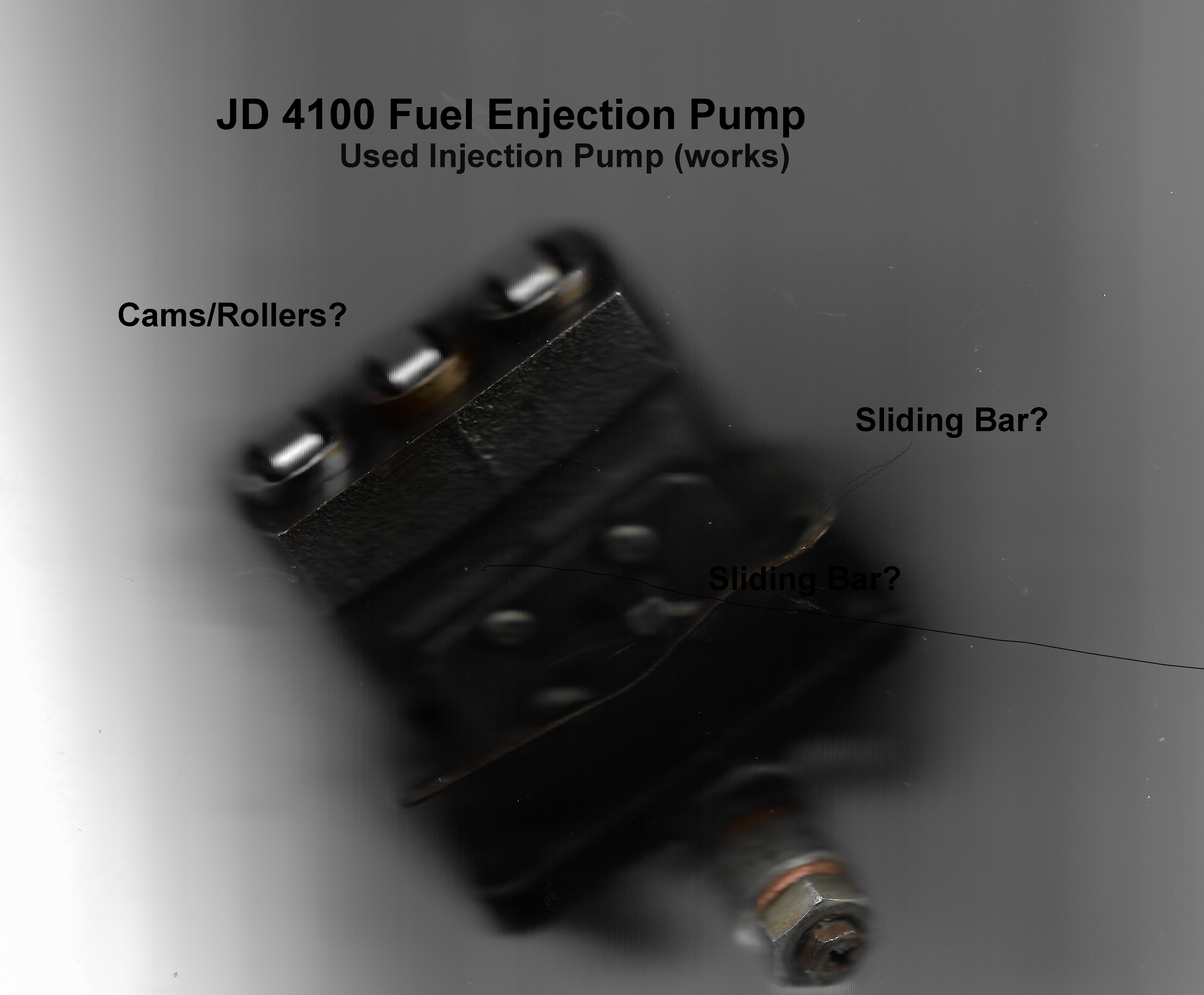

No now the solenoid is not clicking. can test it directly from the (+) side of the battery to the white connection leading to the solenoid without hurting the solenoid. I think I did this before and it withdrew the pen of the Solenoid.
By the way which wire is the high voltage and is the low? White or red?
I lost being a novice at this but try anything (frustrated). What is a rack and located I am hoping I don't have to replace the injector pump.... Hard? I see the cams, I see a sliding bar on the side, and the return fuel and 3 injector outlets. Is there picture Injection Pump.JPGJD4100 Fuel Injector Schematic.png

The "slide bar" IS the PUMP control rack.. IT links up to the ENGINES control rack..
The solenoid push's on the pump control rack in most cases..

On the sol.>>
Black is ground-
White is PULL+ {HI AMP}
Red is RUN{hold} + low amp
They run thru relays that switch from hi amp to low amp.. You'll hafta get a work shop manual to find out where & which..
