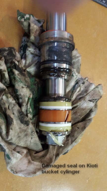

I very recently had a tractor bucket that wouldn't hold & having read that method here or some place thought it would be worth a try . The temp. was was only slightly warmer but the result was I took the right cylinder apart to fix. 20170621_123607.jpg

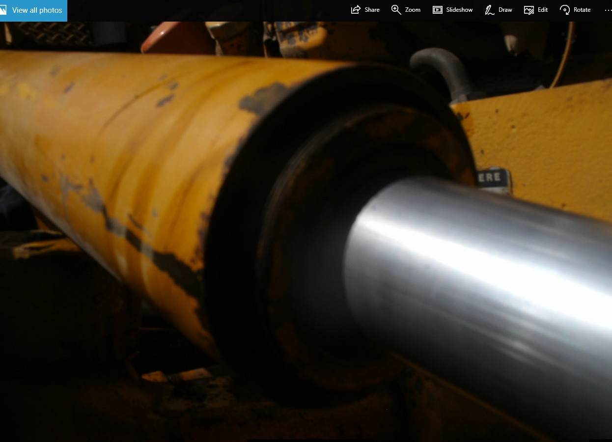

Finally I have time and trying to remove cylinder rod. But it seem to me very hard to remove the snip ring.
Did any member have experience to remove it and sharing the expert? will be appreciated.
