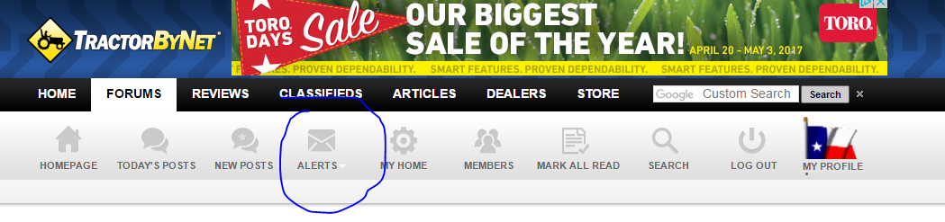

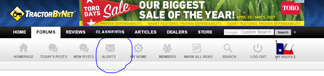

Click on your "name" or the senders name and the private message icon will show.
To view PM's one can also click on alerts outlined in blue.
