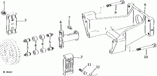

There are no plastic bushings on water pump but there are bushings on hyd pump coupler in parts photo that can wear out. Pump coupler must be removed to replace fan belt.
4 ea-R45822 Bushing - BUSHING ADD 2.43 USD 9.72 USD
