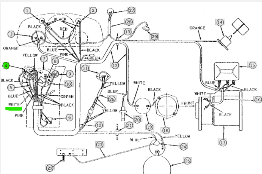

Where does white wire with inline fuze connected to silinoid connect to ignition switch
Sep 16, 2023 / JD 4010 ignition- where does white wire with inline fuse connected to selnoid connect on ignition switch #1 Huf New member Joined Sep 16, 2023 Messages 3 Tractor Early model jd 4010 Where does white wire with inline fuze connected to silinoid connect to ignition switch
Sep 16, 2023 / JD 4010 ignition- where does white wire with inline fuse connected to selnoid connect on ignition switch #2 B beenthere Super Star Member Joined Aug 16, 2001 Messages 18,099 Location Southern Wisconsin, USA Tractor JD_4x2_Gator, JD_4300, JD_425, JD_455 AWS, added JD_455, JD_110, JD_X485(sold) Welcome to TBN Do you have the service tech manual for the 4010?
Sep 17, 2023 / JD 4010 ignition- where does white wire with inline fuse connected to selnoid connect on ignition switch #3 Tx Jim New Member Joined Jan 26, 2007 Messages 10,027 Location Coyote Flats,Tx Tractor JD 4255/Kubota M7040 HDC I could only locate white wire that was attached to ign switch on gasoline powered model. I located white wire on both generator & voltage regulator on all 4010 models no matter of fuel type. Attachments Screenshot 2023-09-17 063421.png 222.7 KB · Views: 45
