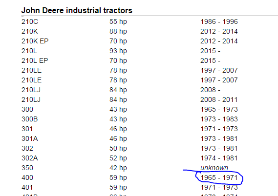

Hello,
I recently bought a 1969 JD 400 with a Diesel engine.
The engine oil is black as night. What oil should I use for an oil change?
The book says JD torq-gard. Above 32 F to use SAE 30. -10 to 32 F to use 10W20.
This isn't my first rodeo and I know oils have changed a bit in the last 45 yrs, so what would be the best oil to use?
While on the subject of oil, what should I use for hydraulic/transmission oil?

:welcome: to TBN
First 400's were built in '75. What is your serial number?
I'd go with the diesel engine oils from Deere, as well as the hydraulic fluids used today.
   / JD 400 oil #3
:welcome: to TBN
According to Tractordata.com JD ind 400's were built '65-'71. I'd recommend JD Torq-Gard +50, Shell Rotella T or Delo 400 15W-40 engine oil

Thanks Jim.
I was only finding the garden tractor JD 400. Didn't search for industrial...
   / JD 400 oil #5
400 lawn & garden tractor only came from factory with a gasoline engine.
