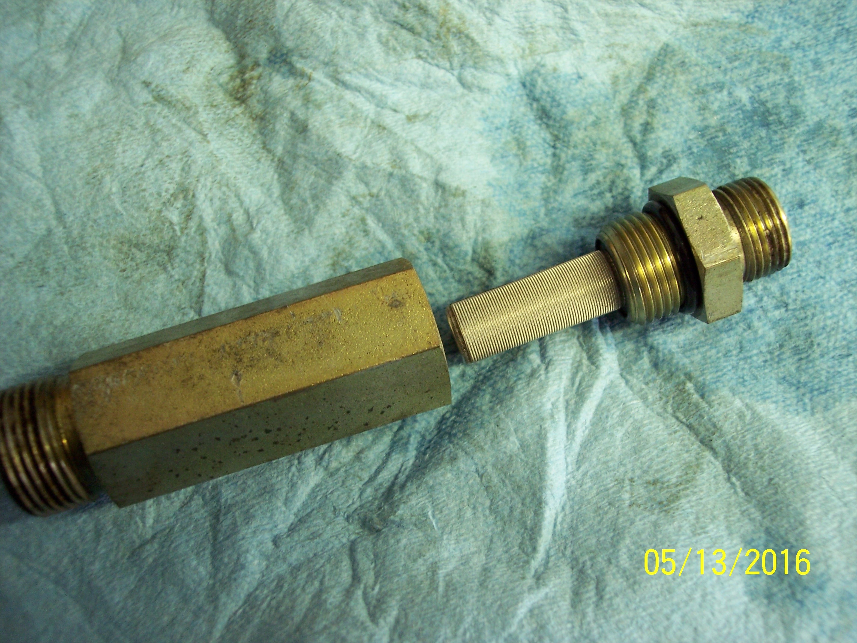

Yesterday while finishing up some mowing I noticed starting in both forward and reverse seemed to require more pedal than normal. At first I thought I had left the parking brake on as I occasionally do but that was not the case. Once the tractor starts moving operating speeds seem normal. Hydraulic fluid is at the full mark and looks clean and does not smell burnt. I am still 100-hours from the transmission fluid and filter service interval and 300 hours from replacing the inline hydraulic filter.
Any recommendations?
   / JD 3720 CUTS HST Sluggish #2
Might be time to service the filter and clean the screen.

What parts cleaning fluid do folks use for hydraulic components?
   / JD 3720 CUTS HST Sluggish #4
Gasoline is what I use. With care, of course. ;)
