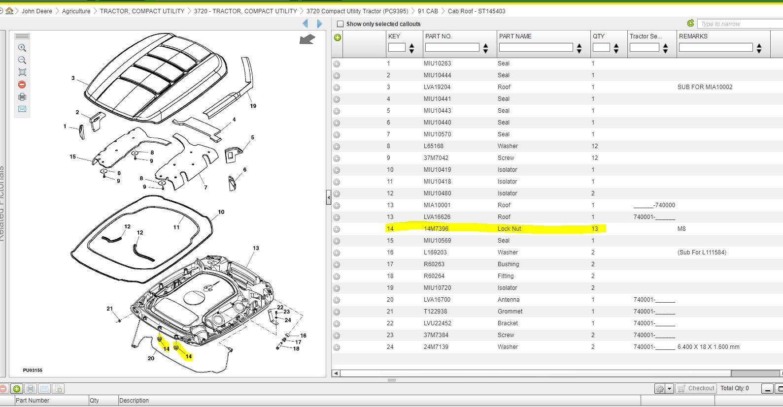

If someone could please tell me if you fixed the blower motor fan on a JD 3720 cab mod. The fan stopped running, I changed the 20A fuse and it opened again. The items on the fuse list are : Dome light (that I don't have), radio/blower switch/RH Blower ( I don't know what the RH stand for , right hand?) Where is the fan located? Thanks in advance.
/ JD 3720 cab fan troubleshooting #2
There are two fans in the roof, you have to remove it to get to them. There are 13 bolts to remove, then it just lifts off-help is recommended.
RH is right hand, so that is the one that need to be tested. If the LH fan fuse is good and it’s not running, then it’s possible the control is bad.
Thanks a lot, I guess I have to remove the head liner of the cab to get to the screws to the roof. Do you know about removing the head liner any tricks for that? I'll try the control switch first , I guess the panel just pulls out with all the controls or is there a trick for removing that. The LH fuse is good so ill start there first cause I cant remove the roof until the weather warms up, machine is outside and ill have to put it under a temporary shelter. Thanks again.
/ JD 3720 cab fan troubleshooting #4
You need to remove the roof, not the headliner. Look around the underside edge of the roof, you’ll see the 13 bolts (actually they are just nuts now that I think about it) to remove.

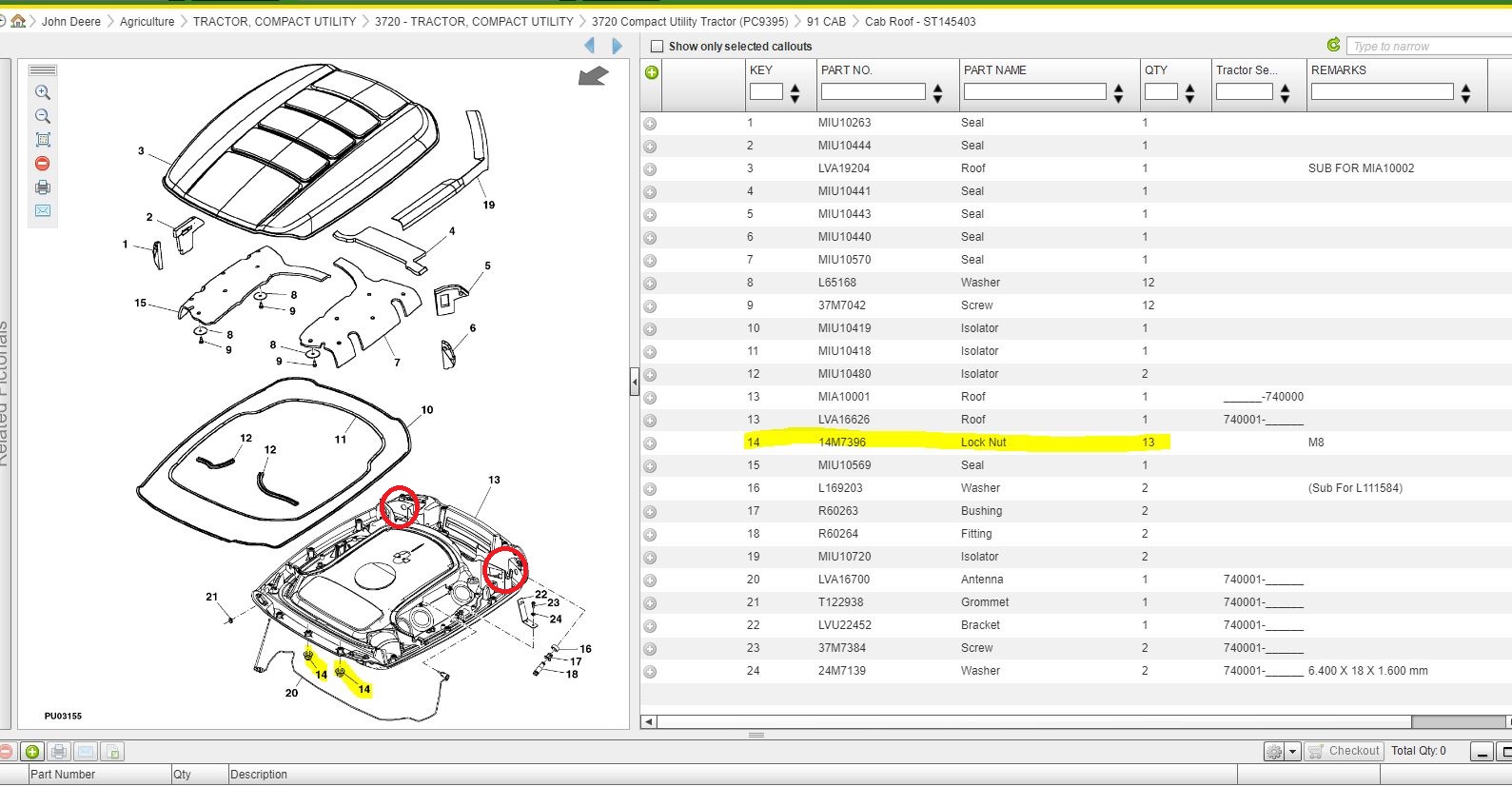

/ JD 3720 cab fan troubleshooting #5
Here is a drawing, I was mobile earlier and couldn't get it for you. If you search for some of the radio install threads you probably find more info and pictures.
The red circles are where the fans live.
Thanks a lot Kennyd for the print and your help. The LH fuse is good and fan is not running. I do have a dome light. I hope I can get to this job soon. Im going to pull the control switch first and start there along with the dome light. Thanks again.
