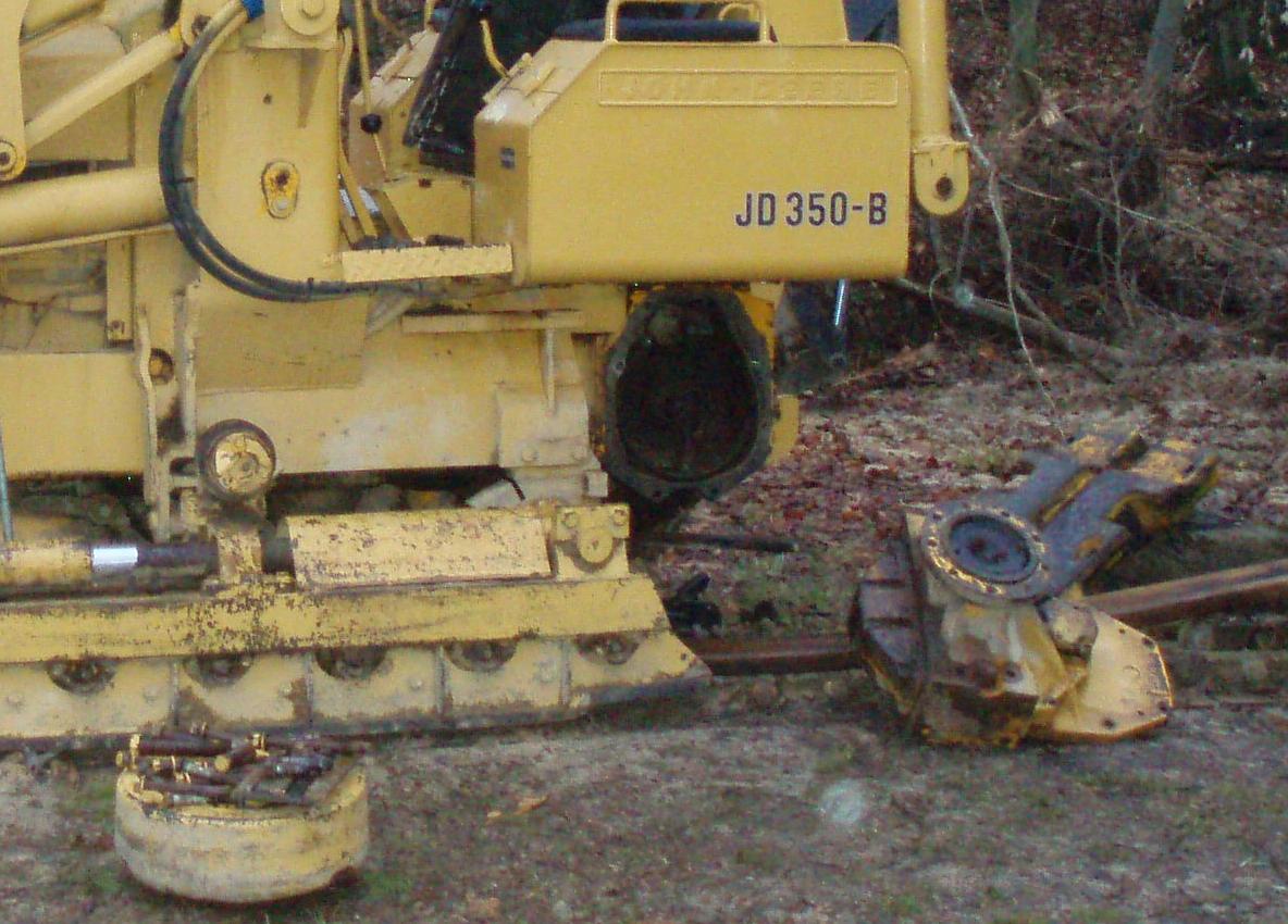

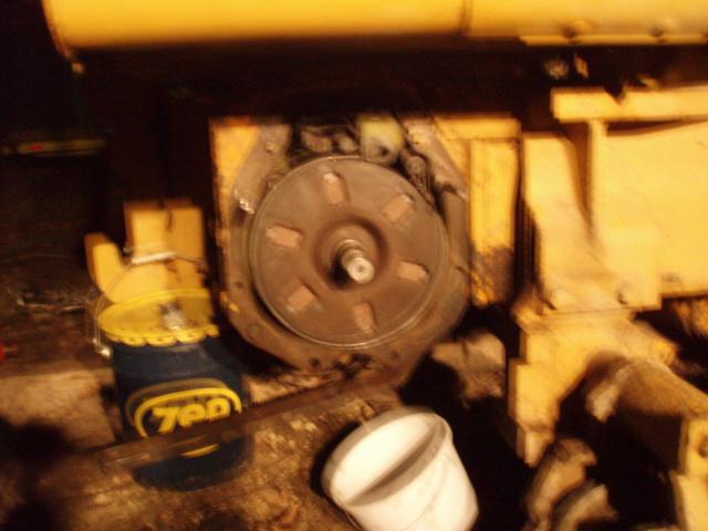

And even found some disassembly pics. Left side torn down, right side with newly rebuilt clutch pack and brake band installed.
In the foreground of left side pic is the rear final counterweight (250-300? lbs.) and the belly counterweight (~500 lbs.) is behind and just right of rear final drive.

Wow how clean, did you have it steamed before tearing it down, usally i had a oilly mess in the mud, or a shop so dark you can,t see
   / JD 350Bw Dozer - advise needed please #8
pressure washer on the outside and decent weather. About 3 gallons of Zep to cleanup the clutch housings. It's a personal use machine so I didn't have to work in the muck to get done in a hurry.
