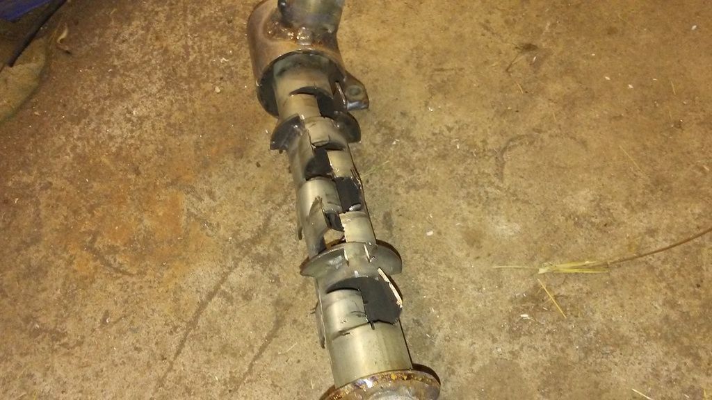

Got the muffler opened up today...

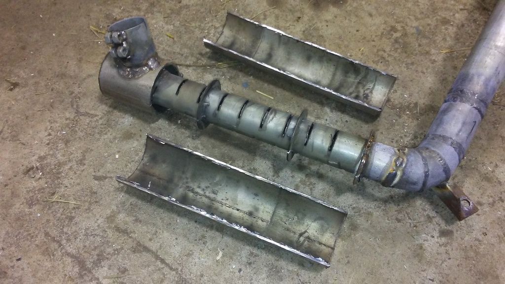

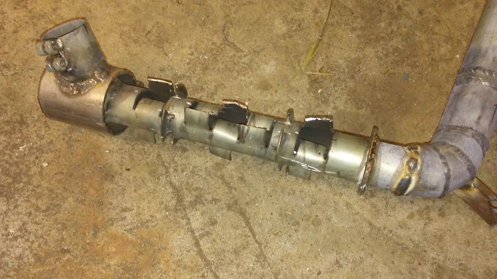

Frustration is setting in... 5 minutes here, 10 minutes there, mostly as Im in the barn doing the evening feeding chores. But... Better than nothing.
Chopped up the inner pipe inside the muffler. Not pretty but it HAS to change the sound somewhat. Whatever it is, it is.
I think I will tack the shell back on, put it all back on and 'sound check' it, then remove to finish welding and painting. I will cover the unwelded seams with foil tape for test purposes.

From homemade mufflers I have seen, they have partial plates inside the muffler that baffle and "restrict" the flow and force it back and forth from side to side. A good example was in one of the muffler sites I saw a couple of years ago. Flowmaster I think. That's just what I remember.
   / JD 3005 exhaust mods/replacement #104
I've been following this thread, I need a quieter muffler on my 1020 with bottom exhaust. It needs to be round to fit under the left side platform. JD price is $267.21. I can burn a bunch of MIG wire for that price. Here's what I found by a quick google search of "what does a muffler look like inside". Lots of pictures=lots of ideas. Great fab work, dieselcrawler. :thumbsup:

Thanks for the compliments and for tagging along...
I gave up on a 'test listen' and after tacking the shell in place, welded in all the seams. I plan to smooth up some of the welds, and paint every thing, hopefully this weekend if I can... Want it done.
