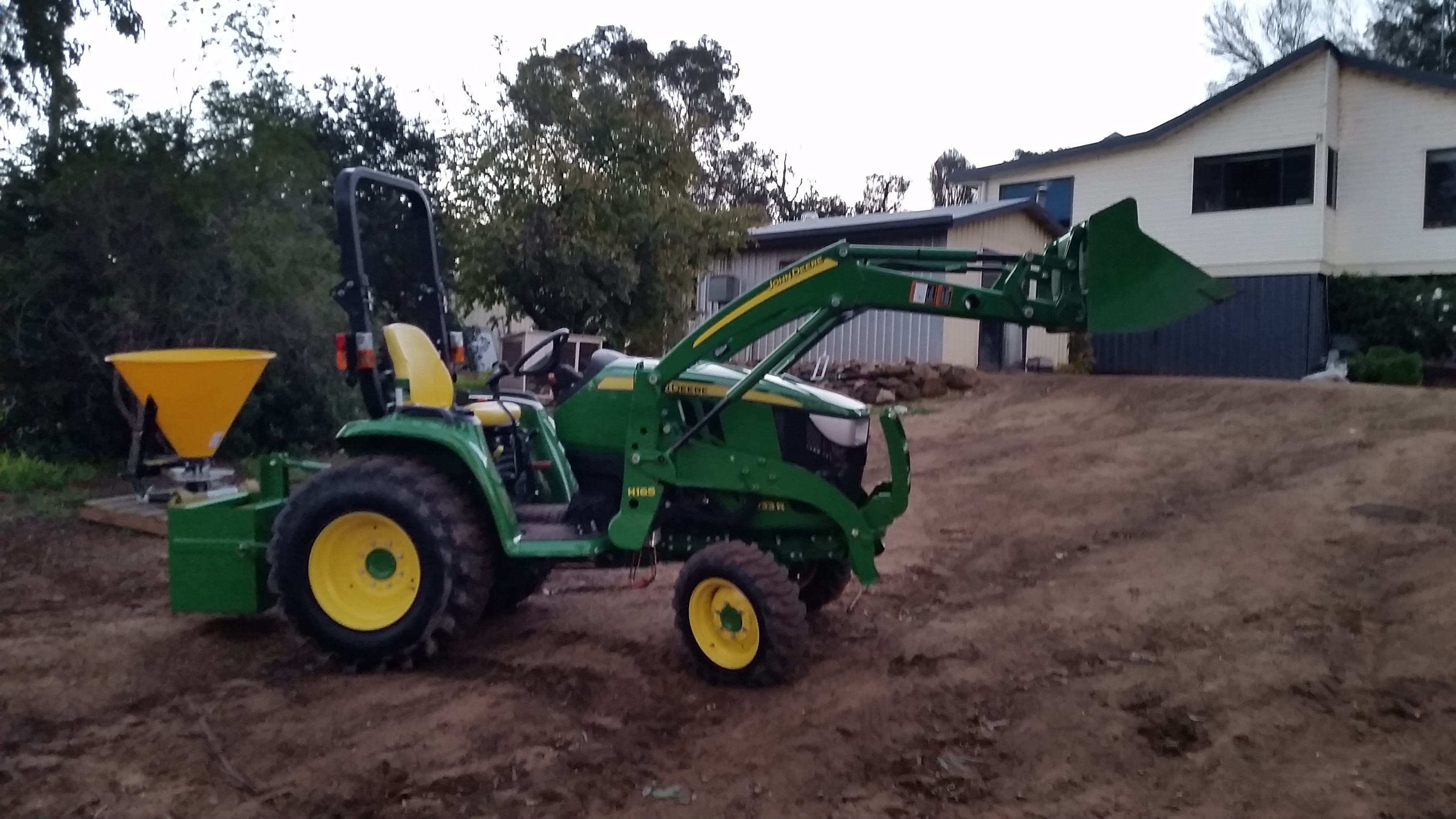

/ JD 3 series E vs R #13
25hrs so far doing everything asked of it. Thinking i need to fill the rear tyres though
