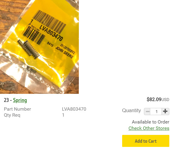

Wait a minute... JD Parts is showing $2.21 for the original spring and $82.09 for the new two springs? Is that correct?
   / JD 2720 pops out of 4 wd
#22
No, it’s an upgraded double spring for $2.21
The other one I called my dealer and he couldn’t find any information on it but I’m thinking it’s for the whole shaft. $82.09
   / JD 2720 pops out of 4 wd #23
No, it痴 an upgraded double spring for $2.21
The other one I called my dealer and he couldn稚 find any information on it but I知 thinking it痴 for the whole shaft. $82.09
I'm glad to hear you didn't have to pay that much. I looked up the part number shown on your plastic bag (LVA803470) on JD Parts and two on-line parts retailers and they all show it as a "spring" for $82.09.

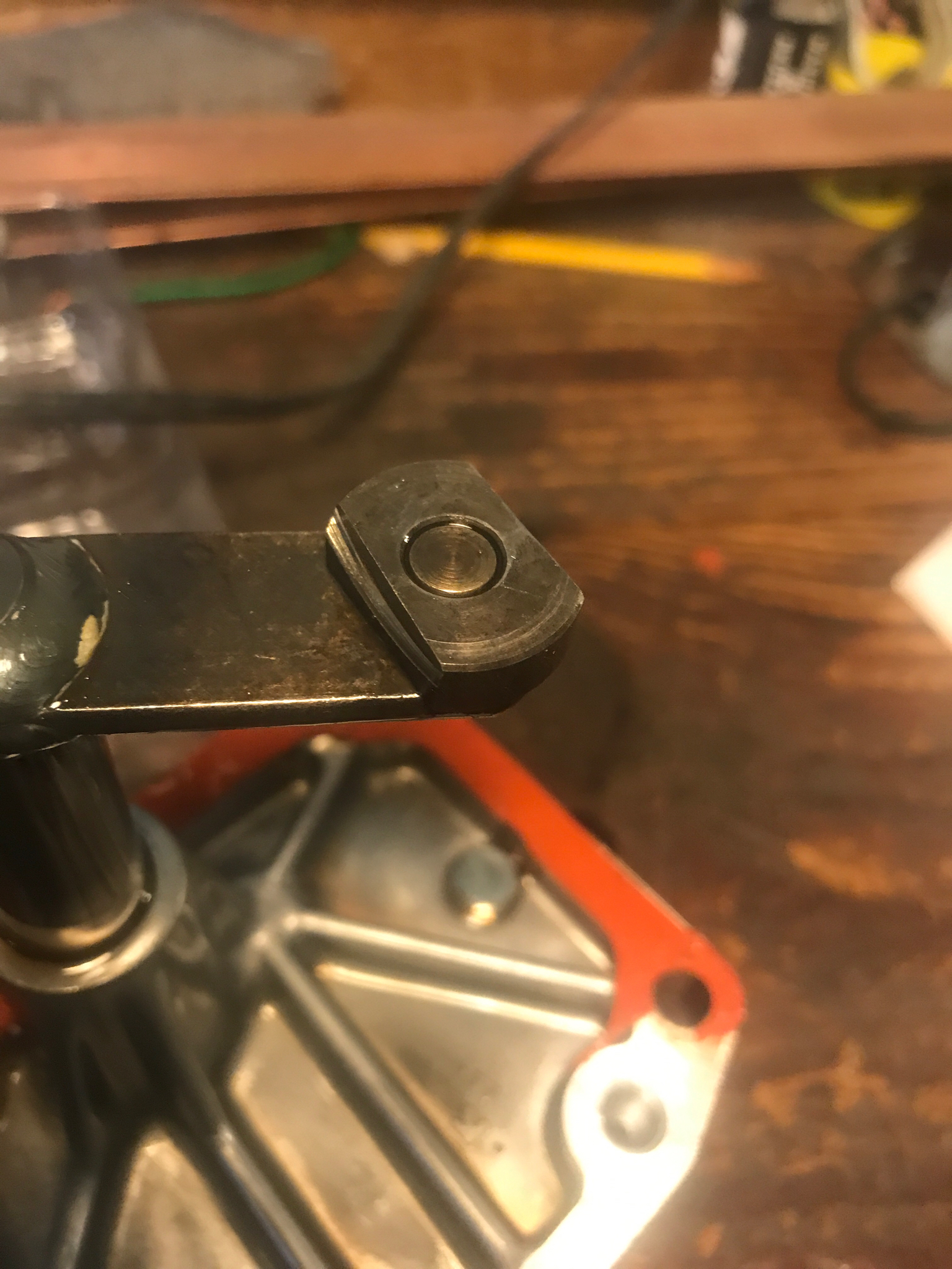

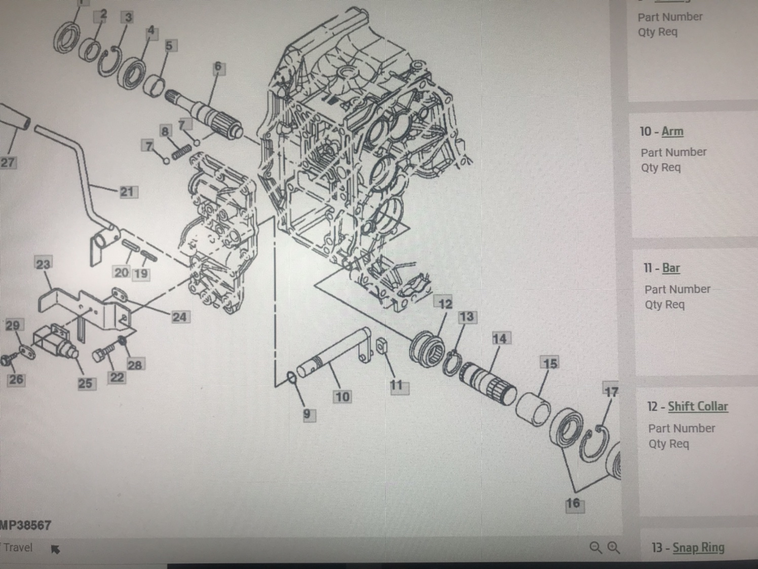

I have it mostly together but needed a few more O rings and copper washers but mostly part number 11 called a bar which is worn on one side. I could probably flip it over but I ordered a new one.
   / JD 2720 pops out of 4 wd #26
Yeah, looks like a good idea replacing #11. Did #12 show any wear? That appears to be the collar that #11 rides against.
#27
I couldn’t find any wear on it, number 11 must be softer material.

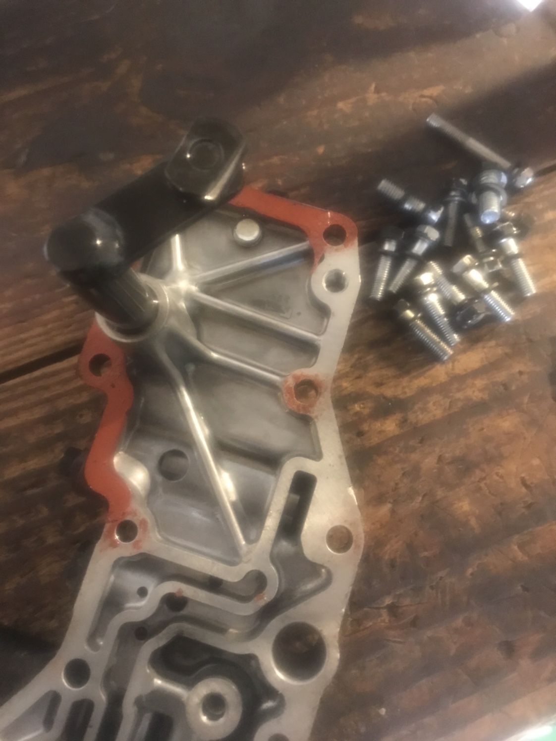

#28
This is where the grease gets into the tunnel when you grease both sides of the linkage where the shafts go through
