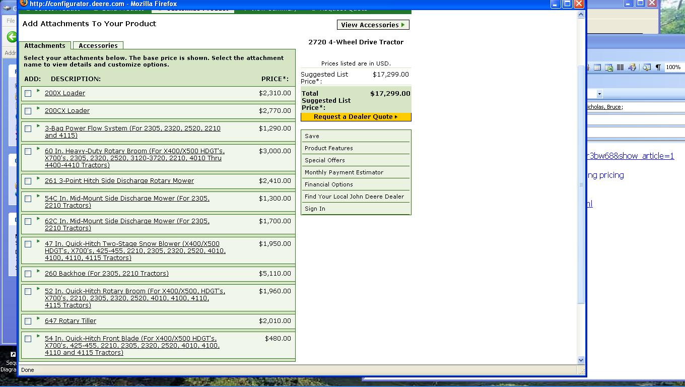

Try the configurator now. I just did it on the dealer side and we use the same version that you guys do. It should work.
   / JD 2720 now available #7
Doesn't look like it is there yet for civilians... :D

   / JD 2720 now available #10
Try this, a little adjusting to the link for the 2520 configurator;)
Right click on the 2520 "build your own" and copy the link. Paste it into the address bar, replace the 5 with a 7 in 2520 and hit enter.
