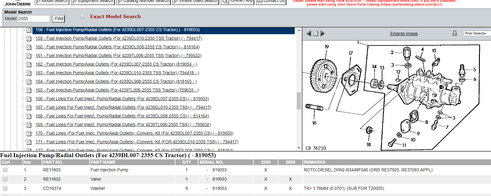

It's possible the check valve in inj pump that fuel return line attaches to is blocking flow of excess fuel returning to tank.

According to my parts catalog research it appears an '88 2355 would have a Roto-diesel inj pump with a check valve(key 2). Will a clogged check valve on Roto-diesel pump affect engine operation the same as with a Roosa-master/Stanadyne pump?
Thanks,Jim

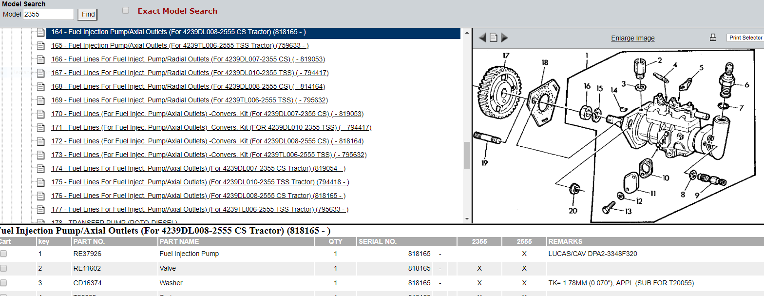

I just noticed JD parts shows a return line check valve on a 2555 Cav IP

I see that.. no it wont slow it down, it'll blow the front seals out..
If u really want to check to make sure, take the RETURN line off & unscrew the return FITTING.. & start & run the motor..
Its gonna be messy..
