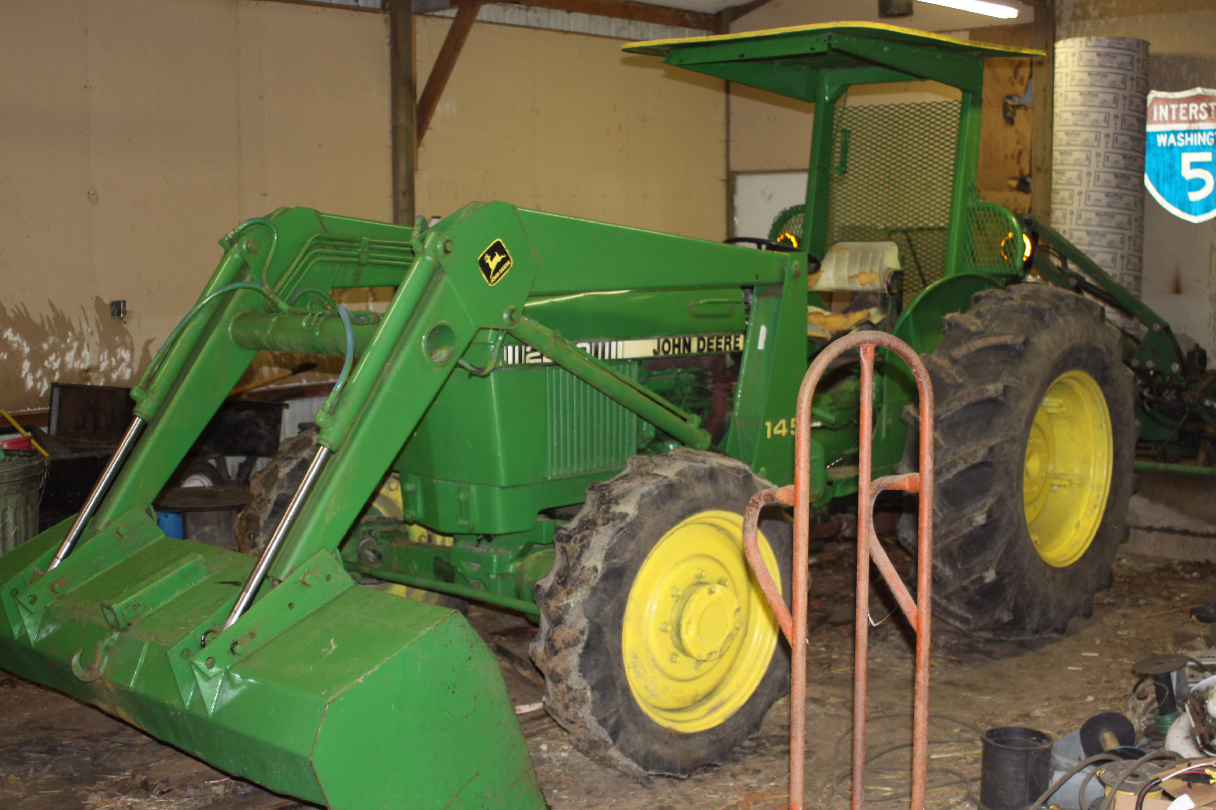

Nice looking tractor. Looks like its had a nice home indoors. Mine lived outdoors before I got it and is pretty faded. Is that a Hi/Lo or a Reverser?

Seats don't cost much, I have put a couple on mine... My tractor has the reverser, but only 2 wheel drive. I really like the reverser. But my next tractor will either be a HST or CVT, if I keep blowing snow...
