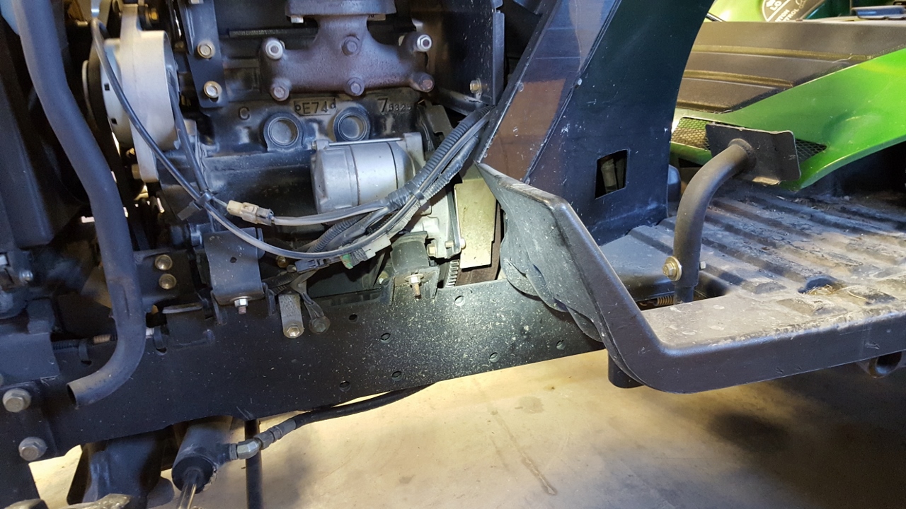

Totally engine compression.
Remove the left side engine panel. This gives you access to the flywheel. It's toothed so the started can turn the engine. With a large flat blade screwdriver use the teeth to pry against the frame rail turning the engine. Repeat until the shaft is in the position you desire. Hopefully this picture makes sense. The toothed flywheel can be seen in the center of the light.
Understand, the shaft is solidly fastened to the engine. All the gear selection, 4wd/2wd, whatever else you try is within the transaxle. Nothing you do there released the driveshaft from the engine. This machine does not have a clutch at the engine crankshaft end.

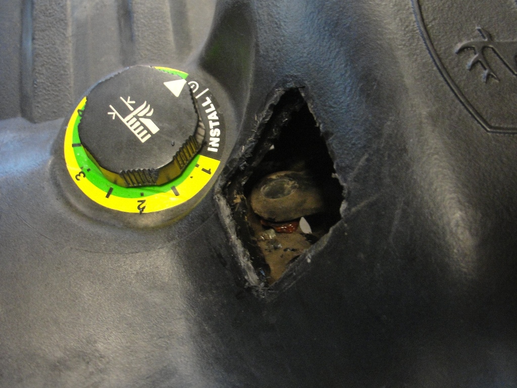

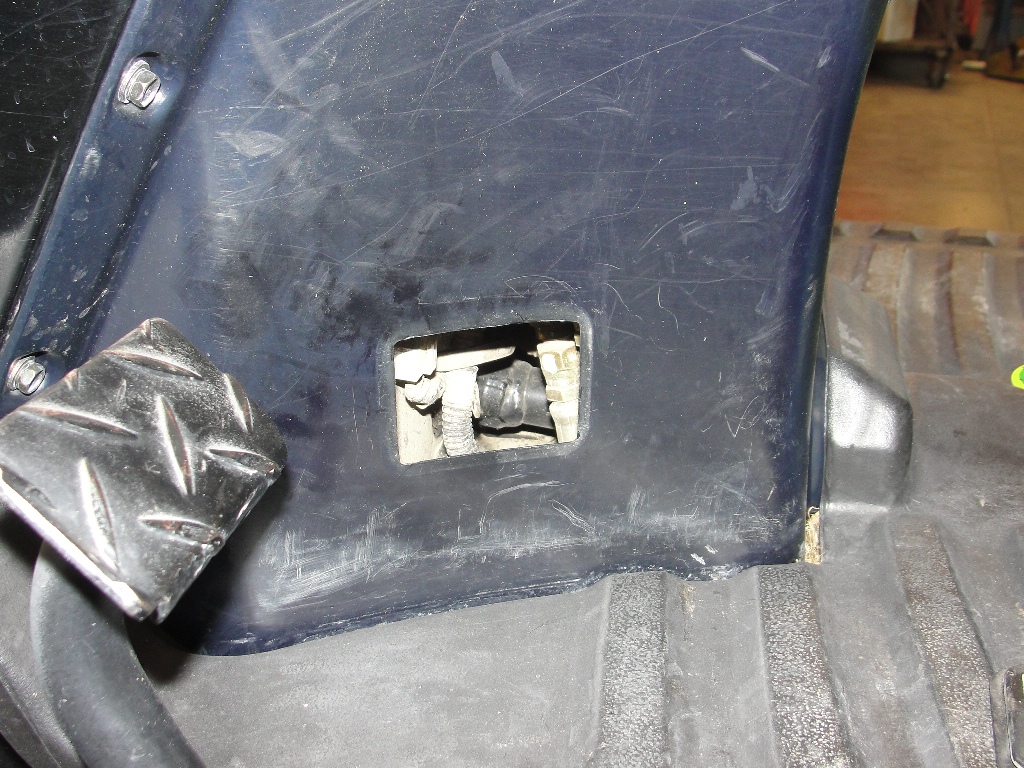

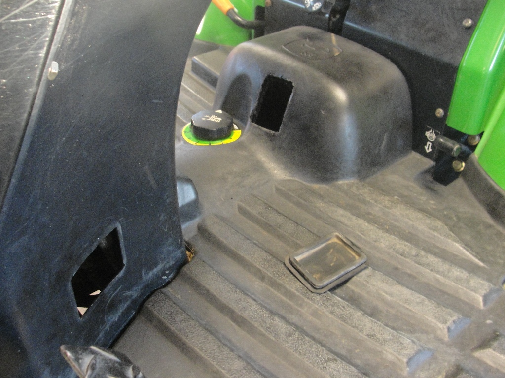

Additionally, you need to create a method to grease these joints. It's a bitc*. I cut a square hole in my floorpan to access the rear one from the top. I cut a hole in the right side of my dash tower to access the front one. Not saying my method is best. Just saying, while you are doing this repair develop a method of greasing the joints. I lube mine every 25-30 hours.
Here's also a thread about this task with some very good pointers.
http://www.tractorbynet.com/forums/...pper-driveshaft-service-grease.html?highlight=

Good thread. Think I need to cut those holes for access to the front U joint on my 2025R.
The front U joint disentegrated on the JD 4010, like the 2025R but with 6 more hp and a few goodies, and somewhat similar to the 2210. Took 660 hours and 9 years. So, at around 110 hours and less than 2 years, I need to do something.
