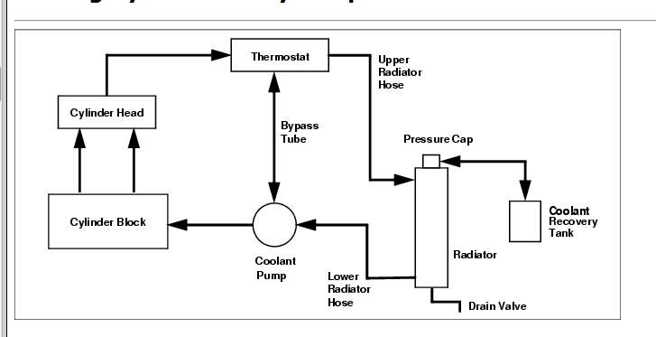

I recently finished building a cab for my 2210 and am in the process of making my own heater using a chevette heater core and a 130cfm dc muffin fan. Myy question is how or where do i tap into coolant lines? I see where curtis cabs uses a sending unit adaptor but since I didn't ordder their heater I don't have this special adaptor. Is there anywhere else I can tap into using a standard tee?
   / JD 2210 Heater Hose Connections #2
I found some information on the 2210 cooling system. Ideally, you would tap in near the rear of the head , route the coolant through your heater core and return it to the thermostat housing. Installing your heater core in-line on the bypass tube may be easier.
