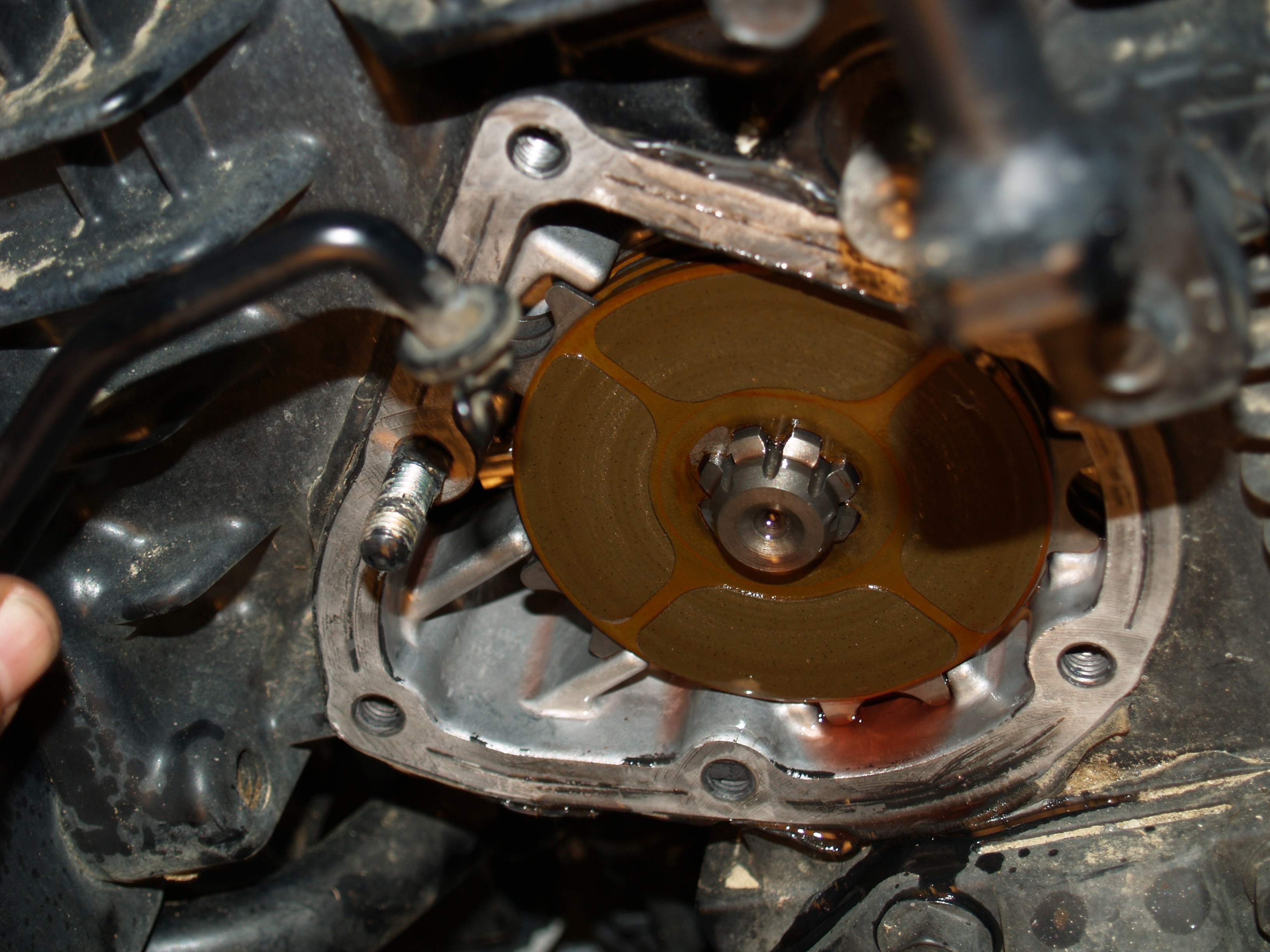

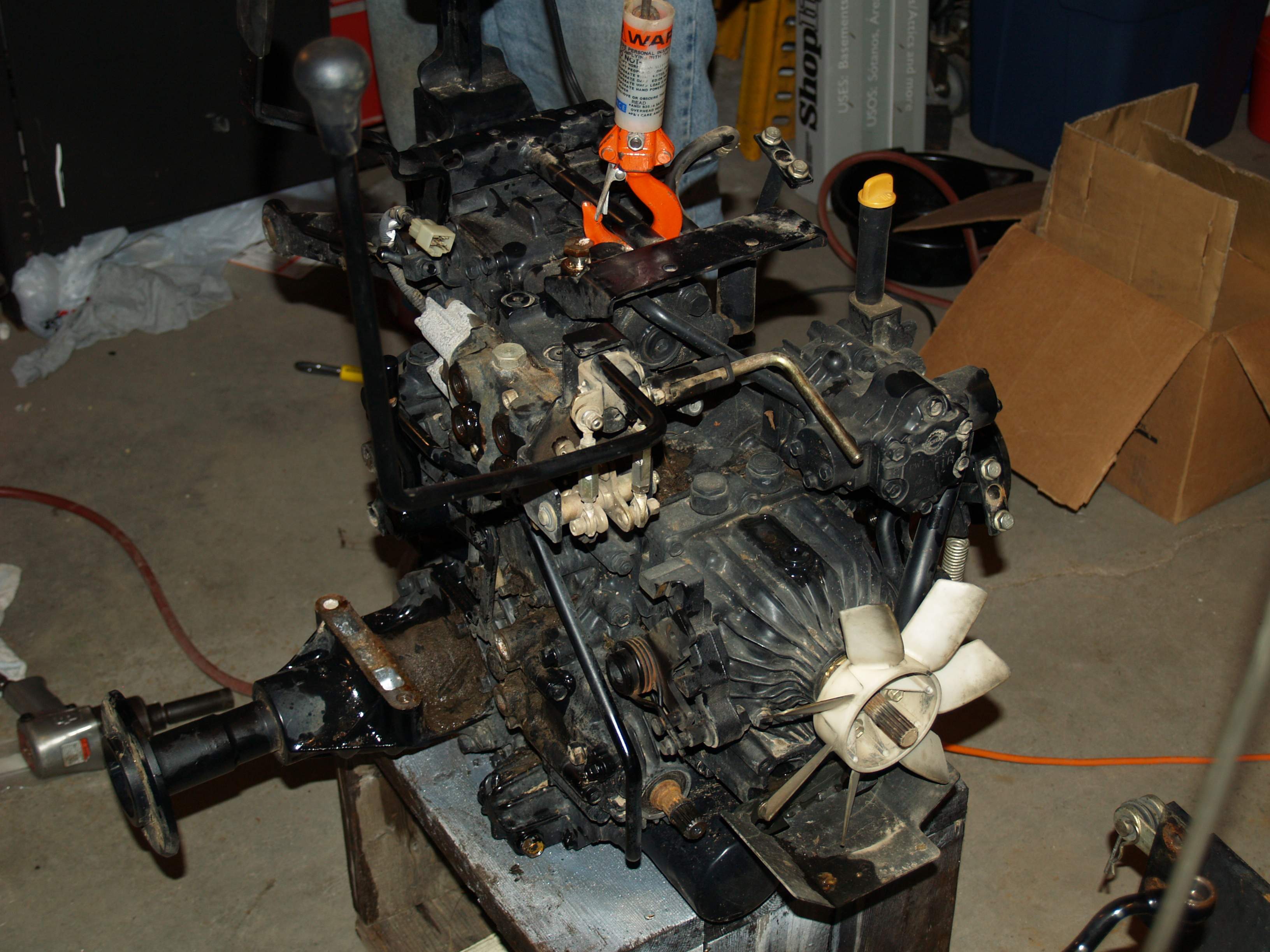

I pulled the transaxle out of the tractor. So far 3.25 hrs to pull it and get to the brakes. Check out the pictures I posted. The friction plates are clearly burnt and the steel stationary plates show signs of over heating. This really is a wimpy brake. So far not that big of a job. I will order the brake pack from the dealer tomorrow. The JD service manual is awesome! Very good step by step pull down instructions with pictures. Ill post more pictures of the new parts and the install job. If you want to know what the tranny looks like in your 2210 here is a picture of it hanging from a chain fall.

/ JD 2210 BRAKE FAILURE #13
Bicardi:
NICE pictures. :)
I hope the replacement and reassembly goes as well as the disassembly did.
/ JD 2210 BRAKE FAILURE #14
Wow, 3.25 hours for this teardown seems real fast to me, good job. Thanks for the pics and the tec manual review. Please keep the pics coming. Mark

Brake job complete !
I reassembled the tractor last night. It took 5.5 hrs bringing a total job time to 8.75 hrs start to finish. This includes time to read the service manual every step of the way and do some searching for torque spec's during re assembly.
Final analysis found that the brake discs when measured in a stack were under spec by .050. Only 1 friction disc was undersized.. All but one disc was the same thickness as the new pads. All friction discs were glazed. This is a very poor design. The tolerances are very tight leaving virtually no headroom for wear. This is not a stopping brake it is a a parking brake.
Attempt this job only if you have a well equipped shop with a chain fall and all the proper tools. A novice mechanic can get in over your head. The transaxle is all aluminum and you can easily strip a bolt and be in for more than you bargained for. I used an assembly lube on all fasteners during the re-assembly and had no problems. The JD service manual is awesome it lists torque values for dry and lubed fasteners.
