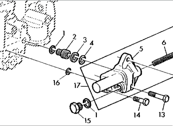

My knowledge of JD closed-center hyds such as your 2155 posesses is broad but my knowledge of backhoes is limited. Who manufactured your BH? Can you post photos of these hose locations? Pressure hose should be attached just behind pressure control valve(key 15) on RH side by hyd filter and return hyd hose should go to ported hyd filter cover. While hyd oil level is low would be a good time to check trans sump screen which requires draining oil.

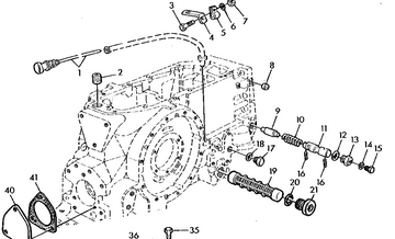

Thank to all for the reply's. My tractor has 2 T's on the pump. 1 line from each T goes to a box on the side of the tractor and sends and returns fluid to and from the loader. The other 2 hoses(1 supply and 1 return)goes back to the rear of the tractor with 2 quick connect fittings. I have installed these 4 new hoses except for putting on the quick connect fittings for the backhoe(under the crank for the 3pt. hitch). I wasn't sure whether to put the male or female fitting on the supply. Is there any protocol for quick connects? Like the male is the pressure side or the female is the pressure side, or can I tell by following the quick connects on the backhoe where they go. Also all the fluid pretty much leaked out.I have 10 new gallons to put back in, is there any other things I should do before installing the new fluid, Tx Jim can you give me a pic or diagram of the trans sump screen, I would like to do this as most of the fluid is drained. I can work on cars and trucks not too up on this tractor. It is a 1990 2155 has a JD #10 backhoe and a JD 146 loader.

AFIK male or female hyd coupler location/orientation is immaterial as oil can flow either direction through them. Screen is obviously key 19

Thanks for your help, I found transmission screen and took it out and cleaned it. Replaced the fluid and cranked it up. All is well now, thanks for the diagram and assistance. david
