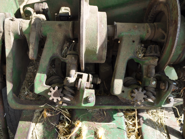

In your pictures of the tucker fingers, top left picture. The tucker travels over and goes under a small plate that has a tit pointing toward the back of the baler. Does the right side have that same piece for the tucker to go under? These are crucial pieces to tying properly.
If the adjustment you made on the tucker was with the threaded rod attached to the tucker itself, that would explain why it stopped tying. It was not taking the twine back over into the bill hook. Is the tucker on a plate that the entire plate can be moved forward and back for adjustment? Look again at the 336 picture under "tucker fingers" and you will see what I mean. If the baler was in front of me, I could tell, but it has been so long since I had my 14t, I do not remember if it had that adjustment.

i slid the whole tucker bracket to just miss the needle when the needle was 1/2 inch above the twine disc(per book) and then with in home position adjusted the threaded rod part till it was flush to 3/8 i think the book said...
/ jd 214t baler #43
I am not quite following what you are saying and doing. What has all ways worked for me, I start the tying cycle. Bring the needles up until the tuckers start to move. Then I go a little further till the tucker starts to come across the needle to pick up the twine. I guess the needle is a little past the twine disc, but never payed that much attention. I was more concerned with the relation between the tucker and the distance it clears the needle by. You usually want this pretty close as it passes across the needle to get the twine. Too much distance here and you can miss the twine and not get it back to the bill hook. Does this make sense? Are we on the same page now?

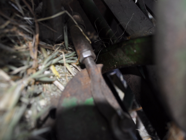

here in ramona we are done (probably) with rain till oh around october. i think i might have found why the tucker fingers were not adjusting to look like the book... the shaft that pushes the was twisted i un twisted it and adjusted them and now they travel further and snap back into place. hand fed 3 bales worth into it and along with the new knife and wiper adjusted tied and dropped every knot so far. tomorrow im going to try and bale about 1/4 acre to try it out. hope i dont have to walk behind anymore and hand tie....

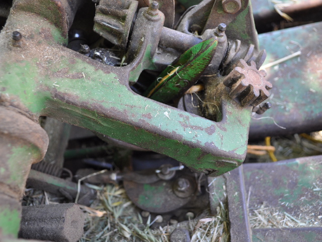

On that right knotter does it have the metal guide over top of the tucker? This guide also makes sure the twine stays in to get on the bill hook. Your pictures showed this piece on the left knotter, but I could not tell for the right knotter.

yes it has it on both sides

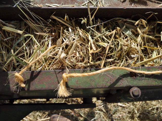

well great news i put 170 poly twine bent the tucker finger arm so they are even against the back stop then adjusted the tucker fingers to where they are supposed to be. today i baled 168 bales and did'n't miss one tie. thank you barry and everyone else for all the help and support.......

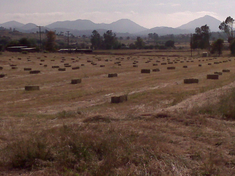

here are some pics. even got my daughter baling

good job! nice to have guys like barry to help you when you need it. now the fun begins, picking up bales.

yah picking them up and stacking was great fun. ok i lie. i threw them on the trailer the wife stacked them until it got too high for her then i did both. and since my 10 and 12 y/o daughters can drive(from the dunebuggy out in the desert) i let the 10 y/o tow us and 12 was navigator oh yah the 8 y/o boy was the stop start alert had his head out the window listening for my commands. i guess it helped that the 10 y/o is 5'3 all i has to dois put the seat forward
