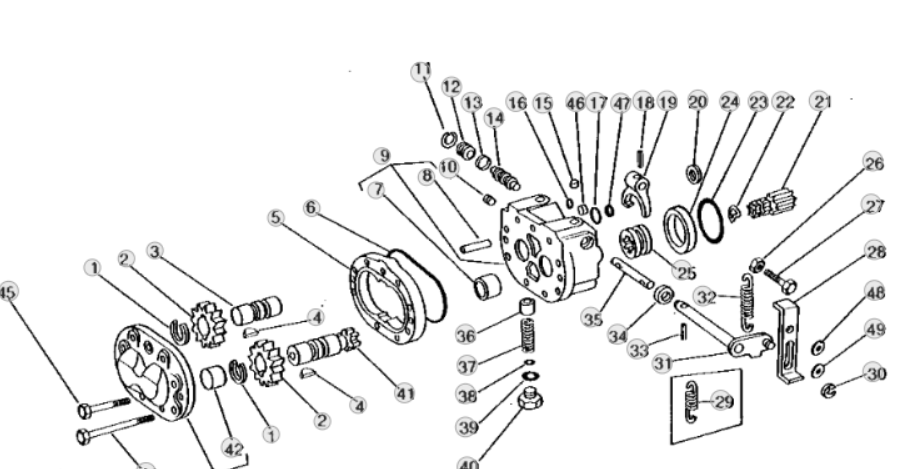

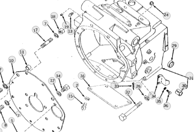

I know it was a huge mistake to buy one, but I didn't know that at the time so here I am.
There is a plate in front of the drain plug for the transmission its at a angle held on with 4 bolts and approx. 8x8 inches.
I couldn't even find it in my repair manual. To me it looks like its there so I can adjust something inside
and put it back on. Anyway its leaking into that compartment, could I possibly notice something with the engine
running and a flashlight. I am just asking for some pointers for where to start besides using dynamite. That's
for any helpful info.

Are you referring to plate(key 16)? If so IIRC that is a access plate to R&R hyd pump. The oil leak is probably associated with hyd pump.

Yes I was, thanks for the picture. If its the pump how would I remove it? I'm sure it looks like Hydl. fluid, its pretty clear, the oil level
hasn't went down in the engine and we had to add 2 gal. to the trans. Thanks for the quick replies.
   / JD 2010 Transmission Leak? #5
IIRC one just removes the longest bolts to get pump out of the opening so leaking seal &/or o-rings can be replaced.
