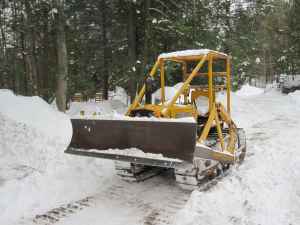

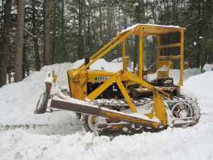

I am thinking about getting a small crawler to keep my woods roads open in the winter. I found a jd 2010 with a blade that is running and in my price range and am wondering what kind of work I can expect out of it. Any other advise would be appreciated as I don't know much about crawlers. The asking price is $5K. Thanks for opinions and comments.

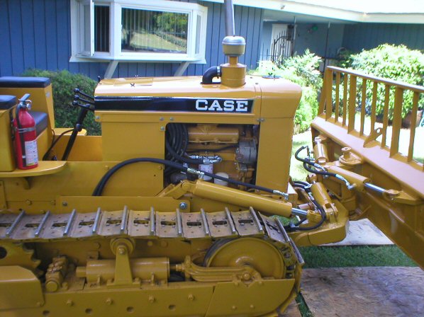

Gordon, price sounds ok. Does the blade angle at all? What about tilting? Normally when working with this size of dozer and the stuff that you are trying to do with it, it is really nice to have a 6 way blade. But the price is right and if you find that you want-need a 6 way blade, you could always sell this one and get one with a 6 way blade.
A lot of work can be done with these little dozers, I think that a lot of people feel that they are about worthless. They are not, I don't know what I would do without mine.

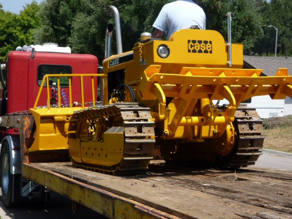

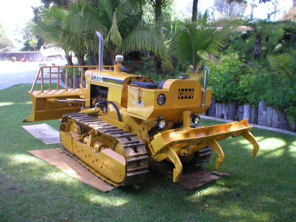

Here are a few pics of mine after I halfway restored it. It is a 1962 CASE 310.

It has a manual angle and tilt blade. I guess one of my biggest concerns is parts availabilty and traction or pushing capability. Snow is my first priority but I would like to be able to do a little dirt work too. I just dont have a feel.
It weighs 10000 lbs and is 42 hp.
Yours looks pretty nice.

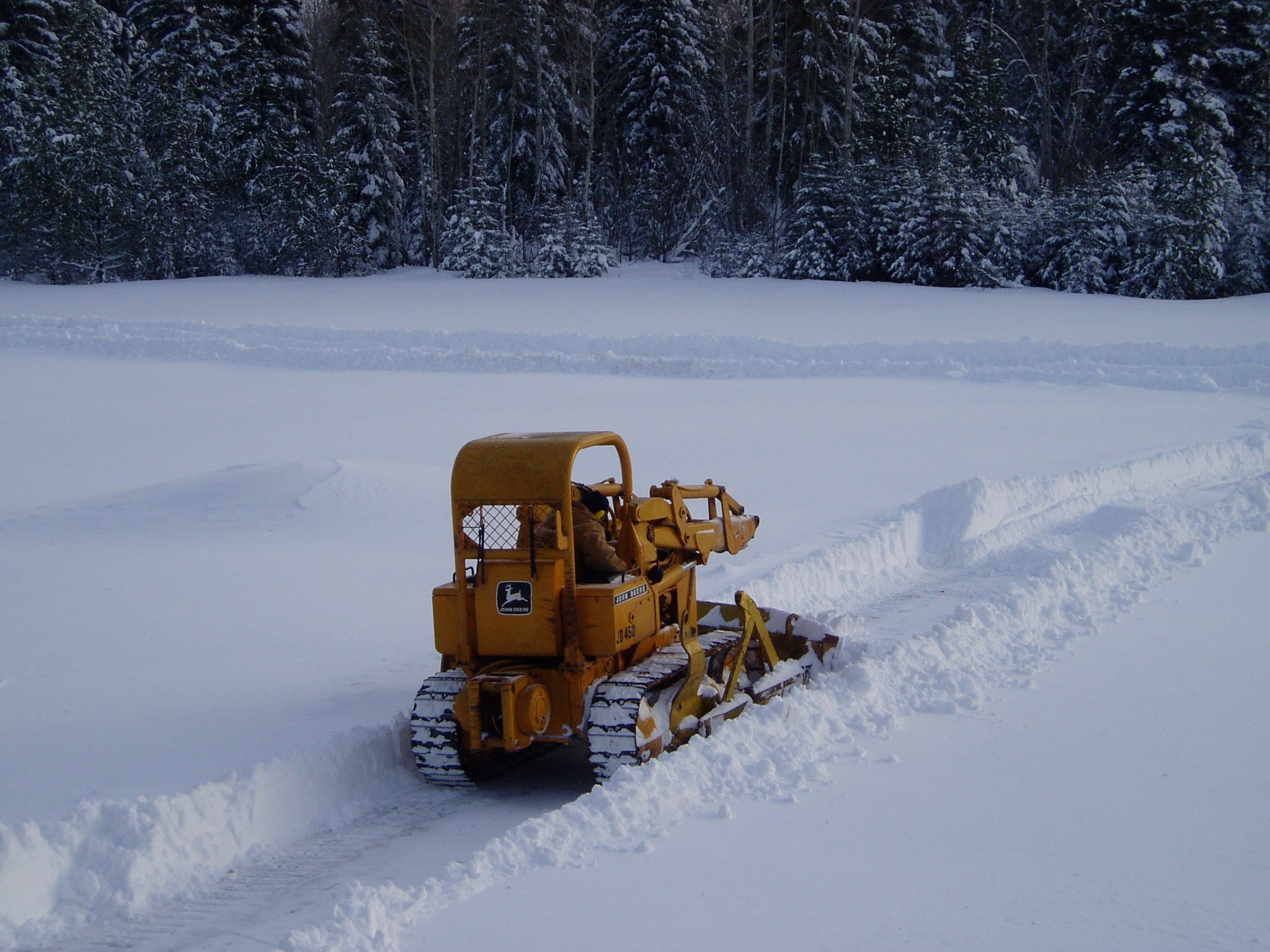

Have attached a copy of my JD450 at work with a dozer blade at the front on an outside frame.
Check out the Undercarriage link too - they get pretty spendy on parts as well !

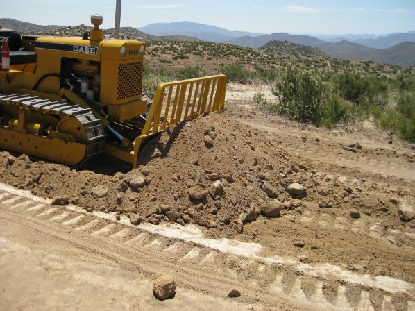

The weight & HP is about what mine is. My blade is 90" wide and will push an over flowing load no problem. Not sure actual volume, well over one CY though. I think that you would be happy with the amount of work that it can do. Don't know how steep any of your trails are, but these things stick to the ground like glue. Absolutely no comparison to a wheel tractor. I would say on a hill sideways 2 1/2 to 3 times as steep as a wheel tractor. I'm sure that I've had mine at 40 degrees, only bothersome thing is that I slide sideways on the seat, tractor handles fine. Can't push as much dirt on a hill though. But as with any machine, you get a feel for what it can and can't do. Unfortunately I have never operated my dozer in the snow, so I can't help you out with how it may handle in those circumstances. My guess is that snow would be no problem and a little ice as long as the tracks can break through it would be no problem, but if the ice is thick you might want to be ready for a wild ride.
Thanks for the compliment, I've had it for 15 years next month, has about 9,000 hours on it. Finished the partial restoration June of 07.
I think that as long as the tractor is not totally warn out, that you would be happy with it. Keep in mind that this size dozer is not horribly expensive to make repairs to as long as you do them yourself.

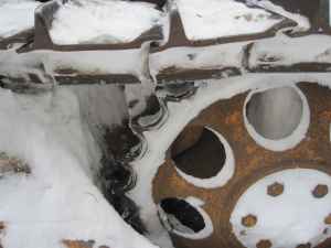

I have just gone back and looked at the photographs - the third one is of interest.
The drive sprocket for the steel track (3rd photo) should not have the pointed teeth - that is what I was told. They get pointed when the are very worn - indicating also, that the track chain (what the track plates bolt onto with 4 bolts) will also have similar corresponding wear or worse. If what I think is accurate, the tracks and drive sprocket are possibly 60% worn or more. The track plates don't look too bad in the photo. However the drive sprocket and track chain could set you back maybe $3,000 or more to replace both side - that is just for the parts !!!:mad::mad::confused2::confused2:
What is the rest of the machine like ? What about the engine - did you check lube oil condition ? Has it been started cold ?
These engines have (diesels anyway) wet cylinder liners that are replaced due to wear. On my engine I had leaking liner seals and what looked to be liner cavitation - when I pulled the engine apart. It cost me around $4,000 to rebuild using mostly John Deere parts - could have done it for $2,000 if I had gone aftermarket on parts. I did the labour so the total cost to me was around $4,000 plus my time.
My machine cost me $7,000 which I thought could be ok - but needed a lot of work. As it turned out my JD450 was not such a good deal as I have to do something about the undercarriage (tracks and running gear) as my drive sprocket is like the one in your photo and the track chain is well worn. Also the top rollers need replacing on my machine too.
The point of all this is the one you are looking at may not be that good of a deal at $5,000. It depends on what you are willing to put up with and how much money you have to spend.
