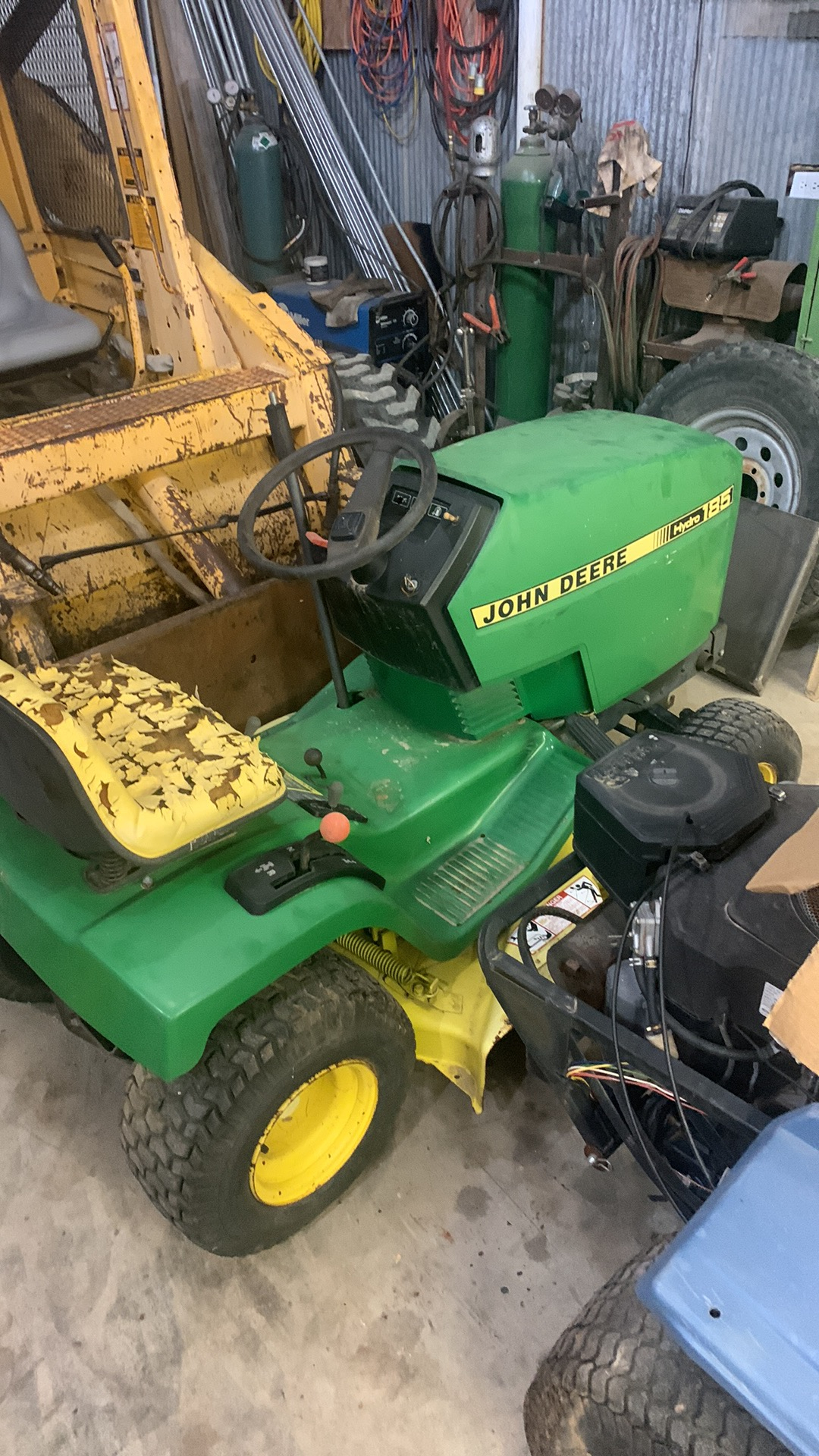

Not a great picture but got to start somewhere

LOL It looks like a 1987 and a Sundstrand trans.
3/4 qt of oil.
Is this a good trans?

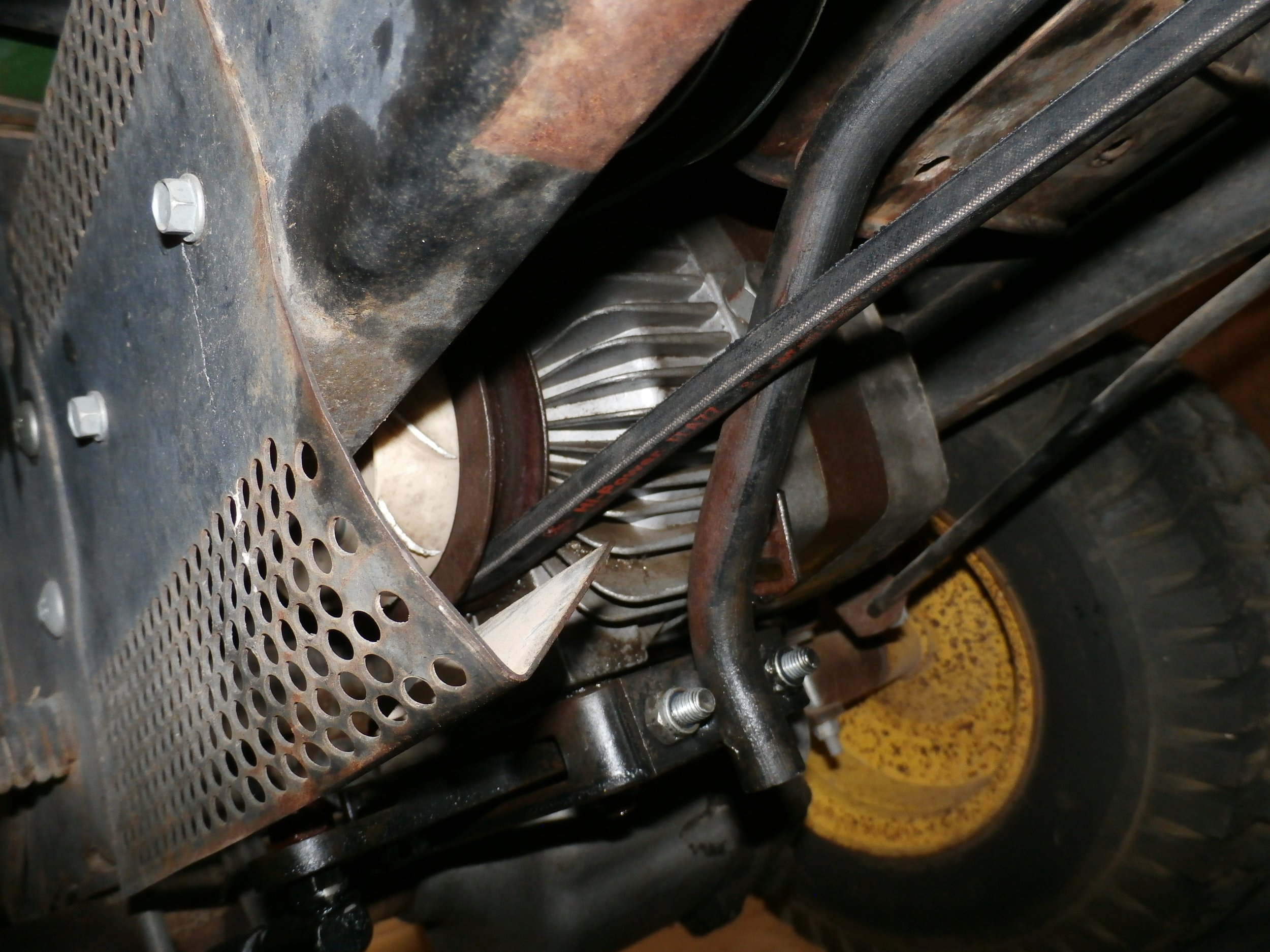

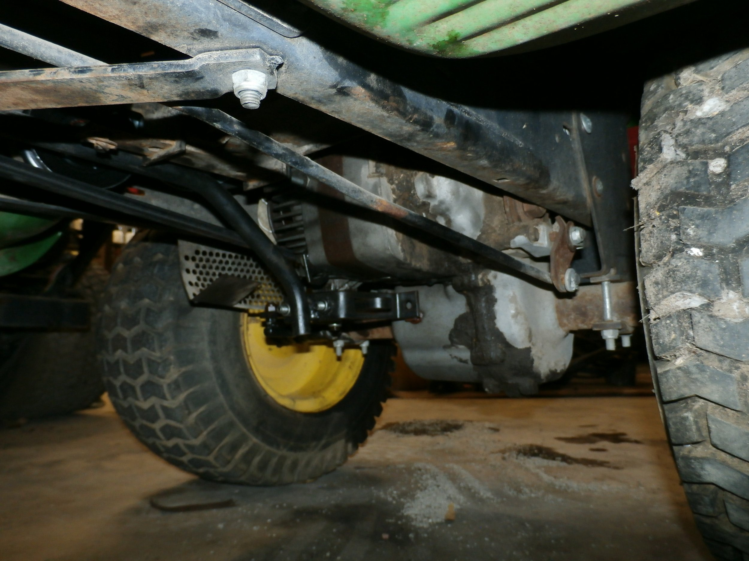

I took a few pictures. Hope the turn out.
One werd thing is I drove it and worked good. Now I can push it with out turn the lever to put the motor in neurtal. That lever is free and works like it did before. It's not stuck over.

For future refference it was air locked.
I removed the fenders and took the bleeder out ot the top of the hydro.
I rotated it by hand and put oil straigh in the bleeder.
It works great now.
