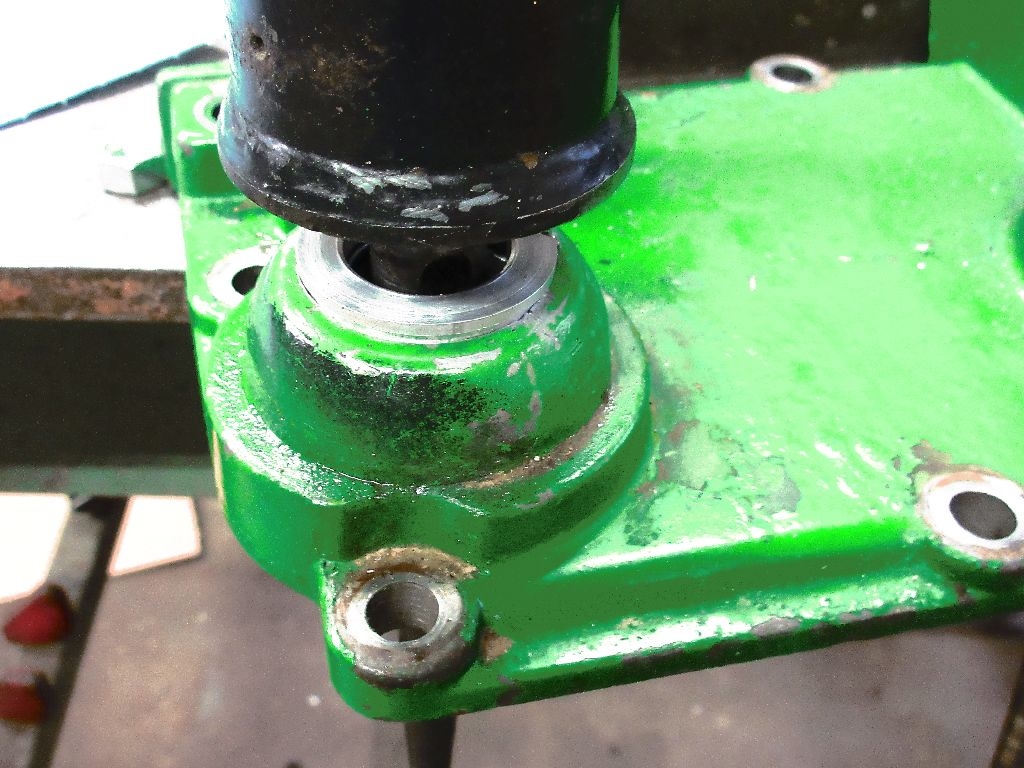

Thanks for all the comments. I pulled the gear shift cover and found the bushing supporting the shift lever ball had worn through to the cast aluminum cover. A new cover from John Deere is over a thousand bucks--several used listed from $110 to $400! Assuming the used parts may have similar damage, I will probably bore the casting and sleeve the bushing. I know there is not a lot of meat there to work with. Any other comments are certainly welcome. This is such a simple problem compared to what may have been a more serious issue, requiring splitting the tractor. However, simple problems often have not-so-simple fixes. Incidentally, the right-hand shift bushing is like new. Makes sense as the left-hand lever controls the forward/reverse action.

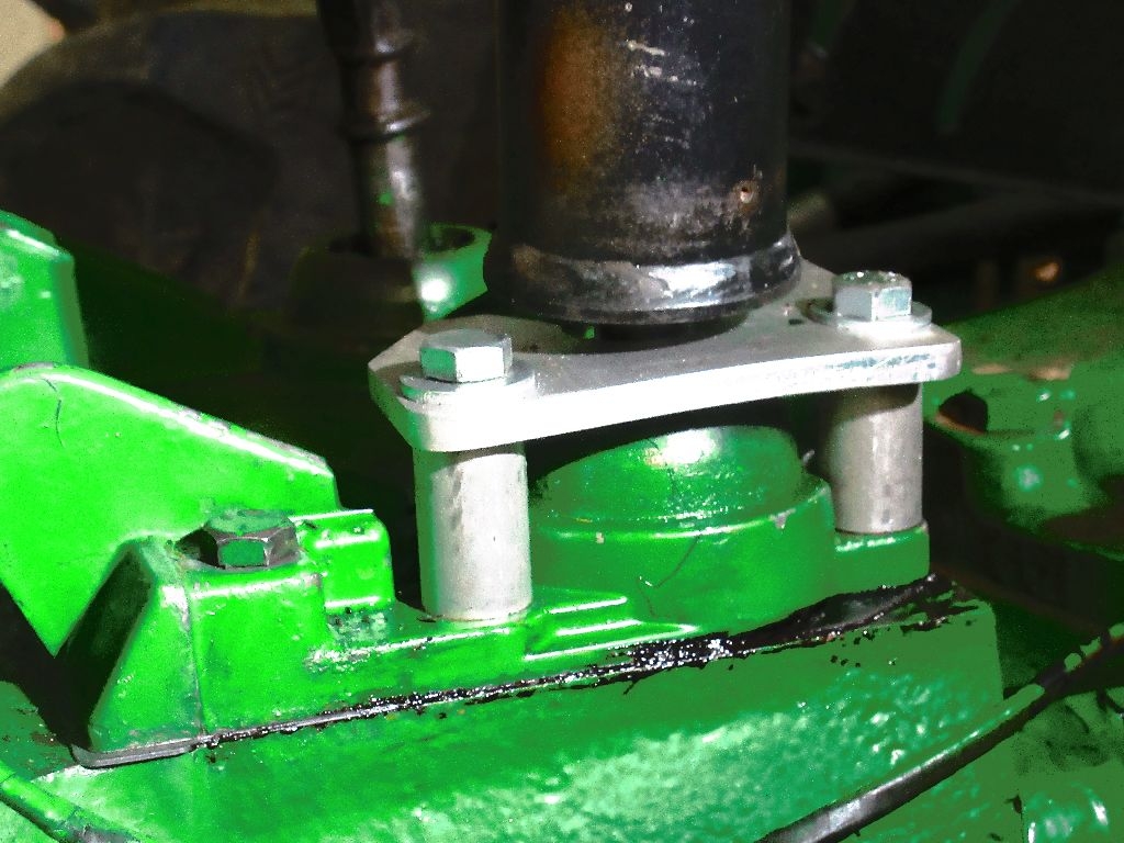

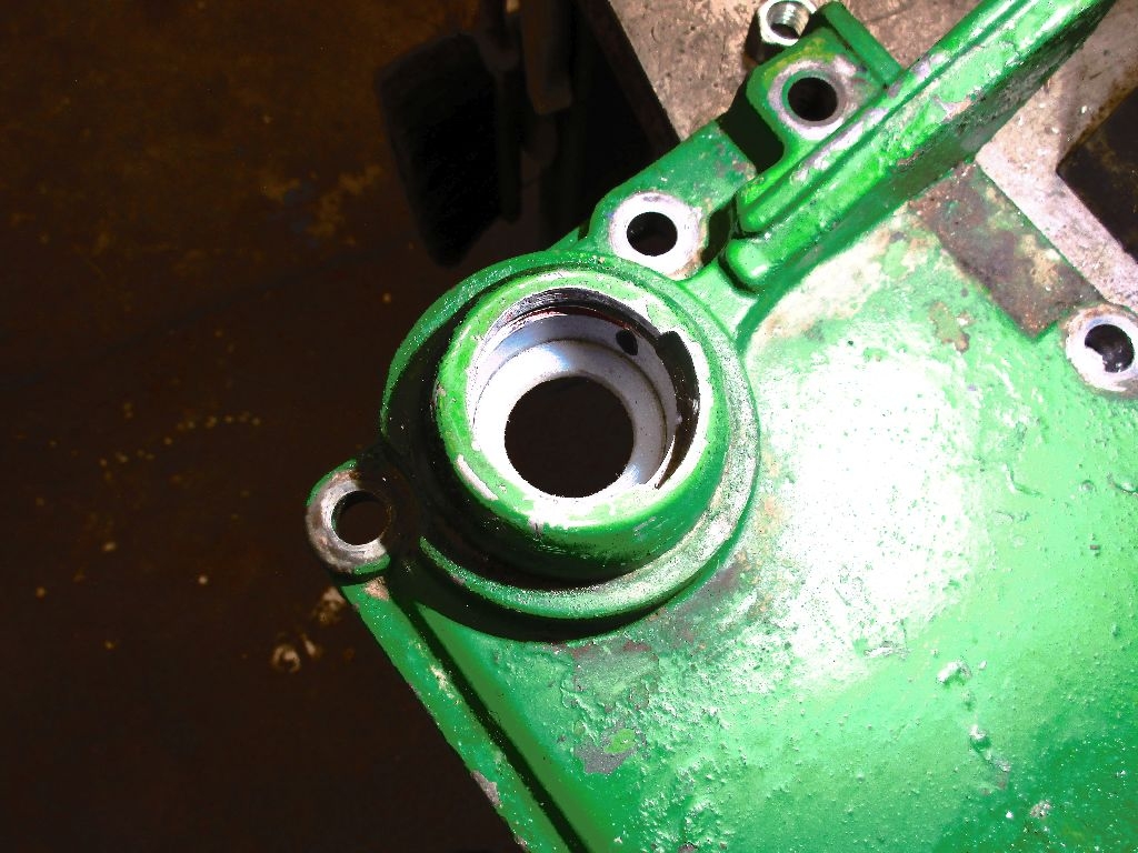

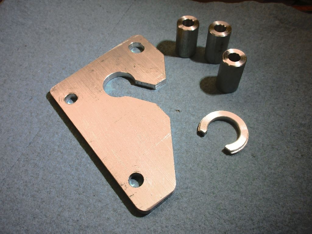

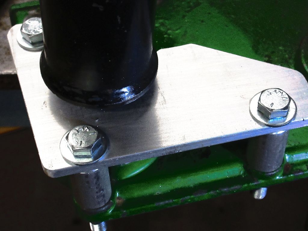

#15
Easy diagnosis, difficult repair. I bored the damaged cast aluminum cover plate and made a plastic bushing, picture #1. The bore, however, made the snap ring groove unusable and a new approach was needed to retain the ball on the shift lever. I machined a hold-down plate, retainer, and standoffs as seen in picture#2. The retainer is shown in picture#3 and the trial assembly on bench in picture#4. Picture #5 shows the mounted hold down on the tractor. This was a non-standard approach to fixing a hopeless situation as a new casting would cost over $1,000 if available. A minor issue was the sheet metal cover (not shown) that encountered interference, but that was fixed by fabricating some simple attachment brackets. The tractor now changes gears smoothly and stays in reverse. The conclusion is that the damaged bushing/housing was preventing the action of the shift lever to fully engage the reverse gear.
