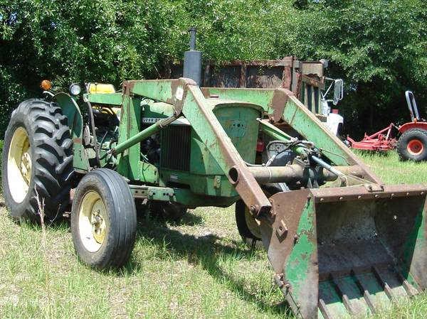

Hi, I am new to tractors - we mainly grow things in greenhouses but decided to expand outside to a couple of acres of vegetable cultivation, and also need something to mow a couple acres of grass.
I found an older John Deer 1530 that was used on a horse farm mainly for hay moving. It runs pretty well, and my only concern is it has kind of an odd bucket on it - it is smaller and also only has one ram for tilt.
Two questions:
1) Does this bucket suck?
2) If so, can it be replaced with a larger one without a major retrofit (e.g. new rams)
Here's an image

The loader on the 1530 is one of JD's cheaper,lighter built loaders. IIRC it has no down pressure on boom cylinders. You could "blacksmith" a larger bucket on it.

Thanks for the quick response - I will check on the no down pressure on boom - in the little time i have on equipment with a loader, it seems like most of the time I am using tilt to apply downpressure are there other impacts to this design?
Also, is there a model of loader I could retrofit easily that is widely available used?

Your loader is a model 37. In JD loaders models 48,145,146,175 come to mind

That is not at all odd to me.
That is what most all loader buckets were many years ago.

From your picture, the boom cylinders are single action, so no down pressure. :thumbdown:
