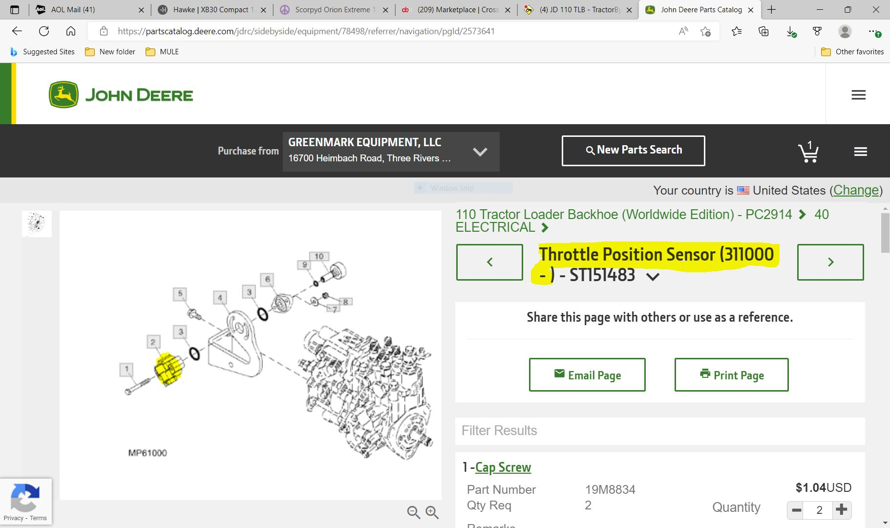

Maybe flywheel engine speed sensor (if you have it) there is a serial number break where it is no longer used.
Or throttle position sensor. It could be at the throttle linkage, or injection pump, depending on your serial number.
   / JD 110 TLB
My '04 does have the flywheel sensor. Umplugged it and tractor starts off a little sluggish but runs/moves in forward and reverse just fine now. Pulled, cleaned a little corrosion off sensor and reinstalled. Running fine at the moment. I will watch it to see if it keeps.
