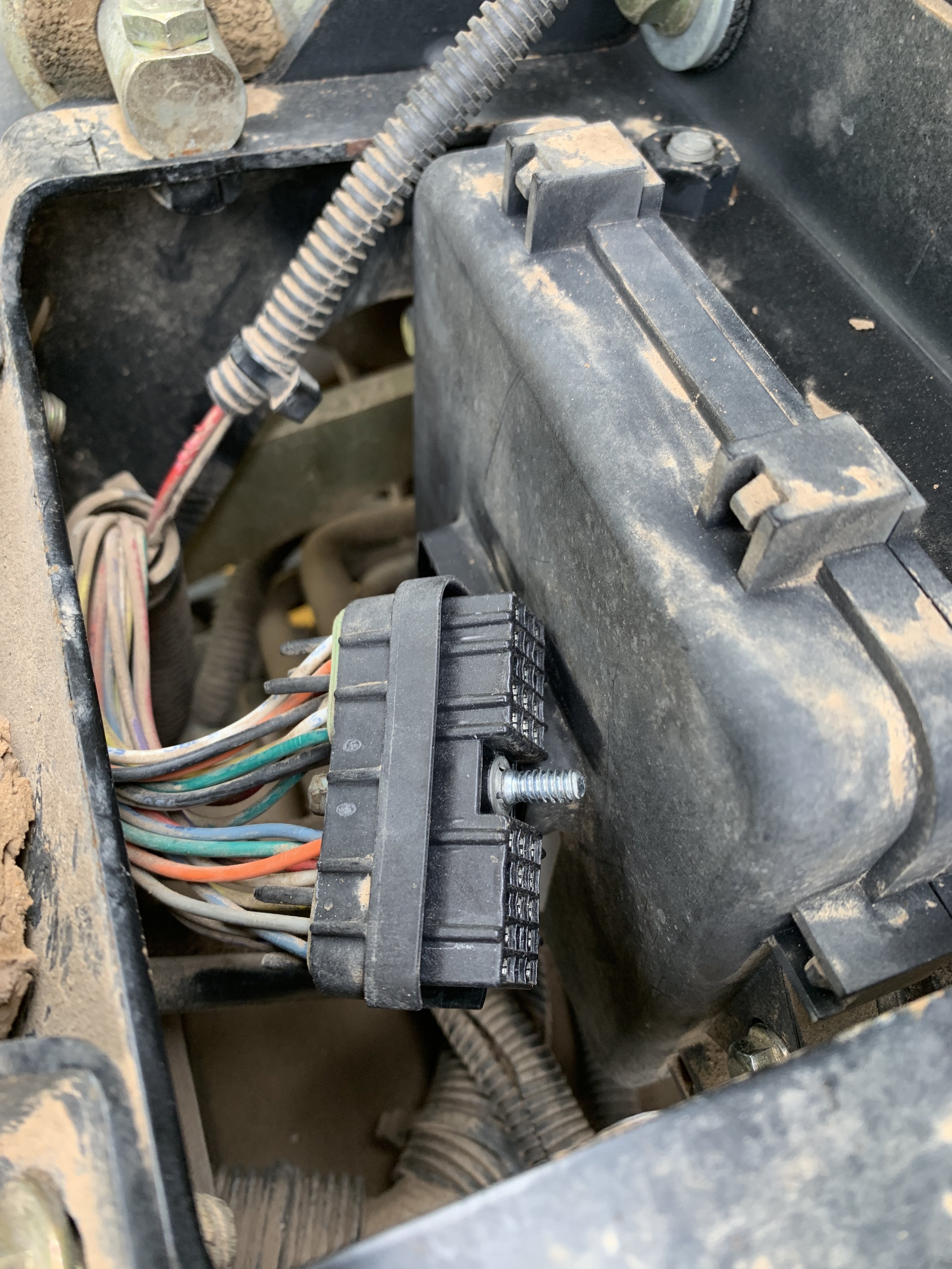

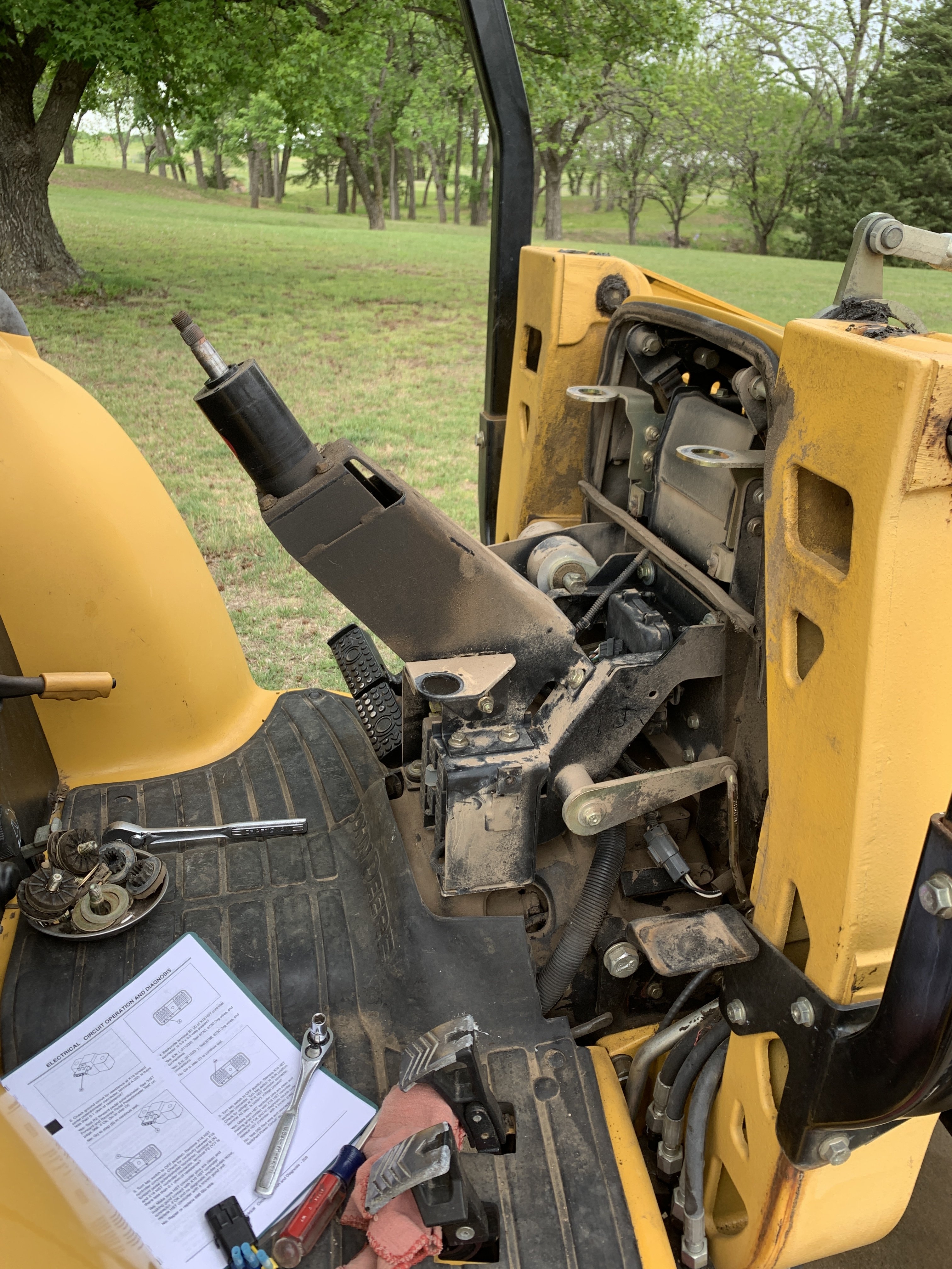

I wanted to come back and post what I did to fix the issue. The problem turned out (I think) to be a bad connection between the wiring harness and the transmission controller. I was just taking a shot in the dark when I decided to check the controller and look for anything that looked off. The controller sites behind/under the fuel tank so the tank had to come off to access the controller. There's just one connector from the wiring harness into the controller. I disconnected it, blew it out and cleaned up the pins on the controller side. Before I reattached the plug I used my multimeter to check continuity on all the wires that I could trace. Nothing looked out of the ordinary except for one wire that had a two small cuts in the insulation. The cuts didn't go through to the wire so I taped that up and then reassembled everything. That was in late April of 2023. It has been operating normally for the two years since then. At the time I really didn't have a lot of confidence that I had fixed anything but it seems to have done the trick. Thanks to all of you that took the time to offer suggestions and ideas. So glad to have this frustration behind me.

View attachment 3505289View attachment 3505293View attachment 3505294
