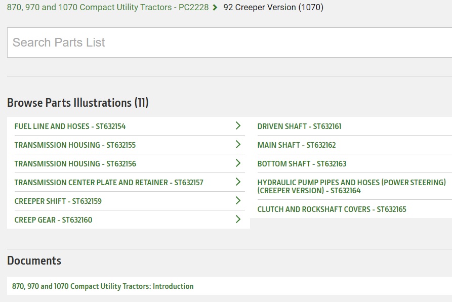

From what I can find (very little)there's an option a person could by that gave at least one more set of gears.(Creeper) very very slow off hand I cant remember what the shift sticker on the fenders says on factory speeds. 0.2 mph cant remember. If you go to JD parts and put in 1070 you can scroll though and find a Creeper gear set up. . Problems I'm finding is the John Deere/ Yanmar cross over I haven't found the person who knows. How to or who can in stall or sells one.
   / JD 1070 creeper gear. #7
jdparts for the 1070 shows a separate listing for "Creeper Version" which might indicate it was a factory build.. thus not easy to buy/add at a later time. Maybe a different transmission case, etc.
Some detective work within jdparts might solve any mystery.
