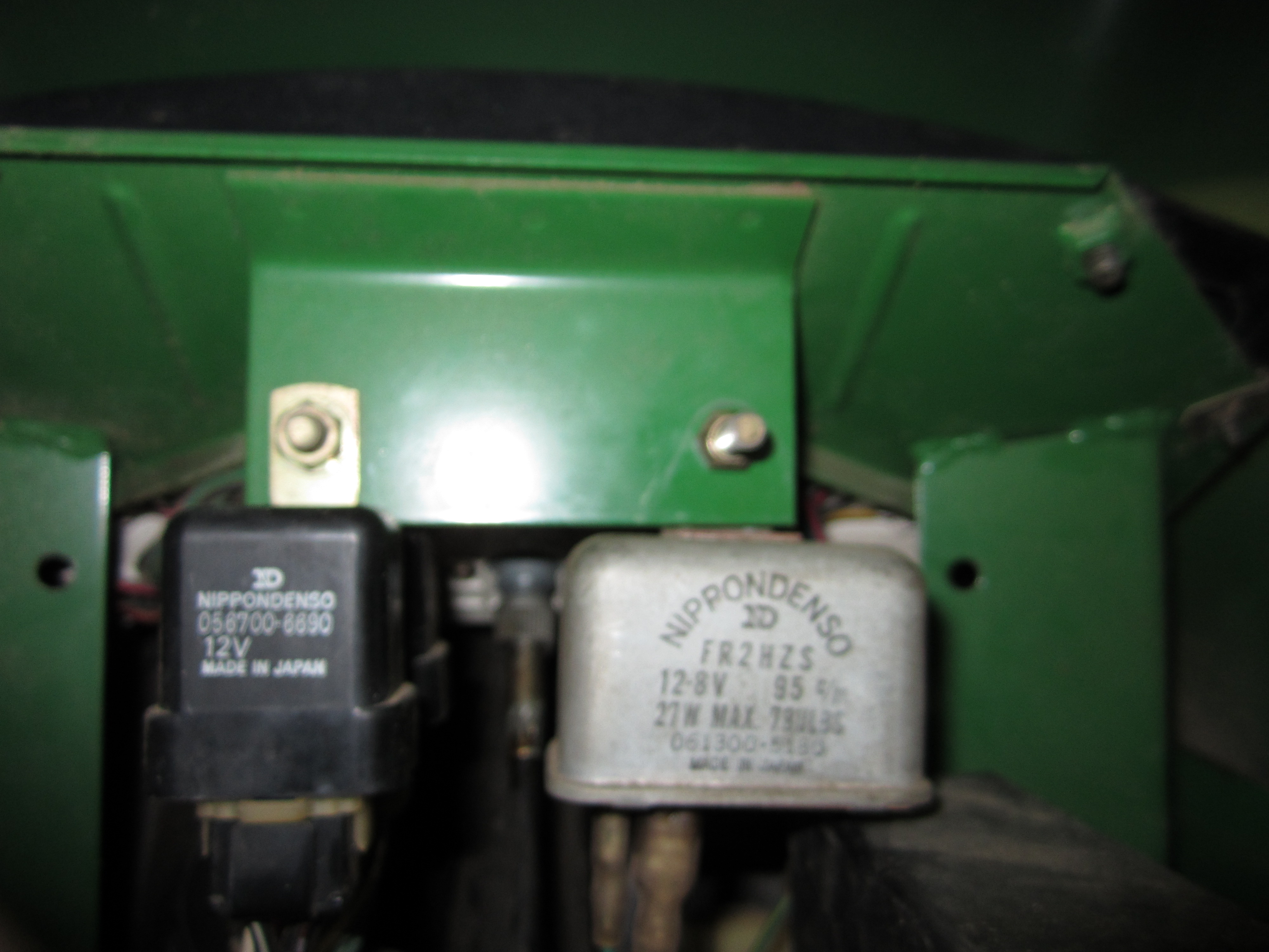

I will now go over your most recent photos re flashers.
Dave M7040
/ JD 1070 charge light help? #43
I cannot understand the fact that the John Deere 1070 is showing a park brake indicator flasher in the WSM and you believe you do not have one.
The photos you sent me have the silver Nippondenso FR2HZS flasher. The other black box to the left is a neutral start relay.
Park brake indicator flasher appears to be back to back with the items in the first photo.

Dave, FOUND the park brake flasher! it was laying around below the pictured flasher after we checked that.
I reinstalled it this afternoon.
That being said, there hasn't been a warning light when parking brake is on in the dozen or so years I've owned that tractor.
Not sure if that's a fuse, switch, spring or what? It's pretty much a nonissue for me. I rarely use the parking brake and know immediately if I left it on.
The serial # is A001131 so I'm assuming it's an 89? Older than I thought but still a good running tractor minus the charge light issue.

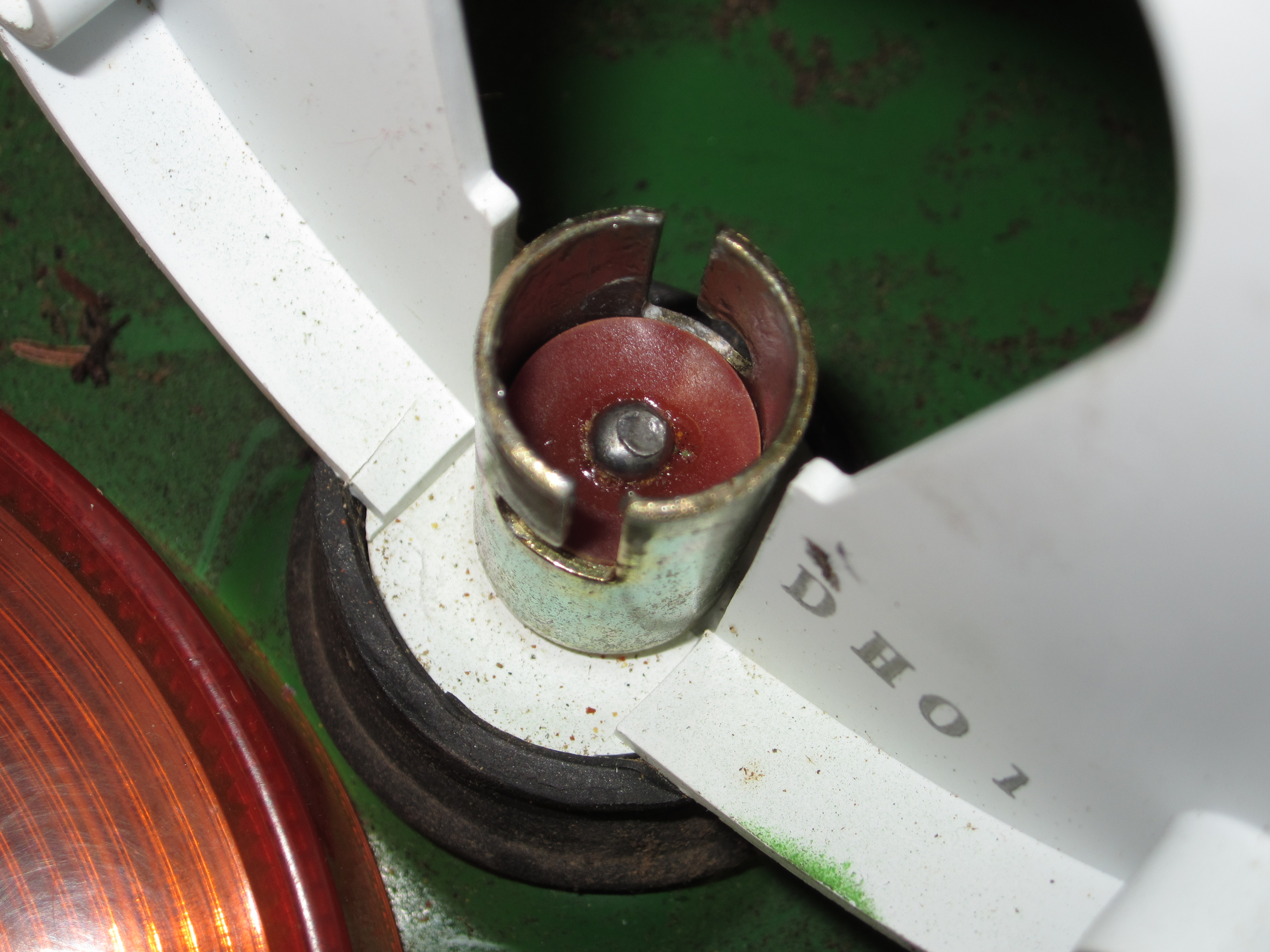

Can you remove one lens and then the bulb. Photo the numbers on the bulb, the light socket and the wires leaving the warning lamp assembly.
Dave M7040
I can do that tomorrow. I believe one of the warning lights was missing when I bought it?
Or, it might have been a broken lens on one of the originals?
I replaced it with a brand new OEM light (in original box) that my father had laying around for a JD 950.
Pretty sure I replaced a bulb here or there.

Thanks for solving the mystery of the second flasher. They both seem to be on the same fuse.
They flashers appear to be the same, warning lights and park brake lights. Do you agree.?
The flashers appear to have wire female harness terminals which slide unto male terminals on the flashers rather than the flashers plugging into sockets.
This makes someone mis-wiring something to do with the flasher much easier.
Do the two flashers only have two terminals on their bottoms?
I am trying to imagine something wired wrong and the flasher powering something else by mistake not design and this is where the overload happens causing the charge light to come on.

"Can you see where the two black ground wires go from each warning lights?"
Yes, I have two blacks coming out of each warning lamp. They go directly into a plugin harness.
Took pics of both bulb "sockets".
One has an 1156 and the other a T 1156 Assume they're the same?
