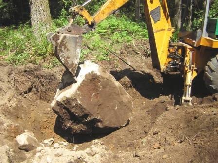

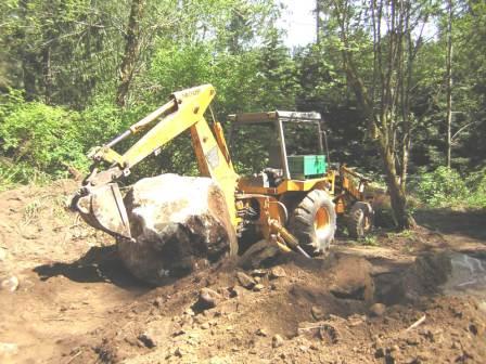

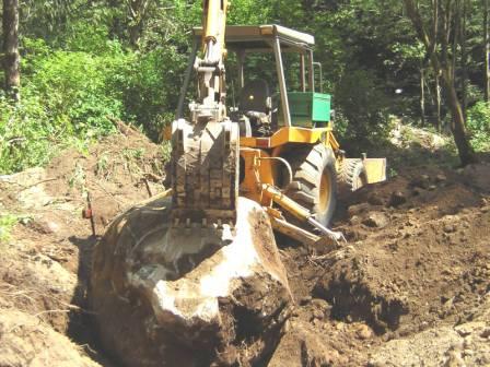

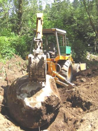

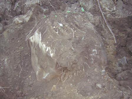

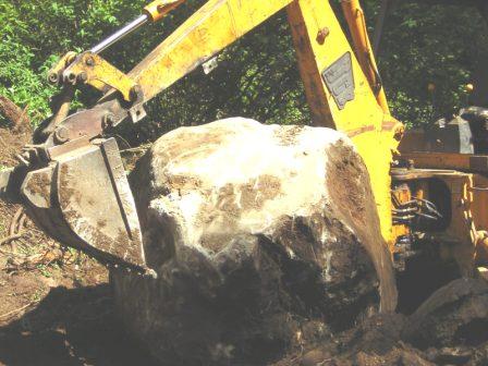

I am currently clearing a site for my garage and encountered a rather large boulder. I have moved some pretty good sized rocks with my JCB 1400B but this was the biggest yet. I had to remove it as it was in the way of the concrete slab, I was able to build a ramp and pull it out with the backhoe, boy am I glad I own a fullsize backhoe :)
I attached some pictures of me attacking the boulder and getting it out of the way.
PS: The rear tire of my backhoe is 4 feet tall and my backhoe bucket is 24" wide to add some perspective

Yeah, a thumb and 5 others hoes. I bet that rock weighs 20,000 lbs. Once you get under it they don't move too bad but it sure is a lot of work to get under it in the 1st place. Nice job of removing it. later, Nat

Nat, I read your reply and thought -- Nawwww. Then started thinking. It's about cube 5' on a side. That makes it 125 cu ft of volume. Granite is about 125#/cu ft, so the rough estimate is 15,625#. Hey, that's a BIG rock! And a good estimate by you!
