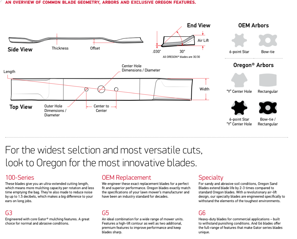

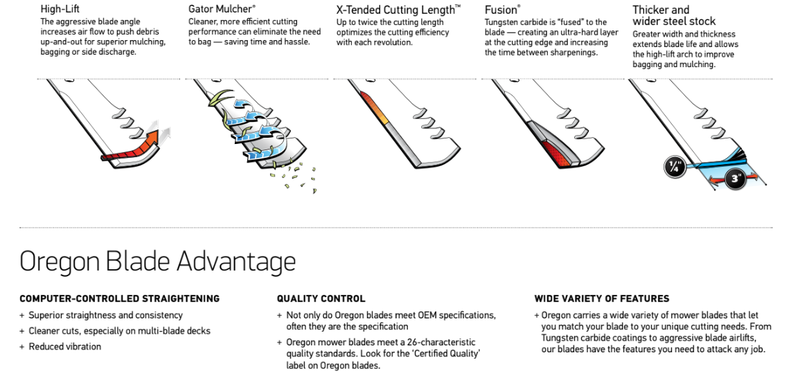

hello im looking for replacement blades tor my jacobson t422d turfcat 72 oem blade number 390515 or oregan 91-352 the blades are discontinued. is there a sub blade or a blade that can be modified to fit
Oregon will have some that fit, here is how to measure:
And the Website: Mower Blades | Oregon Products
