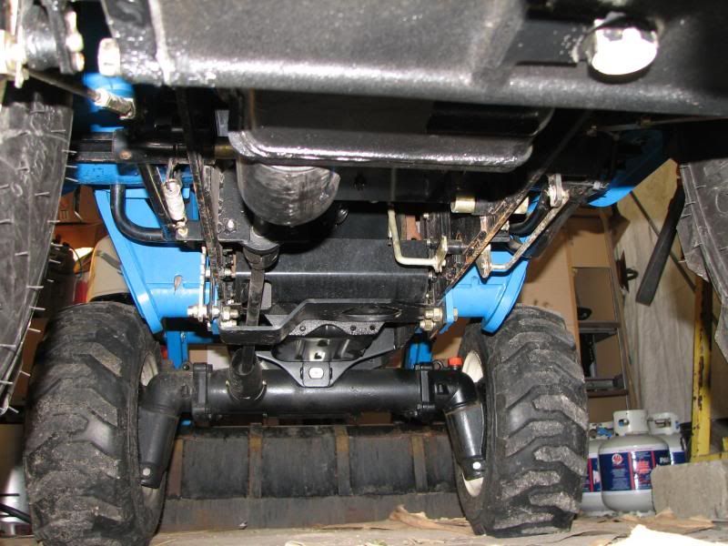

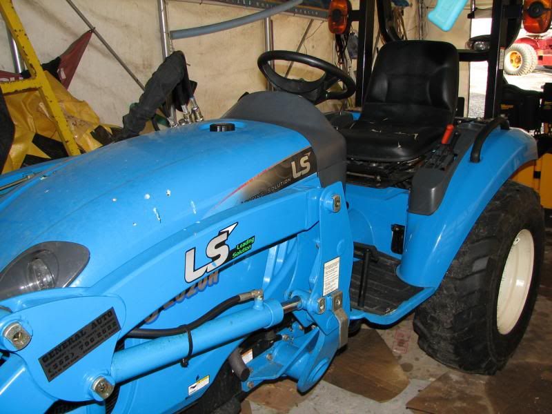

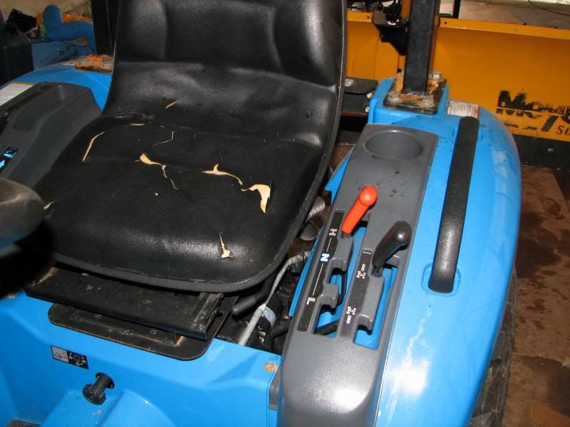

The owner said this is his 2nd year with the tractor and overall he's happy with it. One rear axle seal failed at about 20 hrs. but LS fixed it under warranty. The seat is falling apart but they want the old seat back before they will give him a new one. Bought the tractor in FLA. but had the warranty work done by the dealer in CT. (Setaro Motors) and he couldn't say enough nice things about them.

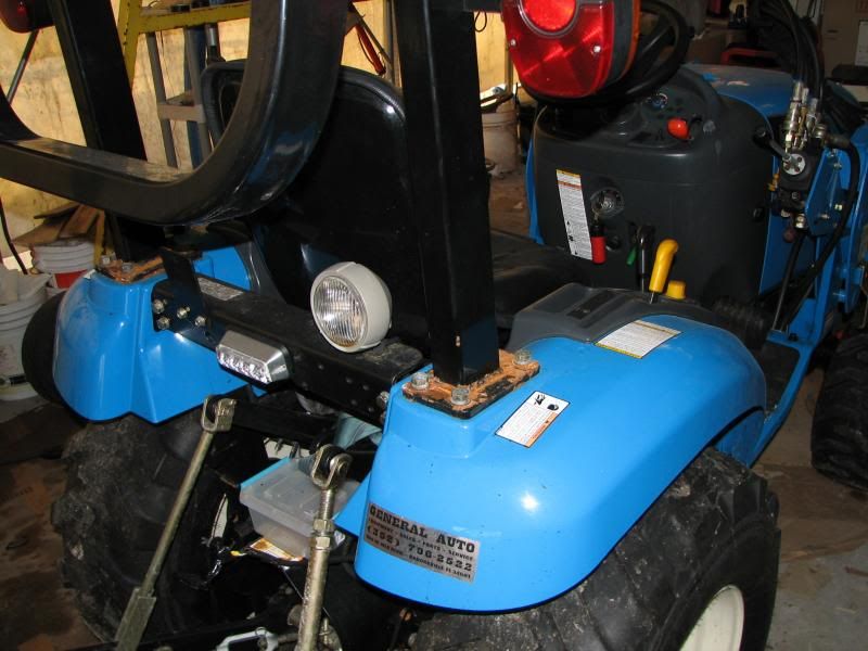

It has a lot of rust for being only 2 years old.
That's what I was thinking, she's not a garage queen like mine little compact will be.
He commented about the rust and that some of the hardware could be a little better but added that we live in a tough environment(near salt water) for machinery.
/ j2023h size comparison #30
The rust along with the amount of tearing on the seat would be a concern for me after only 2 years of ownership.

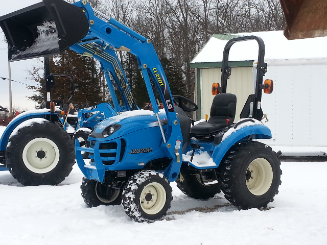

I stumbled upon a J2020 today and had my camera in the truck. From the specs this is almost identical to the J2023 in size.
The known difference between the 2023 & 2020 are- the 2023 has dual separate forward/reverse pedals. The 2020 has a single treddle pedal. The 2023 has larger hydraulic pumps; 9.2 gpm. The 2020: 8.6 gpm. The 2023 uses the LL2101 fel w/lift capacity:1270lbs. The 2101 fel weighs 638lbs. The 2020 uses the LL2100 fel w/lift capacity: 1150lbs. The 2100 fel weighs 494lbs.
