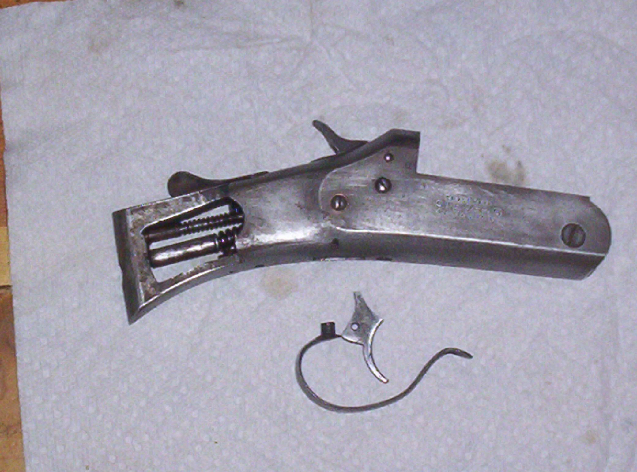

This J Stevens was old in 1920 and is missing a trigger spring. I believe it is a flat spring. Have you replaced a spring in one of these old timers?

   / J Stevens 12 ga trigger spring
#2
sorry wrong picture.

SimS, Thanks I gave them a call yesterday but they had closed. I'll call them Monday. Jack First is also good for older parts.
My father found this shotgun in a irrigation ditch in the early 1900s with all but the butt stock, he carved a new one. We used to ,shoot the old year out and the new year in, on New Years Eve. The shotgun looked so big when I was little. About 1960 something, the trigger spring went, father put a piece of rubber hose behind the trigger and it worked. I was planning to blue it, though I would replace the spring if I could find or make one.
Things look pretty tight in there I have a guess where the spring sits.

I would reconsider bluing; it might lower any value compared to a well aged patina.

RE bluing: I thought of that but by that time I hade cleaned up the action. About the spring I can't find any of the spring to use as a chinese blueprint. I do have a 4/10 maybe the spring setup is almost the same on the center break shotguns.

Thanks Robert, I'll give them a call. Gun parts corp didn't have the spring.
They are close enough to drive down and see what they have. Richard
I just sent them an Email. Thanks again!
I may have found the trigger spring, got an Email from Nancy at Numrich she figures it to be an Savage Old Model 94. Sent a expanded view, sure looks like it. It depends on who you talk to when hunting a part just like at an Auto Parts Store. The price was small wouth taking a chance. I ordered it today, 7 to 10 days and we'll see. I have several guns in need of a spring of one kind or another.
