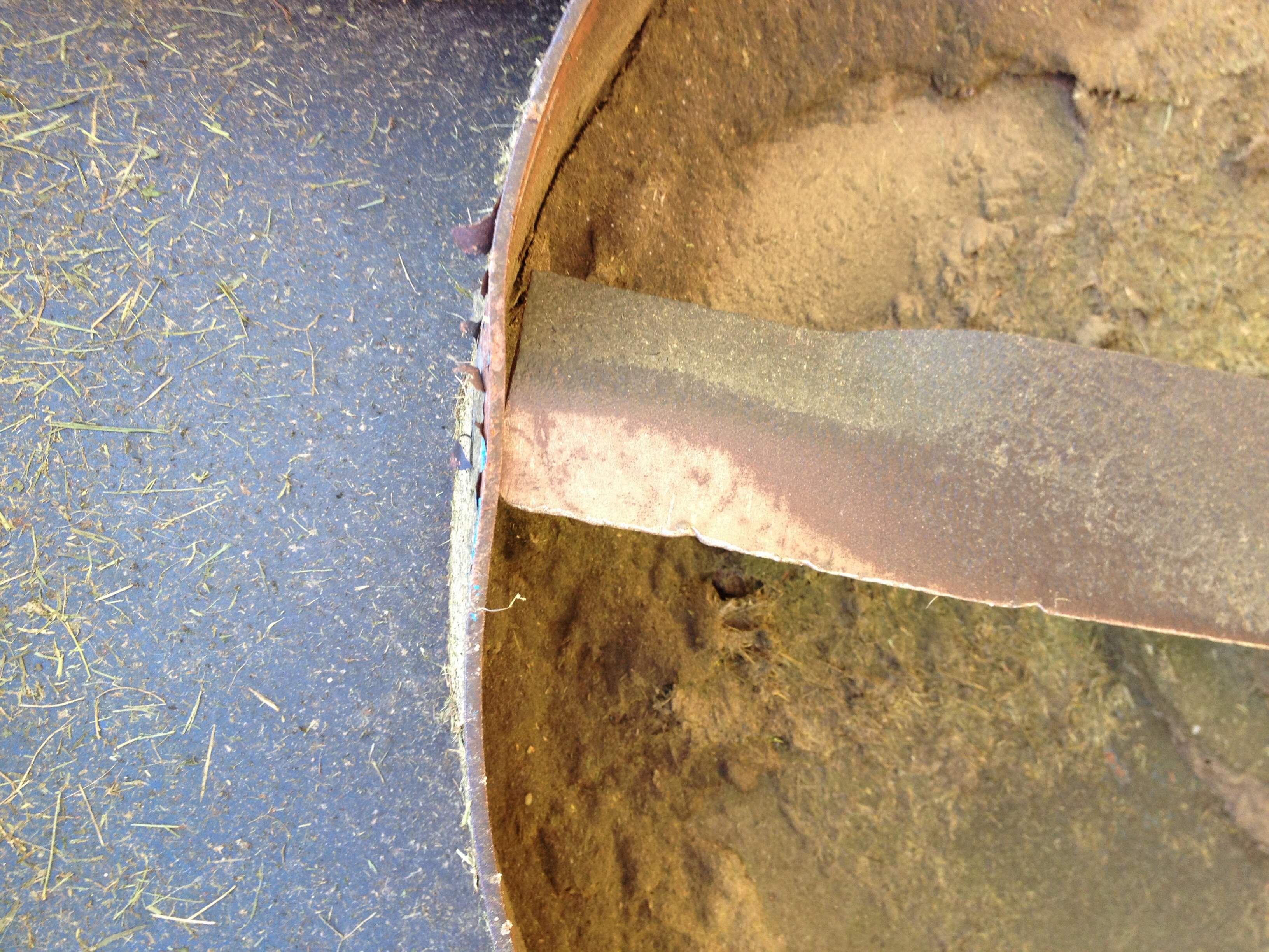

My tractor bogs when in high gear going up hills or cutting tall grass. I run mine at 2000rpms max. I'm here posting cause I just had my mower deck fail and I'm under 100hrs. The center blade has somehow shifted and the blade hits the deck(radially). I have a suspicion the spindle shifted or the bearing went out, no warning. I will remove the deck and inspect shortly.

Your situation is most unfortunate, sorry to hear it. I removed my deck about 15 hours ago (30 hours) and made sure to grease the center spindle because its nearly impossible to get a grease gun to with the deck installed. The manual calls for the spindles to be greased every 24 hours. Mine definitely needed some lube. I also made sure to lube everything labeled for grease or oil on the maintenance diagram.
That being said...I am not sure why your blade would have deflected that much, even if it was low on grease. The only problem that I ever had with blade alignment was on a small John Deere garden tractor. The blade hit a stump and bent the deck around the spindle mount as it was the weakest point. Let us know what you find out when you get the deck off.

Good news guys, turns out I hit an exposed root and dented the deck. It doesn't take much, cause I put a heavy duty crescent wrench on it and straightened it out. Sorry if I scared anybody, I thought the issue was more serious. Pic is orientated so left side of pic is front of deck.
