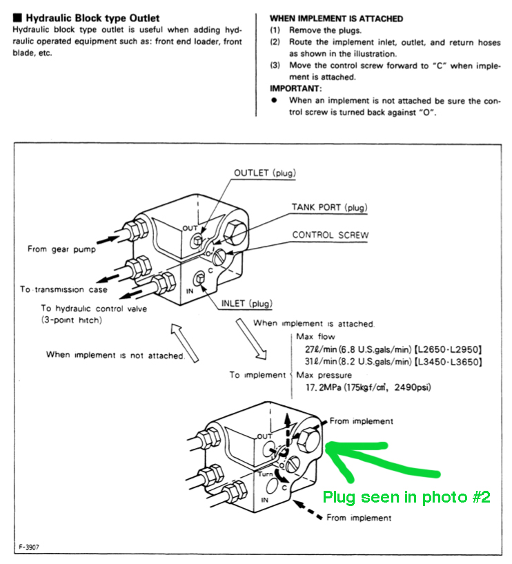

I'm not sure how to reference a thread but " Hydraulic winch installation Kubota L2950 " by cytafex shows a diagram of the hyd. block and the line feeding the 3 ph .
3ph is fed via steel line from hyd. block and honestly I've not sorted out how / where it returns.

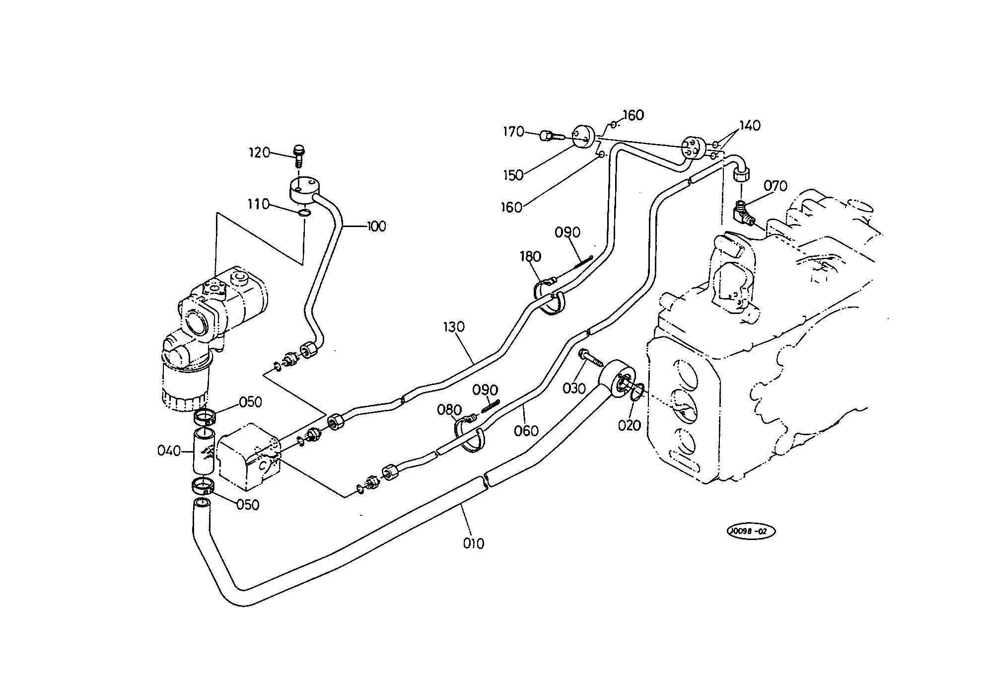

in this picture
number 130 is the pressure / feed line
number 060 is the return pipe

To check if loader is plumbed right all you have to do is turn the screwdriver slot in the 2nd picture and it well shut off the loader and the 3pt well be the only thing working. Turn it back then both well work, if it wasn't right you would of found that out long time ago.

L3450, I think you misunderstood. You have the same hydraulic block as I do there are 3 lines that feed the loader, two from the "side" facing you when you're looking at it, and one from the front that Kubota connects with a 90 degree fitting to point towards you. That plug you mention is normal.
Do what I did - convert your two loader connections to ISO ag couplers (3/8). When you hook up the remote, hook it in series so it's "in" is the power beyond from the loader you can identify this because it connects to the "in" on the hydraulic block. Then, the power beyond port on your new valve connects to the "in" on the hydraulic block. Drain if you need it can be teed in to the return on the front of that valve or run to either of the two 3/4 pipe thread plugs in the transmission or above the 3-point top-link. You could also cut the hard lines and add a fitting, but it's unnecessary.

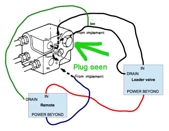

Here's a quick edit which shows the factory loader valve, and then the setup with the new remote valve added. A two spool valve is not much more than a single, so I'd get a 2-spool valve and plug the ports until you need it. (Or if you don't mind, plumb it now!)
Factory loader valve:
New setup, your new lines are in color:
Note the green line tees to the existing black line, you can do this with simple pipe fittings. Or as I mentioned you can bring it to one of the two red-capped fill ports on the transmission/rear housing, however the rear one has a vent you'll need to replicate if you go that route.
Hope this helps.
