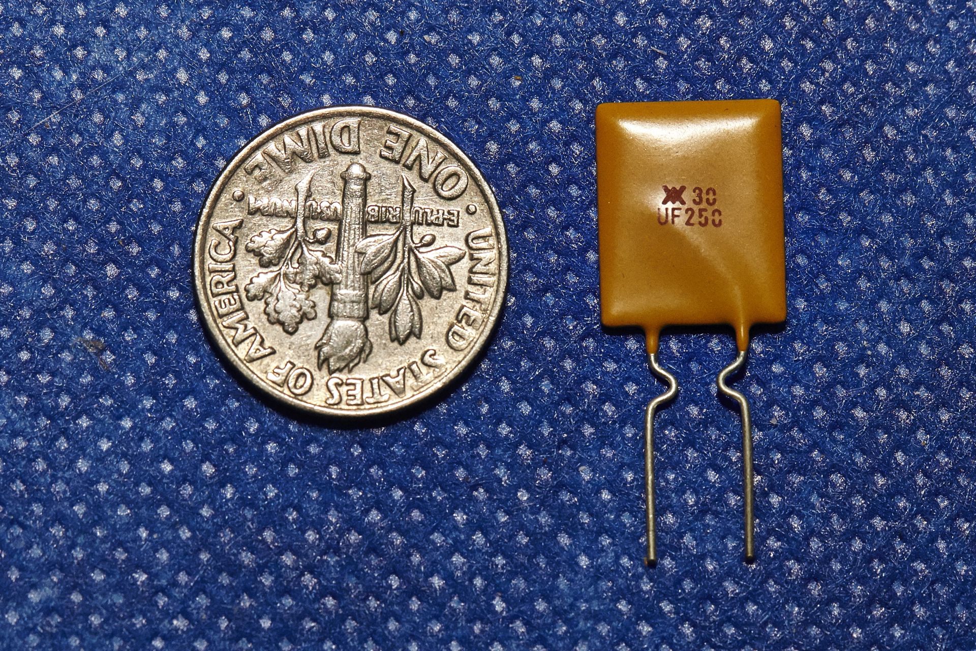

   / J Deere 4300 starting issue #13
I had the same problem with my 4400HST and went through the **** of replacing the $6 thermistor which solved the issue -- a LOT of 4xxx tractors have had thermistors go out -- search and you will find out about how to replace it (I added another 6 inches of pigtail and silconed the thermistor and an inch of its leads to a JD key fob and silconed it to the top of the fuse panel for easy replacement next time. IF this is the route that you take, the leads on the thermistor break off VERY easily. FWIW, it is behind the fuse panel inside a large bundle of wires. (I think I attached a picture of a thermistor)
