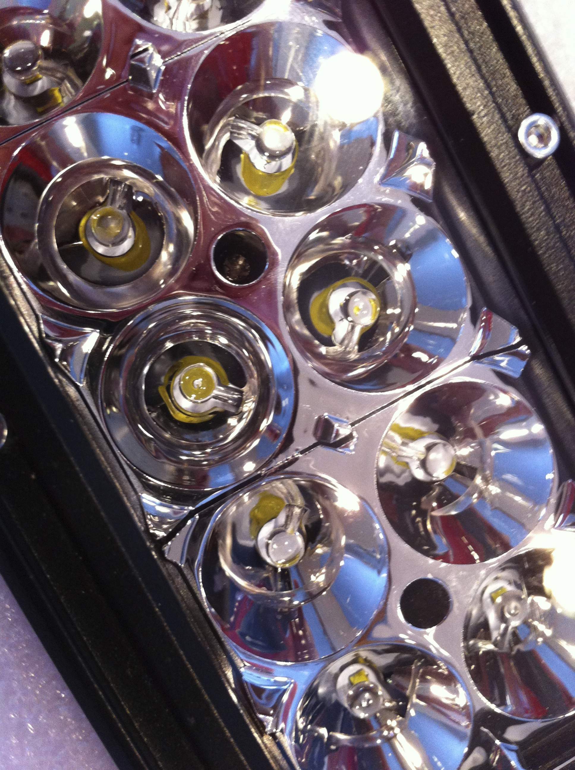

Others have more experience on what types of lights to get for a tractor but I think for a tractor instead of a light bar you'd be best served by a number of spot lights pointing in different directions. The 60ー floods only throw light out about 20-30 feet and the 20ー floods reach out further. These lights are kind of a compromise between spots and floods with 30ー beam and are what I plan on mounting onto my tractor when I get it.
FWIW, all cree means is that there is a little lens over the LED emitter that helps aim the light onto its reflector better. On these little lights, the cree lens is tiny, barely the size of the emitter and on light bars, the cree lens is larger, and part of a molded assembly that covers multiple LEDs. See the attachment for photo detail.

FWIW, all cree means is that there is a little lens over the LED emitter that helps aim the light onto its reflector better..
Cree is a company that makes LED emitters and has headquarters in Durham NC.
Most of the LED work lights I see appear to be using 3w emitters (example - 18w total and 6 emitters = 3w each), so if they are using Cree emitters are likely using their XP-G emitter as they are commonly driven at about 3-4w (around 500 lumens) and are fairly small in size.
Another very popular emitter they make is their XM-L or XM-L2, these can be driven at 10w (around 1000 lumens) and are physically larger too.
In flashlights a smaller die size emitter is typically chosen when you want a narrower beam and the larger emitter when you want a broader beam (usually along with higher output).
Of course they can and are overdriven to higher outputs by enthusiasts. :)

I just learned something.
Cree is getting used for LEDs with lenses like Xerox is for copying. I did not know until you just told me that Cree is an actual company making the emitters.
Not only that, but you just explained in a way that I understand why some emitter lenses are smaller and others are larger. Very cool.
Thanks!
