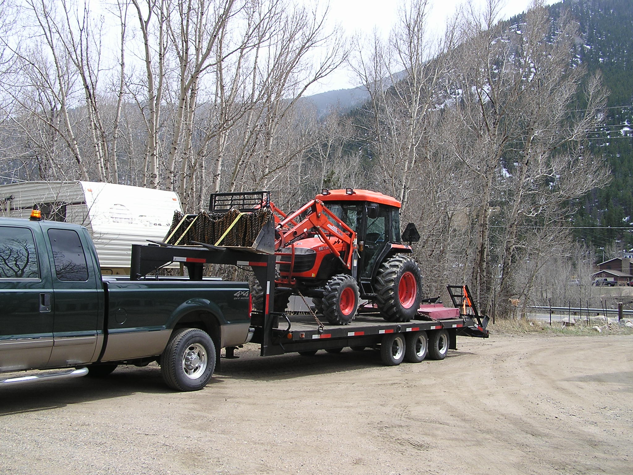

Went down to Penrose and hauled it home. 3 hours each way! Now I get to work and play!

:welcome: To the Pack. Well, since we now have a picture, it really happened. Enjoy your new purchase.
