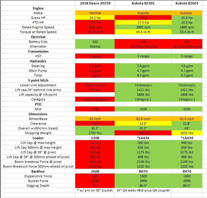

I'm finally getting close to pulling the trigger on my first and possibly last tractor. I have 2.25 acres that is level and heavily treed(mostly smaller lodgepole). I will eventually have around 400' of gravel driveway plus 2 big circular drives for the house and shop.(The property is long and skinny). I dont intend to have any wide open mowable areas as I am keeping as many trees as possible. The tractor will be used for digging up smaller stumps, grading my driveway, clearing brush, smoothing the open areas, blowing snow and most importantly, having fun. I intend on getting a FEL, BH, front mount snow blower, box blade and maybe a small tiller.
While it is level, the terrain is rough so ground clearance is a concern. Because of that i have shifted my focus from the bx and 1 family tractors to the B and 2 family. This along with price, size restrictions, dealer proximity, dealer comfort, and brand comfort has led me to 3 tractors. The 2018 JD 2025R, and the 2018 Kubota B2301 and B2601.
I've gathered up the most current specs i can find and have attached them. On paper, the 2025 is closer to a BX than the B01 series. It really isnt much of a comparison.
I've heard pros and cons for both plastic and metal hoods so i am sixes on that. I'm not a big guy so the operator platform on every tractor i have sat in is fine with me. It's my first tractor so i dont have an affinity for the treadle or the twin touch. I dont even have a favorite color. I'm a clean slate.
The 2025R is a little heavier. I know i am going to give up some FEL capacity with the addition of a 54" quick attach bucket and QA coupler. The alternator upgrade for the B01 is a cheap add-on so that is kind of a wash.
First of all, am i looking at all the numbers i need to look at? Is there something i am missing?
Secondly, despite all the red on the 2025R, the one item that bugs me the most is the 'rated engine speed'. 3200rpm seems really high especially when you are only getting 2100rpm out of the mid pto. The one thing i really want this tractor to do well is blow snow and 2500rpm at 2800rpm engine speed seems like it would throw alot better and more comfortably than 2100rpm at 3200rpm engine speed. Am I incorrect?

Have you thought about the 2032r? You get more PTO hp and 2500 rpm rated engine speed.
   / I've got it narrowed down but i still have questions. #3
I love John Deere's 2R series and the 2032R would have better specs than the 2025R which is really a tween tractor between the 1 series and the larger motor 2R series. There is a major downfall with the 2R and that is clearance at the drawbar: 9.8" clearance at the front and only 6.5" at the rear drawbar. mfsr, what about pushing up to a B2650? You get a 14.6" ground clearance and your width goes from 49" to 53.7" plus you can have wheel spacers installed which should give you about another 3-1/4" extra width for stability. Plus you get another 264 lbs of weight.
The 2032r has been at the top of my list since I came to the conclusion the the Scuts wouldnt cut it. Unfortunately, the 32 hp comes at a bit of a premium and is a tad out of my price range. The 2301 is my sweet spot and a got a quote on a 2025r that was about the same. The 2601 uses the same FEL, BH, etc as the 2301 so you only a little more for the base tractor. The 2650 is just a little jump in price for the base tractor but uses bigger FEL, BH, etc so it kind of steam rolls from there. Admittedly, my budget is flexible but the boss is likely to shut me down at some point..

These are prices from the same exact dealer (didn't check to see how good or bad their prices are but they work for this example). Looks like the 01 series takes a BH70 (list price $7149) and the 50 series takes a BH77 (list price $7783) backhoe. I was thinking they took same backhoe but did a double take on Kubota website before posting. The snow blower, box blade and tiller should be the same price for either tractor (you might be able to get bigger snowblower but let's assume you use the same size.)
So....let's guesstimate the B2601 would run $18,100 at this dealer - that would make the upgrade to the B2650 a price jump of $1k for the tractor and just over $500 for the backhoe. If you get the snowblower and the other accessories all up front then you are over $30k for the whole package. If you are financing at 0% for 60 months your increase in payment for the upgrade will be roughly $28 a month, 0% for 84 months will be roughly $16 a month (You have to put 20% cash down to get 0% for 84 months - I accounted for that but your overall payment would be less because of the downpayment). If you pay cash that's extra out of your pocket. If you are financing then not big difference.
