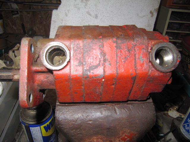

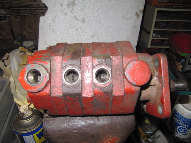

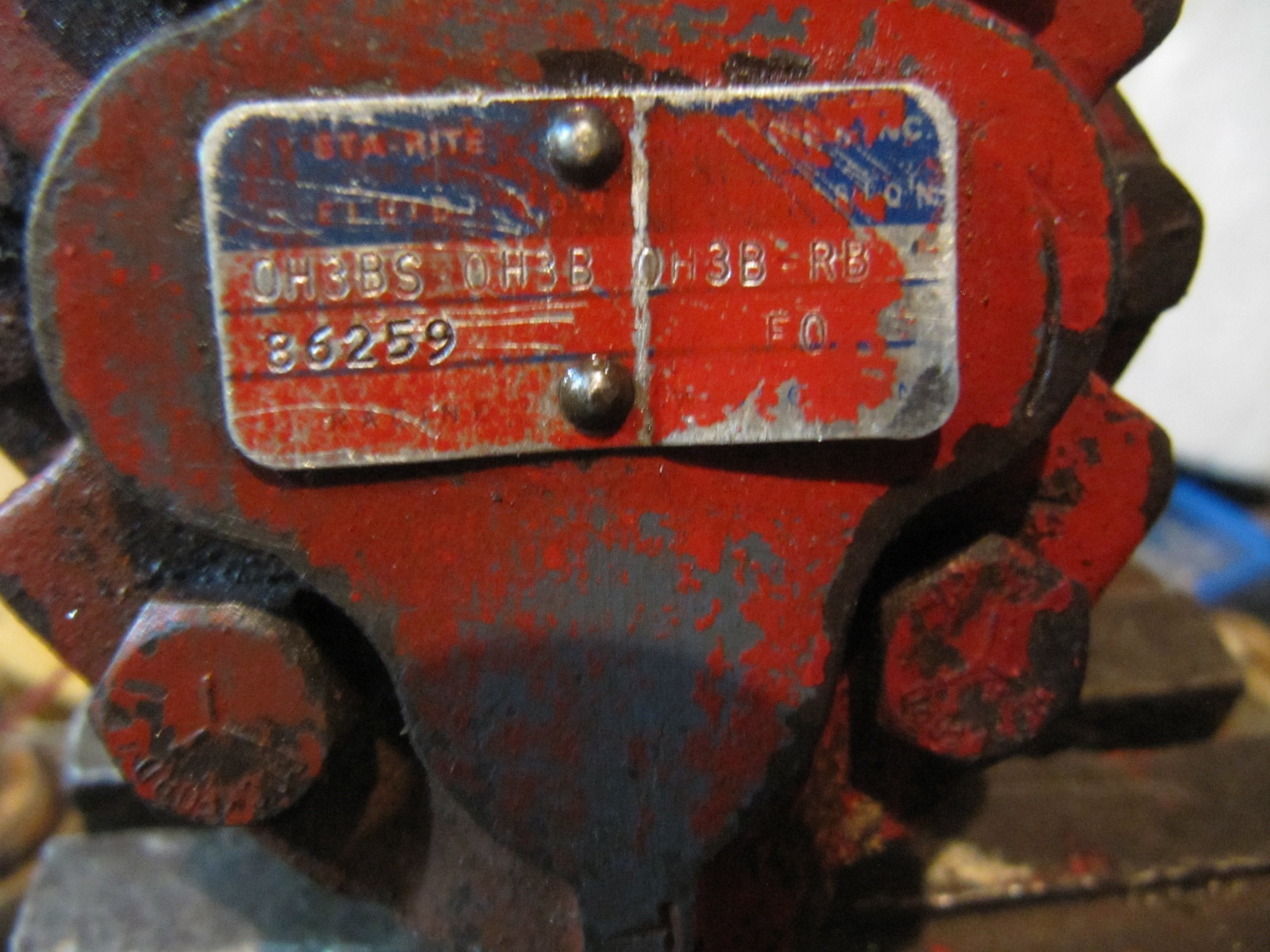

I dug out the pump I mentioned in Plan A.
IMG 2722 and 2723 show the ports on opposite sides of the pump. All three shown in 2722 deliver a detectable push on a finger placed over the opening while turning the shaft clockwise. The ports on the opposite side are larger and I don't feel either push or pull by turning the shaft by hand. IMG 2728 offers information on the manufacturer. Can anyone offer instructions for plumbing this into the backhoe?
The two bigger ports are suction, the 3 ports are pressure out.
The big one will be high volume, the smaller ones are lower volume.
Might use one of the smaller ones for swing circuit, the other for the outriggers and the big one for the rest.
Definitely do not use the port on the valve marked as Tank for anything but a low pressure return to the tank.
Aaron Z
