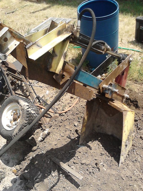

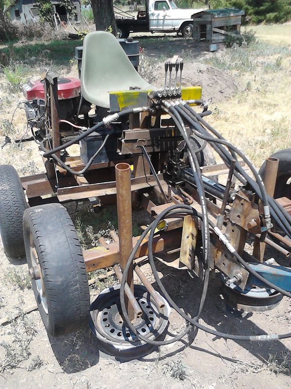

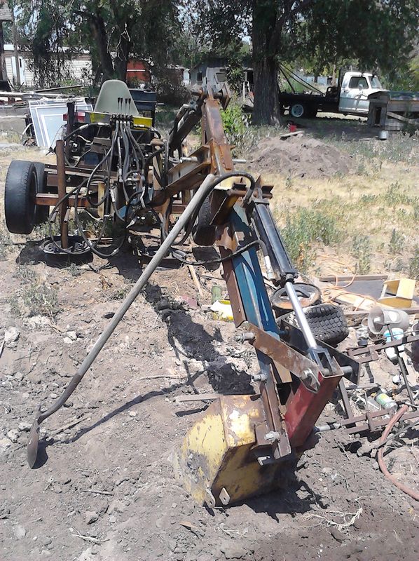

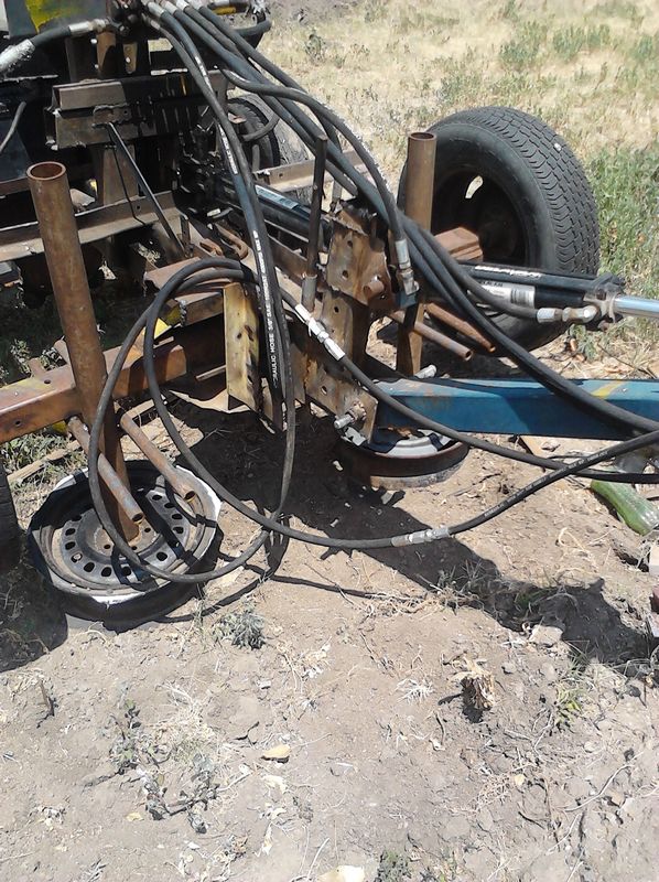

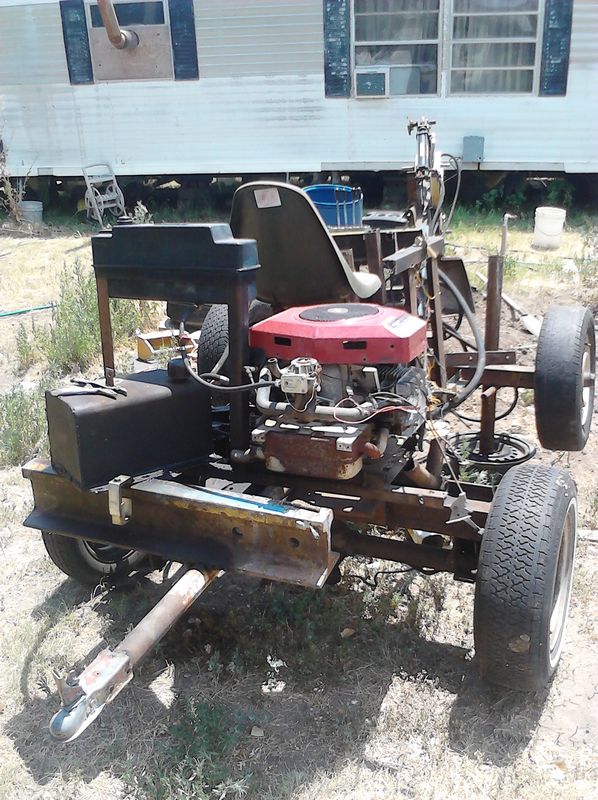

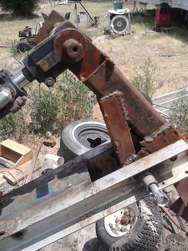

Heres a few pics I took today with my smart phone.
On the fifth pic you can see my new stronger stick cylinder mount. It has worked flawlessly. I used an old hitch and size of the hole was just perfect. I cut the hitch off ad stuck it down that tube and welded her up. The backhoe has stayed together and has done what I wanted/needed it to do. I laid phone line, the water line to my house, dug up old fence post and set new ones. Dug up old stumps and she is still working great. Hasn't fallen apart. I do think my welding has improved too.
Next I need to fix my bent bucket. It pulled apart in a spot I had forgot to weld when I grabbed ahold of an old steel drain pipe.
This excavator was dragging my pickup along the ground when I had it hitched to it to keep from pulling itself around while digging out a stump. xd.
Chad

/ It's time; either get started or.... #135
Chad,
great to see your backhoe up and going again. the second picture of the 4 wheels
and the seat make me think of the Moon Rovers. It's great to see what you and everyone
else are building and playing with.
thanks for the picts, have fun.............

/ It's time; either get started or.... #140
Chad, I love your hoe. Don't take this the wrong way but I'm tired of looking at pretty machines. Yours has character and it's unique. I like that a lot. It's like looking at wood grain, beautiful in its own way!
Glad you like it. :) I originally had those wheels on the ground. But when I added the rear axle from my old Buick Regal. It brought the front end to low to the ground. So I had the idea of welding some old drain pipe to some old car rims to raise it up to get the height I needed. It worked out swell.
I was gonna cut and lower those front tires to the ground. But for now, I like it like it is. (Up in the air)
If I need to move it I just stick the bucket in the back of my truck and away we go. It works great that way.
Chad
Ps. Hope to get a new video of it in action soon. I was gonna do it sooner but my internet went out. They just got it fixed today. As soon as I get some more gasoline for my excavator. I'll post a video with my smart phone.
I'm surprised how good the pictures came out on the Huawei Ascend II smartphone.
