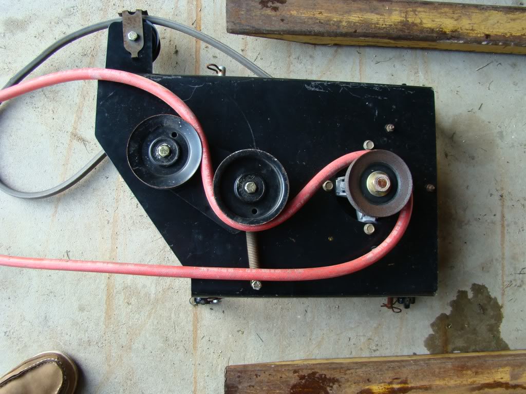

Here's the photo on how to route the bottom belt.
this is looking at the plate from below..when installed on your Cub..the bottom of this photo will be your RIGHT side and that upper outrigger pulley will be on your left of the tractor.
THis is just a hose to show you how to route the belt, not the actually belt.

Thanks Dan. That helps me to feel a little better knowing that I have it routed the correct way. Just weird that your spring goes under the belt, and not over it as that is how mine is.
Also is the belt really taught when it is on before you put the Idler pulley on it? I had to really force the pulley in to place as the belt was really tight

Oh no. I had to use a Socket driver with a Breaker bar just to bring it over enough to get the spring on. Im about 250ish soak in wet so Im not no small guy, so I have to say this belt took some force to get on there. Im just thinking that it was due to it was new and needed to break in.
   / It's Snow Time??? #27
I am sure it's because it's a new belt. Also..the way I do it is run the belt through the pulleys with the spring unhooked....then I grab the hook end of the spring with a needle nose pliers and pull it over and hook it onto the bolt it attaches too...that way I don't ever have to struggle with the belt..just an easy straight pull of the spring to connect it.
