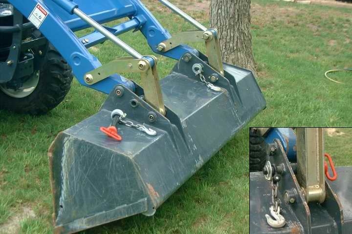

Jim what is that red hitch pin in the side of your bucket for? Does it have something to do with removing the bucket. I really like the loader set up on this tractor, the dealer sells both IH and Kubota he pointed out the cam lock pins for putting on the loader, said he wished Kubota had that system.
JJ, when I first bought my tractor, the quick-attach bucket/skid-steer setup was not available. The pin-on bucket had a extra hole that was the perfect size for a hitch pin. I used it to make bucket hooks as shown in the attachment. That way I did not have to weld my bucket and the hooks were very near the pivot pins of the loader, giving more lifting power.

I like that idea. No welding, nothing to paint or rust and more flexible for hooking.
