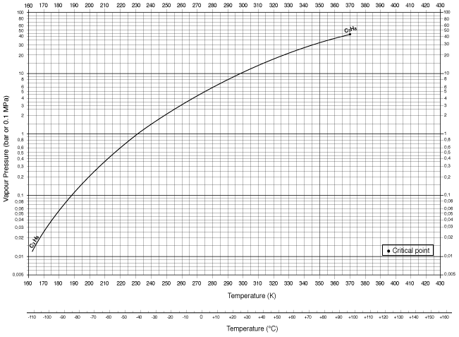

I must be missing a step in the math here.
If I look at that graph for propane, at -20C the vapor pressure is just under 2 bar or 30psi.
How do you get from 30psi to 14 000 psf ? 30psi x 12 x 12 = 4320 pounds per square foot. Right at freezing point maybe double ?

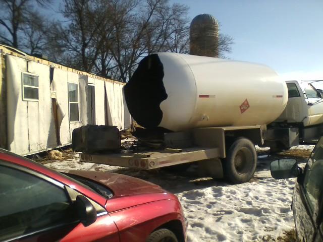

BTW, that is possibly a classic example for a hydrogen embrittlement failure, which caused the WW2 liberty ships to break up and sink in cold water at high latitudes.
Here is something you don't see everyday.
Tank failure of the LP gas truck at East Chain LP. Christmas day 7 AM.
Failure started at the bottom where the tank fastens to the truck. No
fire but the truck was thrust across the road north into the neighbors field.
Initial thrust would have been about 14,000 lb. per sq, ft. Make your own
quess on how many sq. ft. the opening is to finish the math of total
thrust
at the beginning of truck movement. No one was there when it happened.
<img src="http://www.tractorbynet.com/forums/attachment.php?attachmentid=356506"/>
I thought 14k pcf sounded a little high. I guess if the truck was left out of gear, it wouldn't take much to set it rolling however.
That was a forwarded e-mail attachment with the picture from an unknown source......You're correct 'Remarkable Claims require Remarkable Proof'

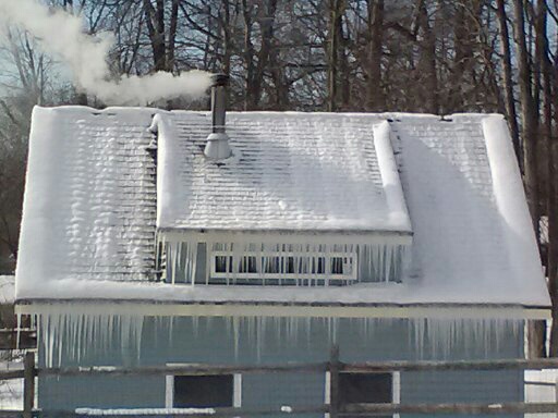

Finally a little warmer today. Pic is of my uninsulated shed in the morning(wed) after loading up the woodstove the night before. -2F outside, 65F inside.LG Lucid pics 082.jpg
