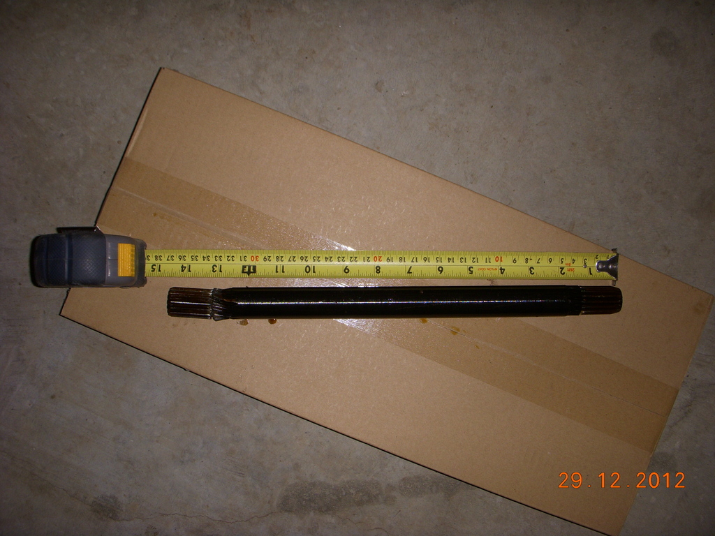

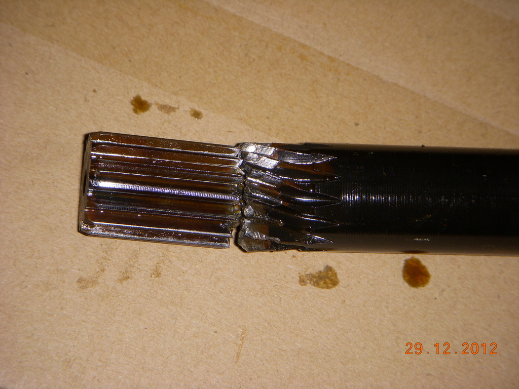

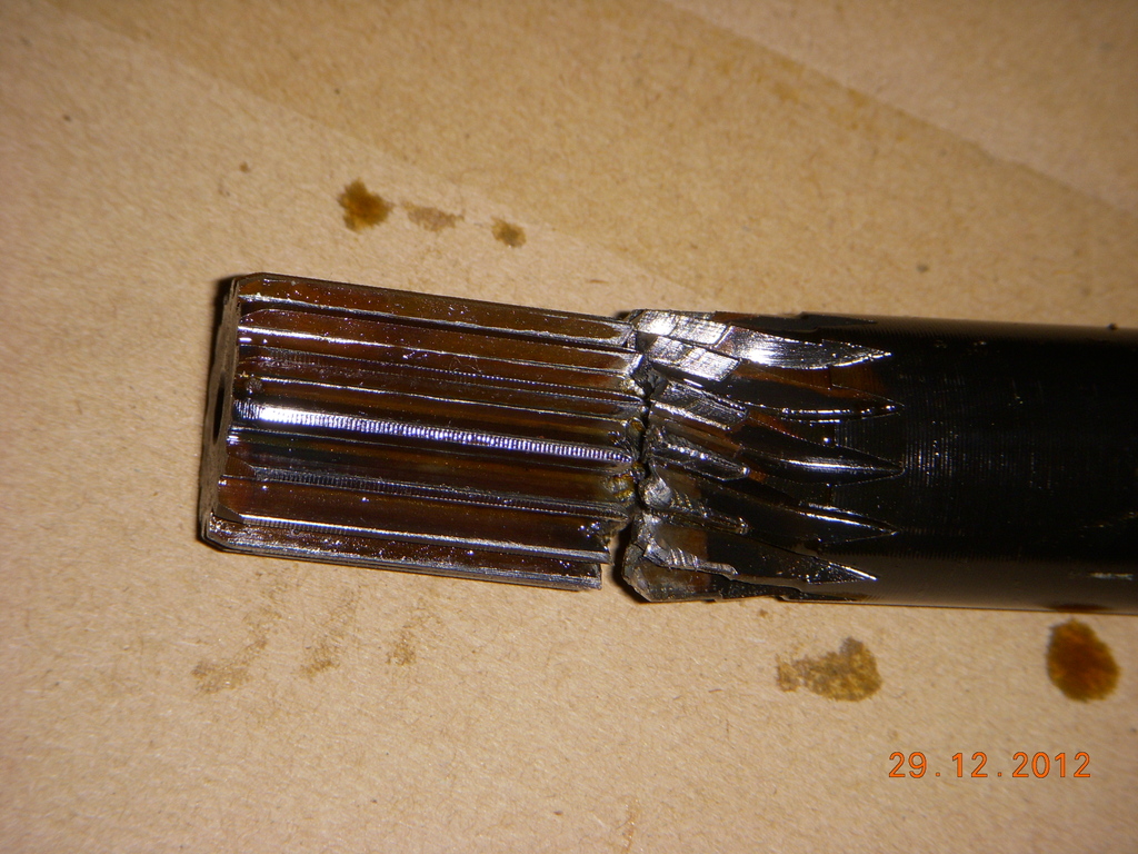

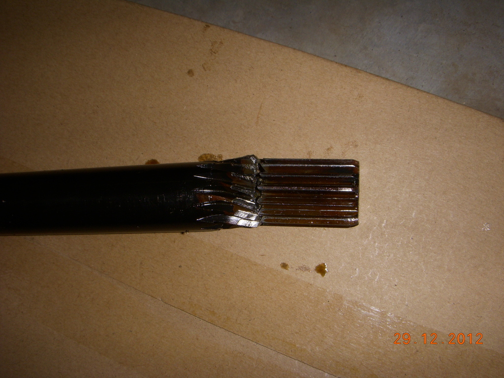

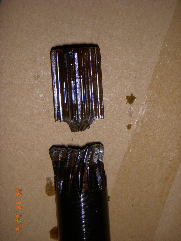

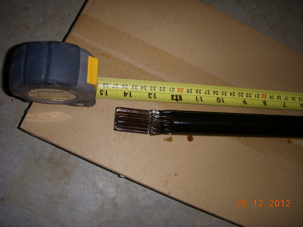

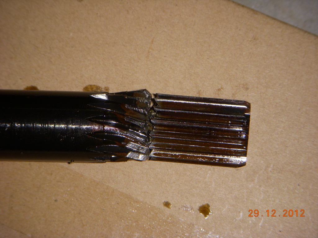

now here the other piece missing from the shaft yesterday (i just fixed my camera, had the wrong time in it, that's why its showing 29 for the date)
that's it for now, im in canada, so i guess ill get the parts somewhere in the middle of january, ill update the thread as it goes...
AND do you guys think i should open up a new thread about the differential lock problem when i get there ?

Hi guys, I forgot to take picture of the repair process, but I manage to clean all the parts in a washing solvent tank (filled with diesel). the 4x4 is working #1 now, took me about 10 hours with most of the time washing the parts/cleaning old gasket.

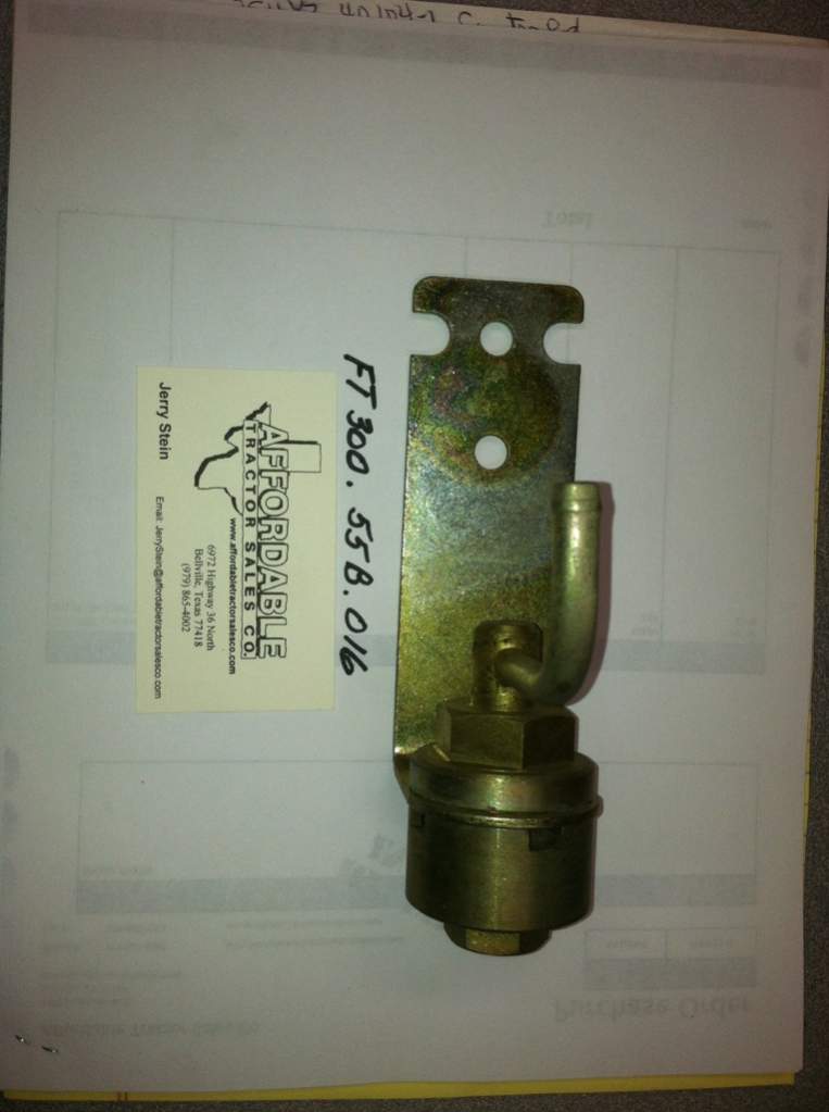

just so you guys know, I also ordered an upgraded sediment bowl. I was talking about all the parts I had just received and my cousin was here (his job consist in repairing diesel welder), when he saw my super "Upgraded sediment bowl", he start laughing at me and pointed out the part was just a regular Sediment Bowl off a lincoln Diesel Welder he could brought me for about 20$, the Lincoln Sediment bowl is really better than the Stock Jinma one, I'm just disapointed I had to pay to find out it was cheap and available locally.
Now I have to resolve the Hydraulic breather trouble.
