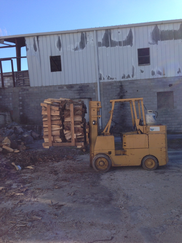

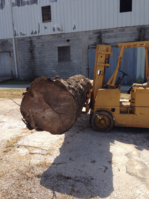

Loading by hand sucks. When my tractor can't lift it it's time to bring out the big guns. image-3227385281.jpg image-3221011182.jpg In the past when I didn't have a forklift available I just grabbed an empty pallet, and hand loaded some of the load on it.
