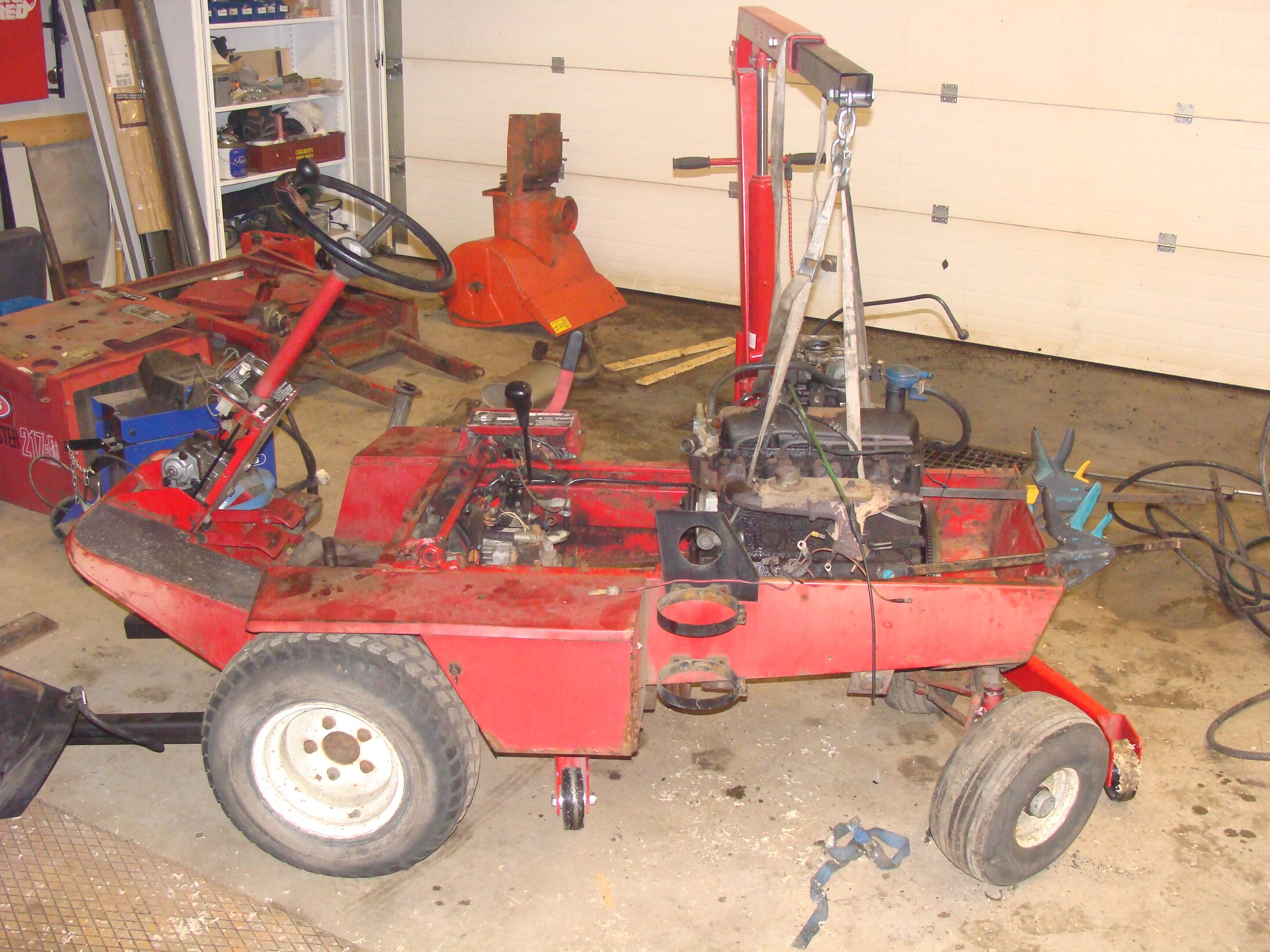

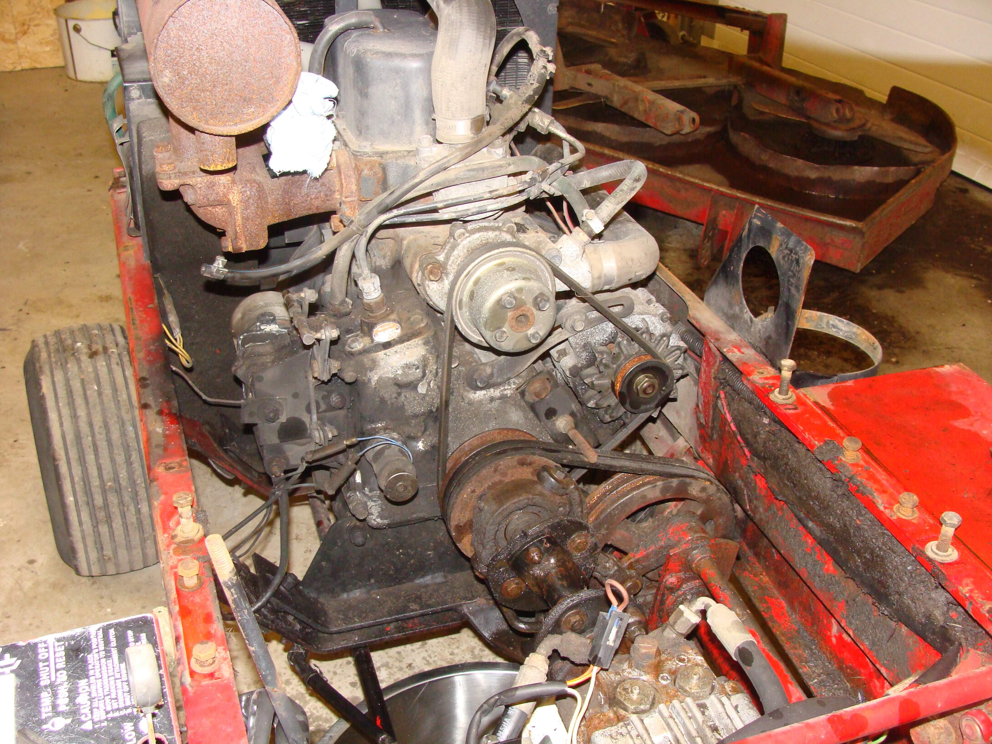

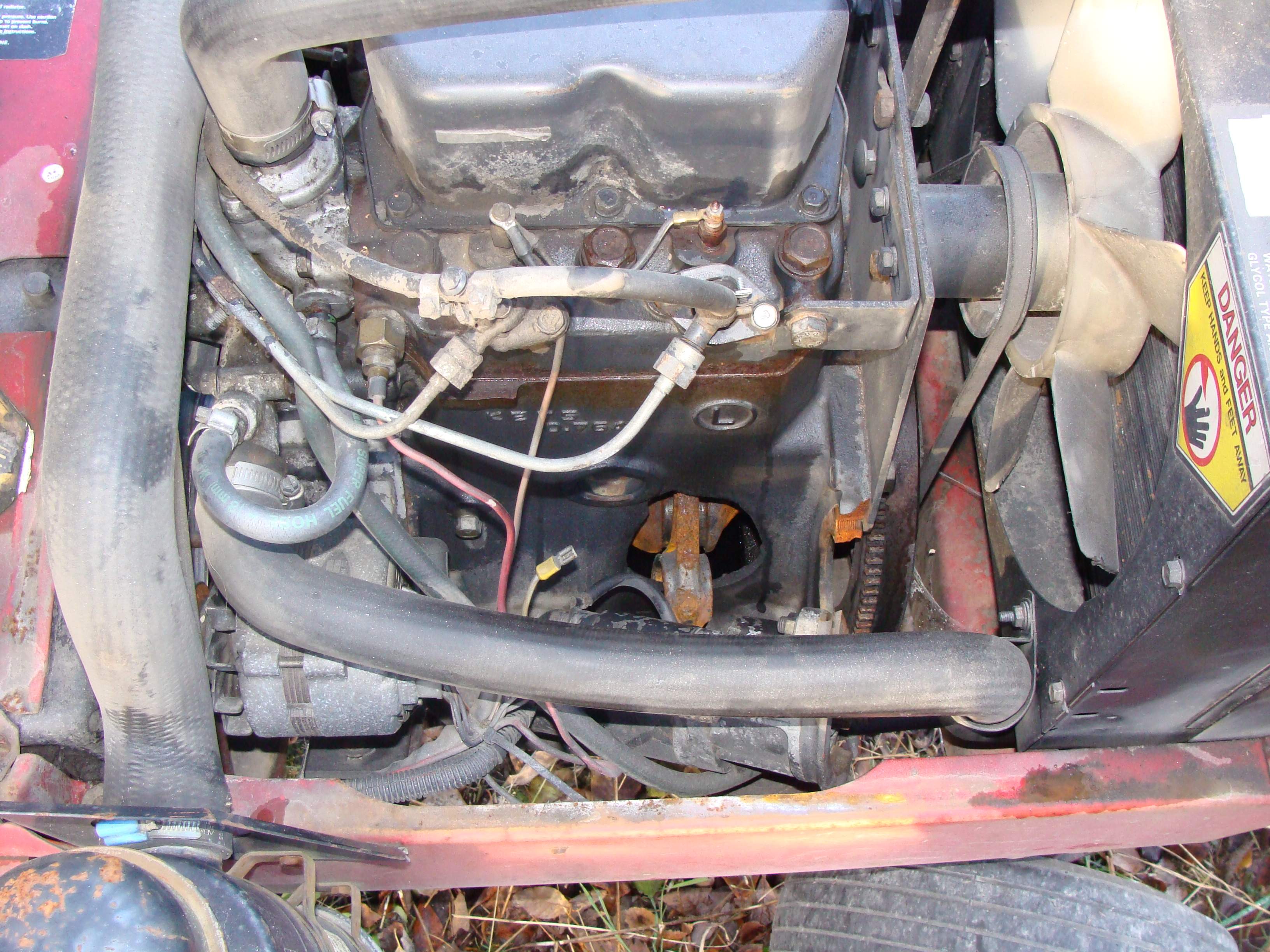

I bought a TORO GROUNDSMASTER 217D with a minor problem. A connecting rod had punched a hole in the engine block.
I took it apart.

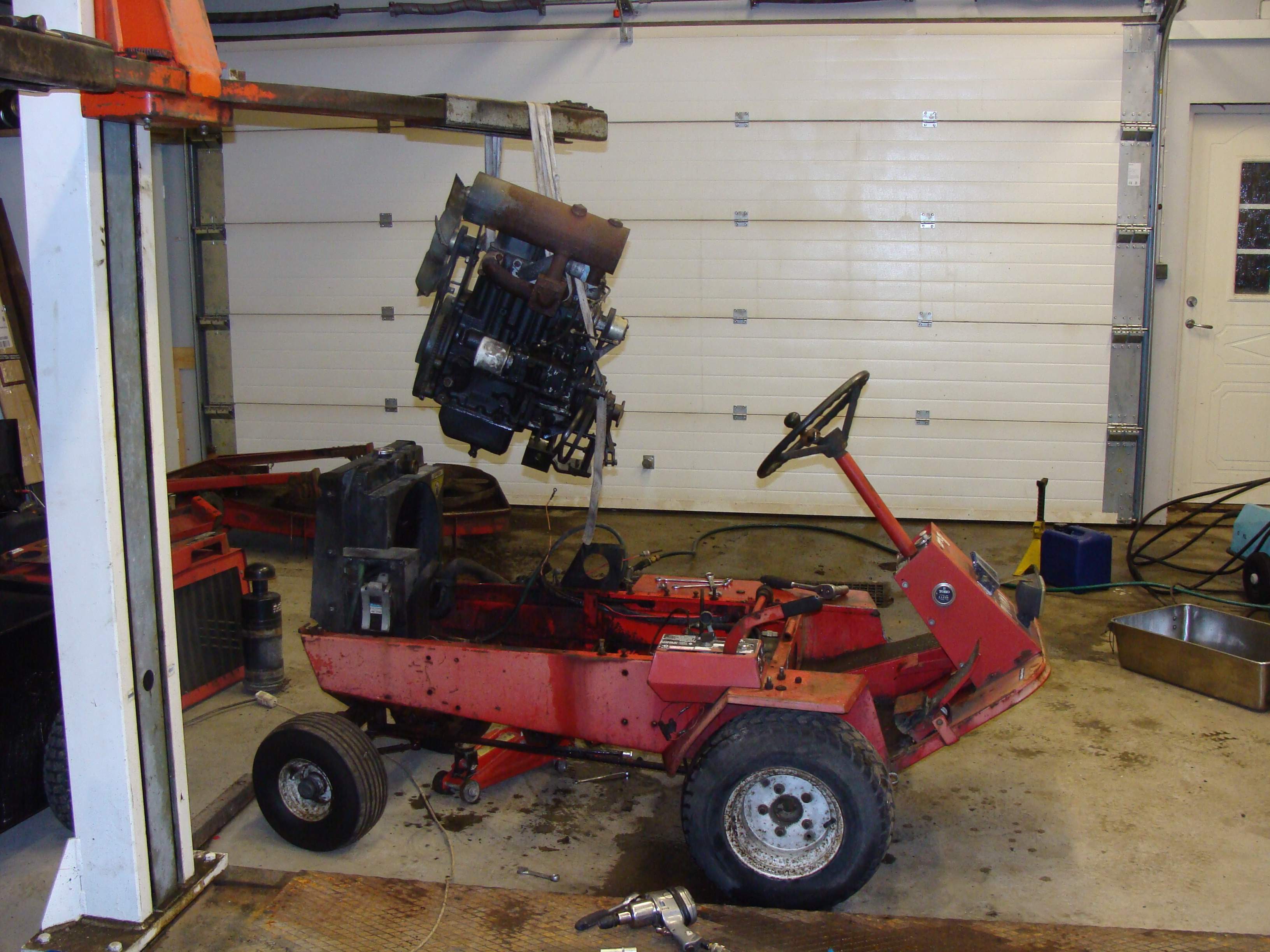

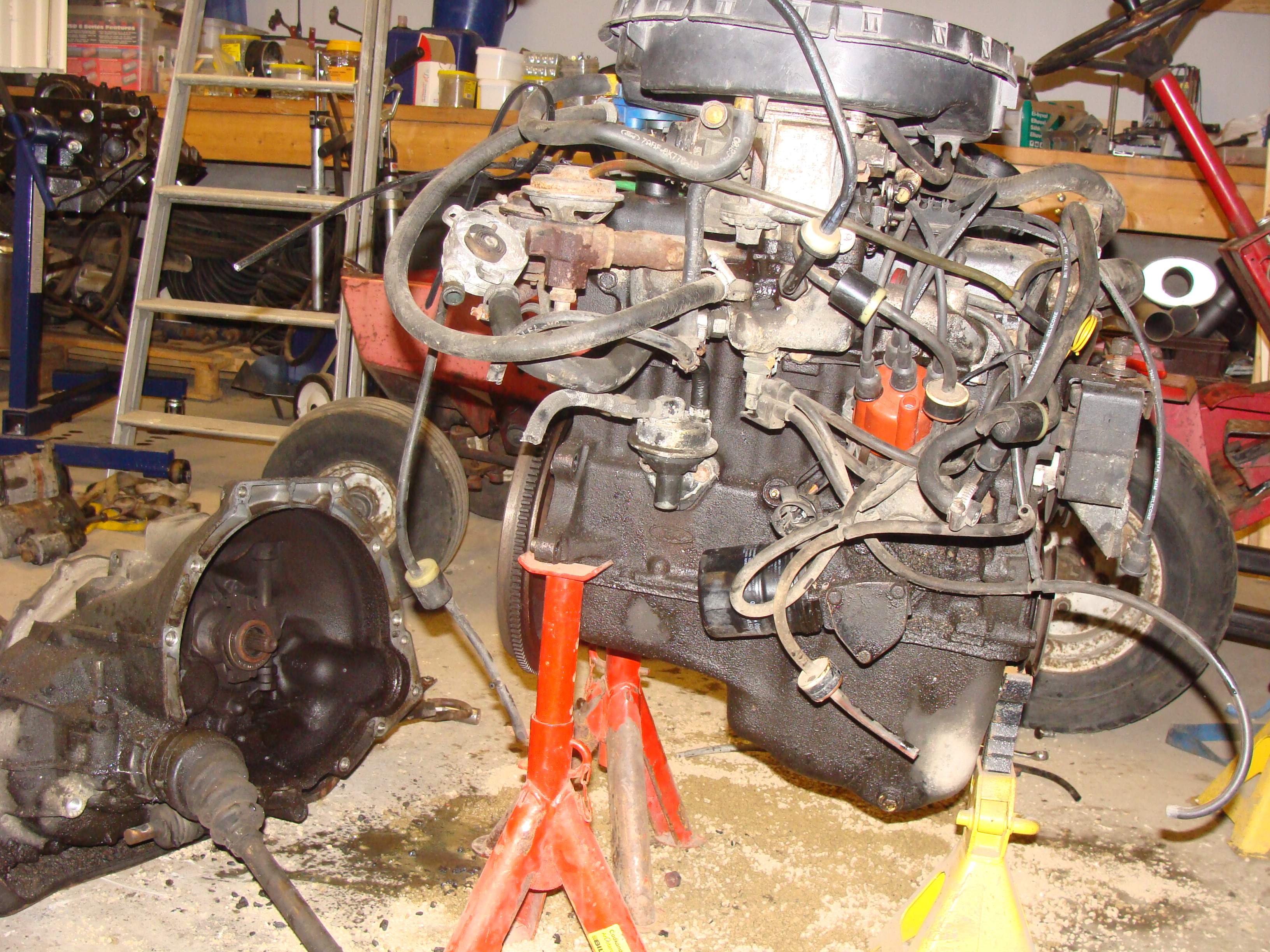

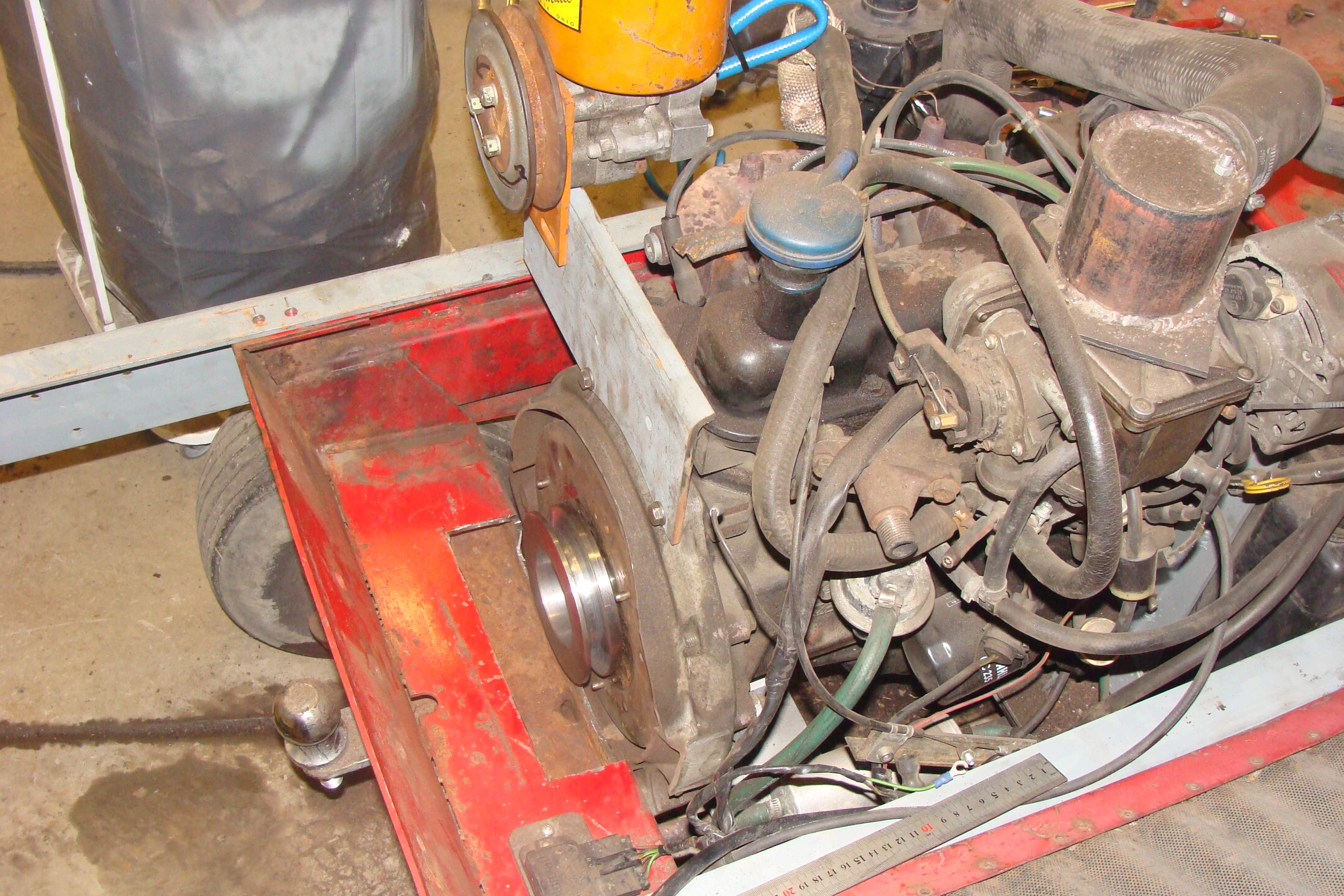

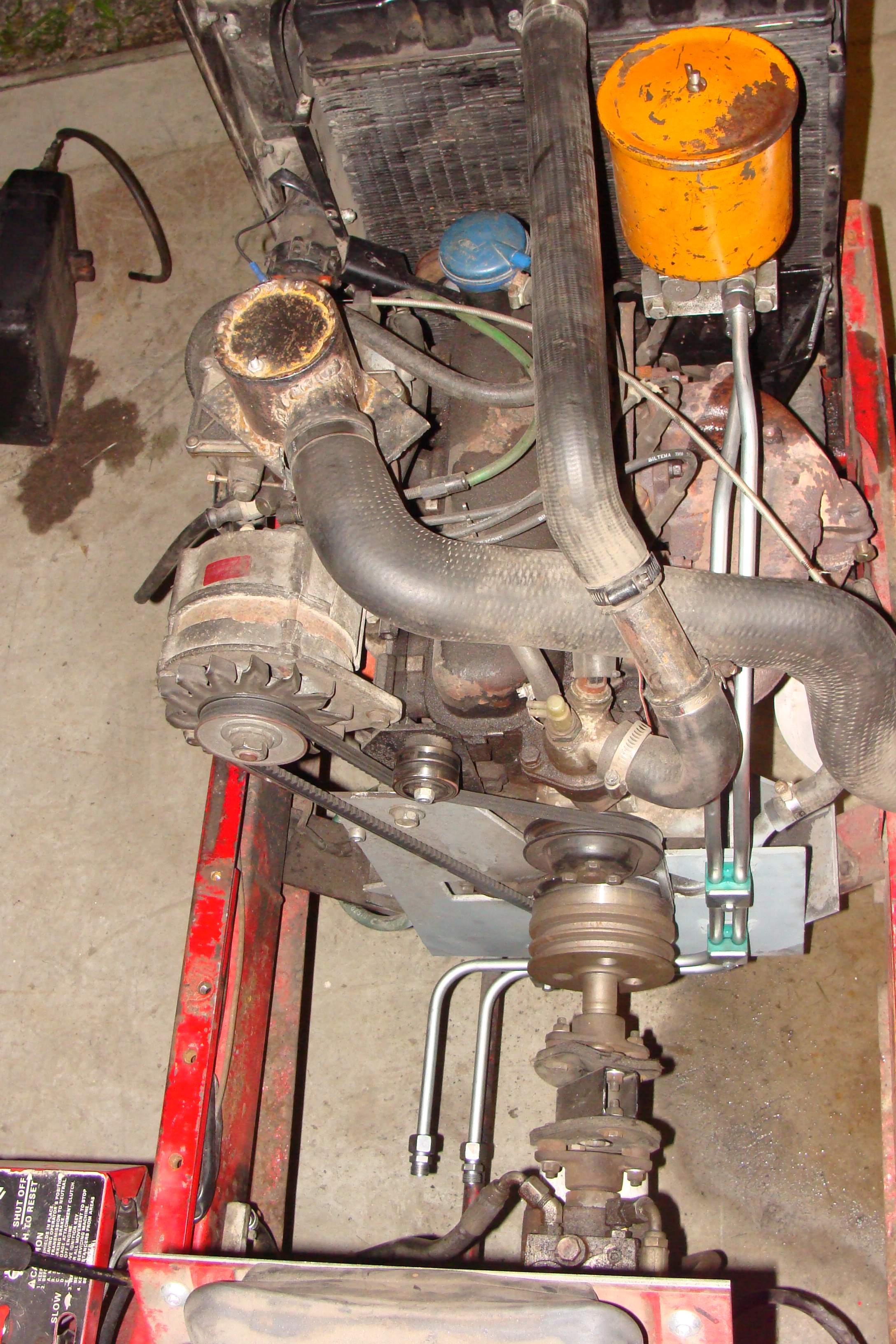

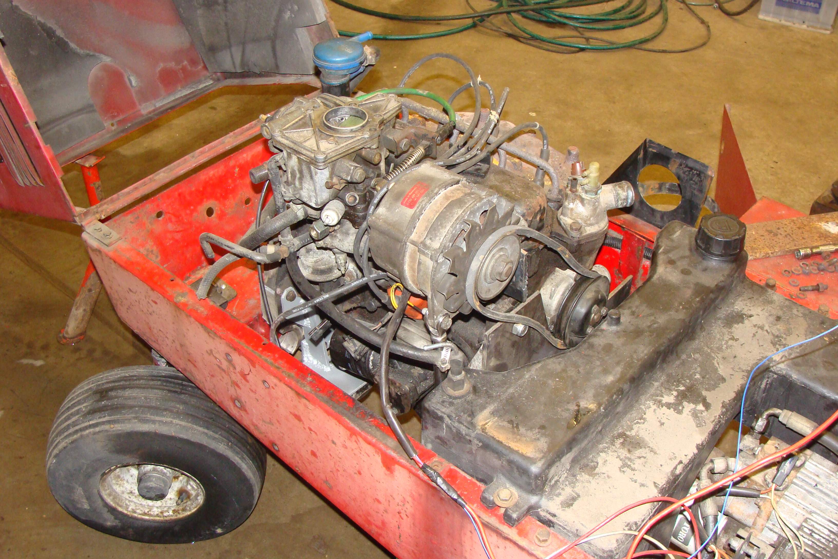

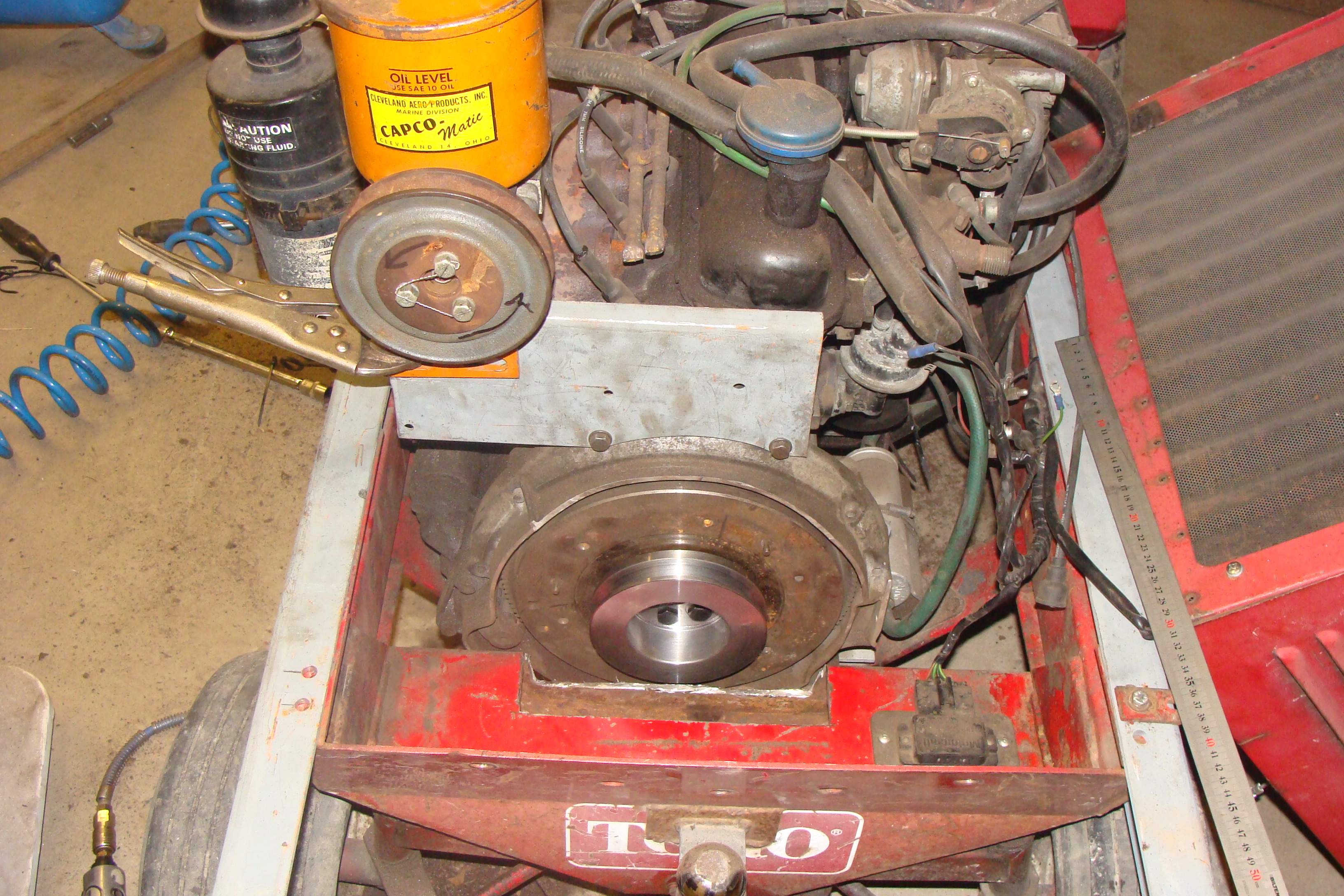

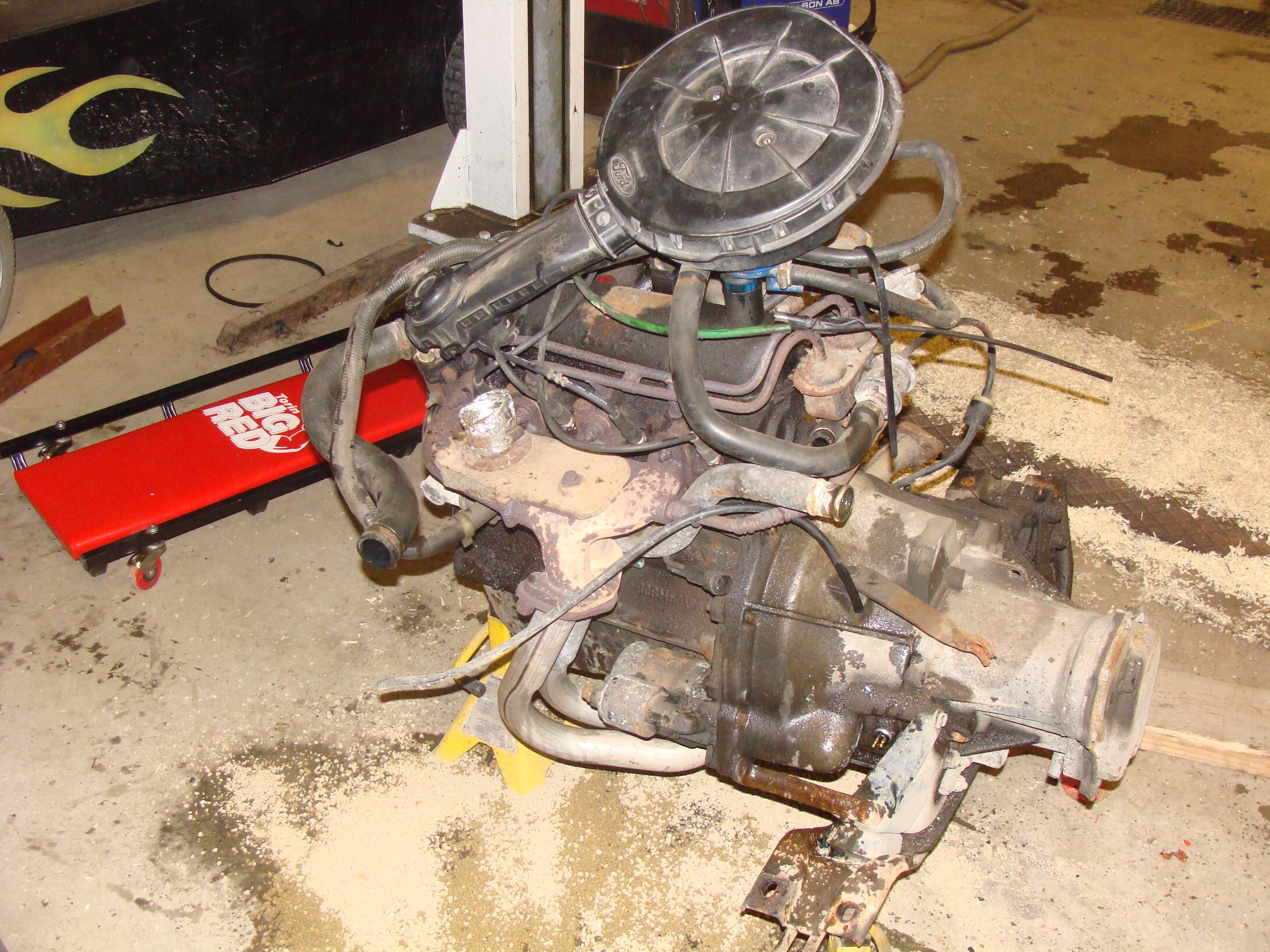

After searching for another engine for a while I finally found a donor vehicle.

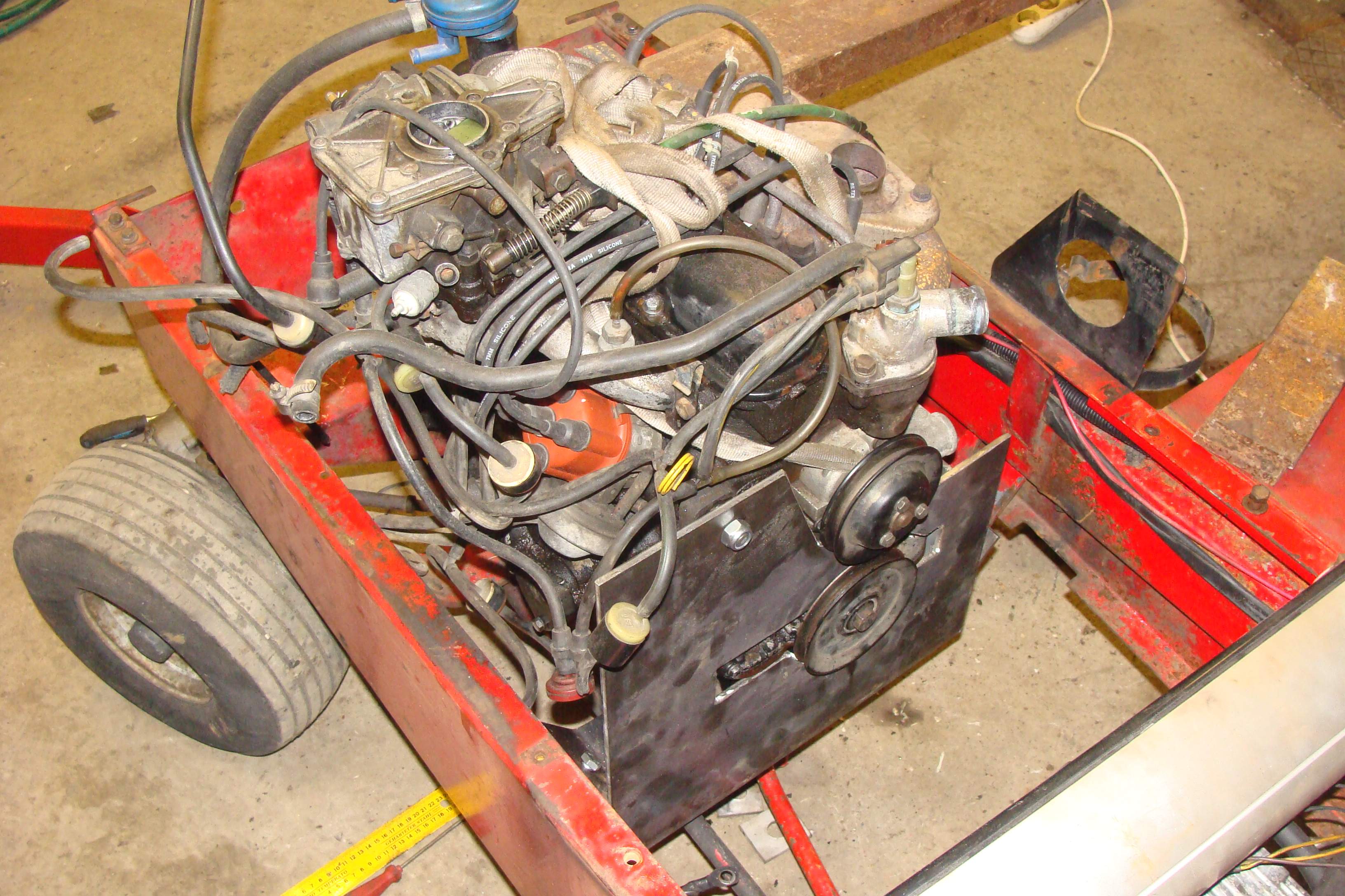

The Ford engine was only 4cm ( 1.5 in ) longer than the 2 cyl Mitsubishi diesel.

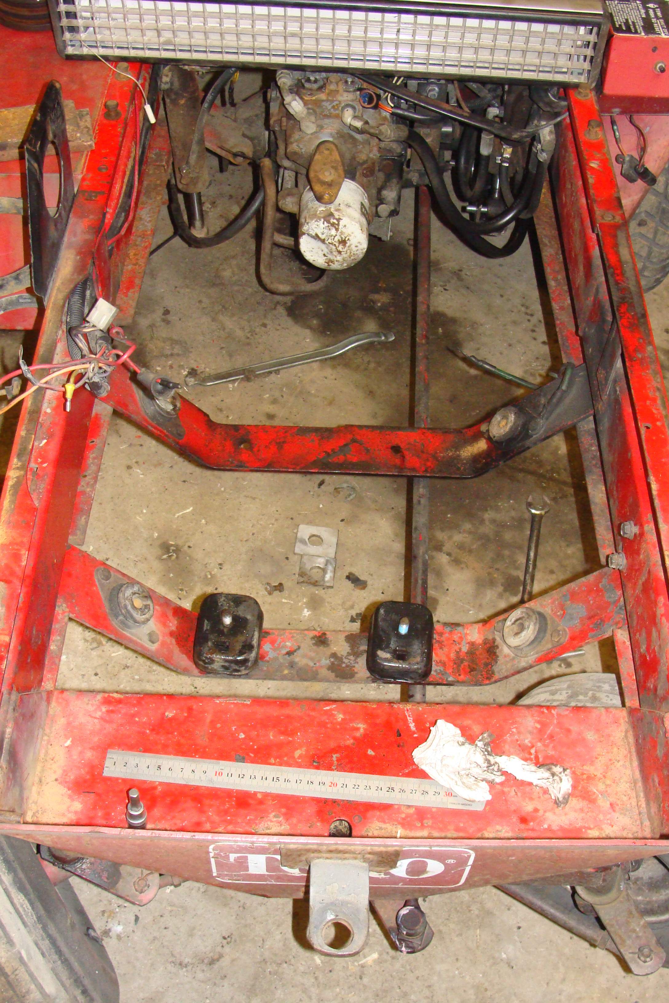

   / It was a TORO GROUNDSMASTER 217D

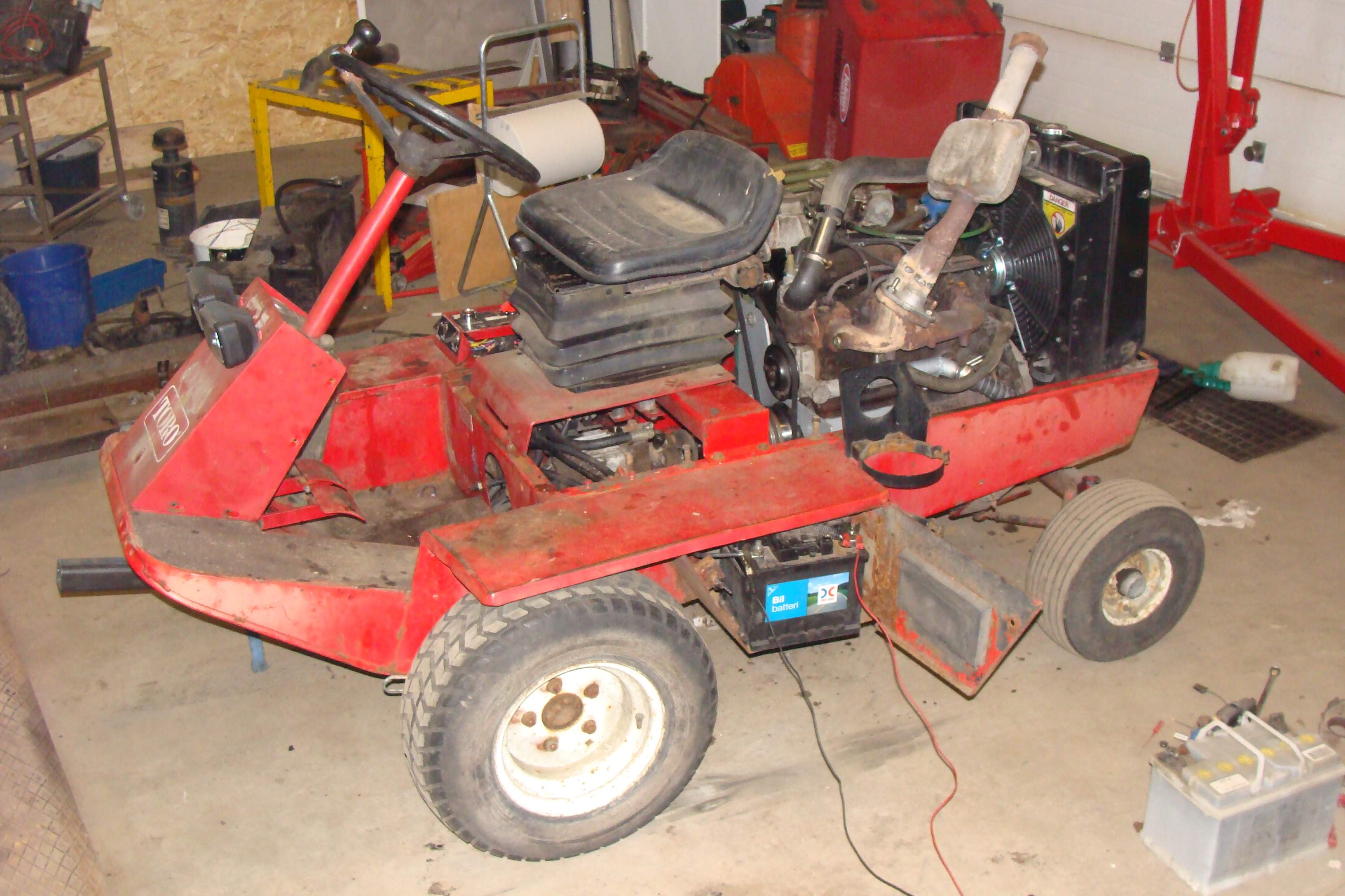

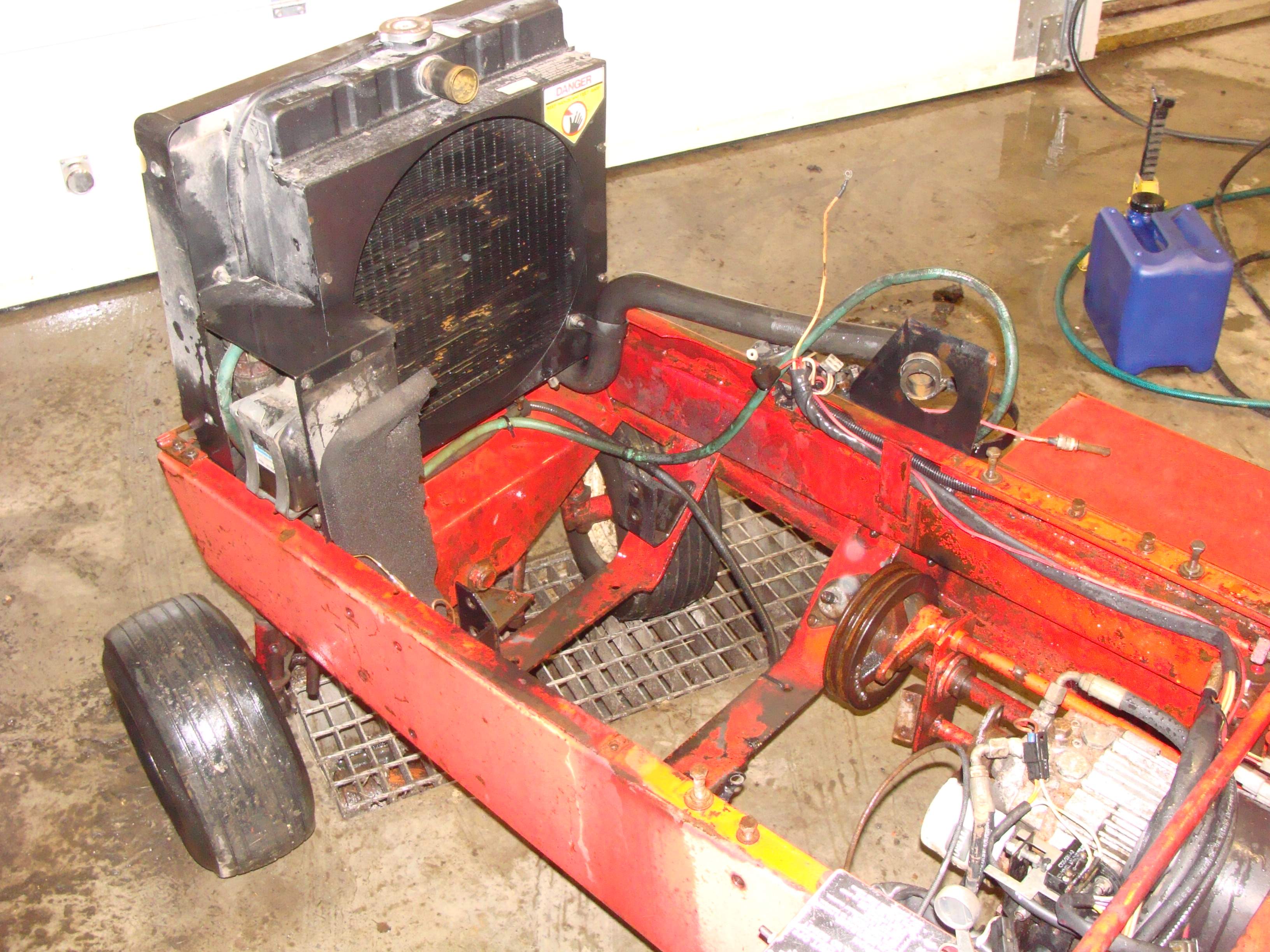

Fabrication starts ...

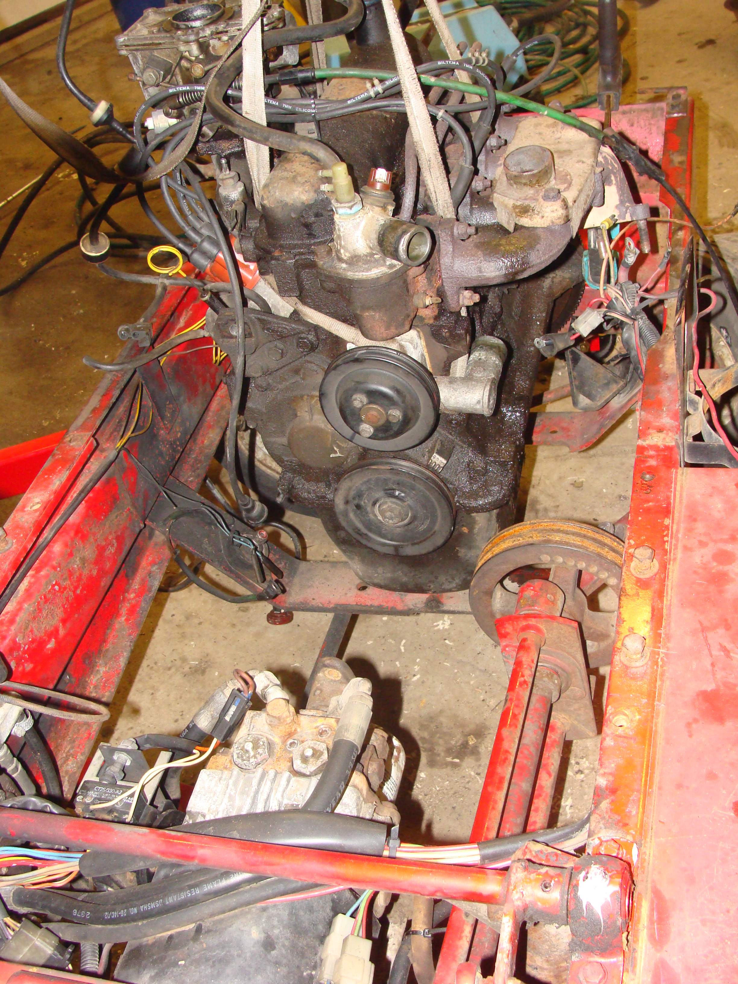

I removed this box ...

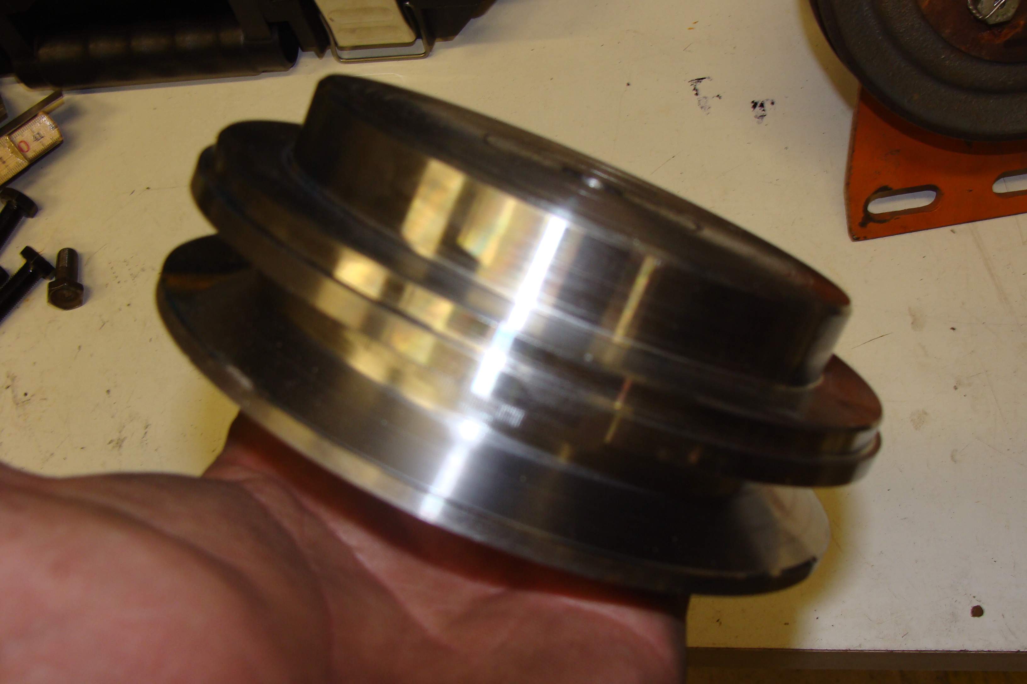

I had to find a new place for the alternator.
A new custom pulley that bolts to the TORO pulley.
And it is running again!

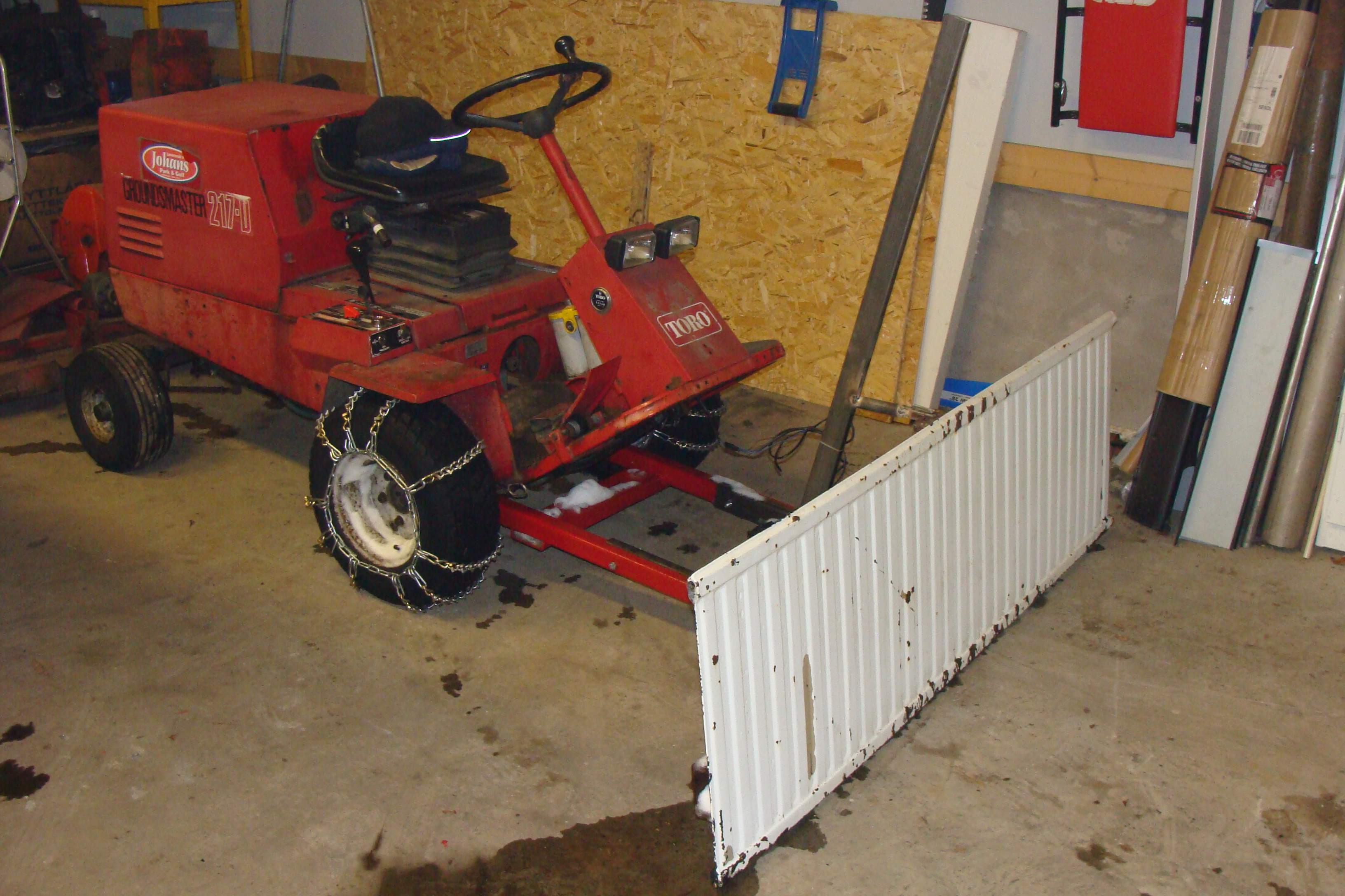

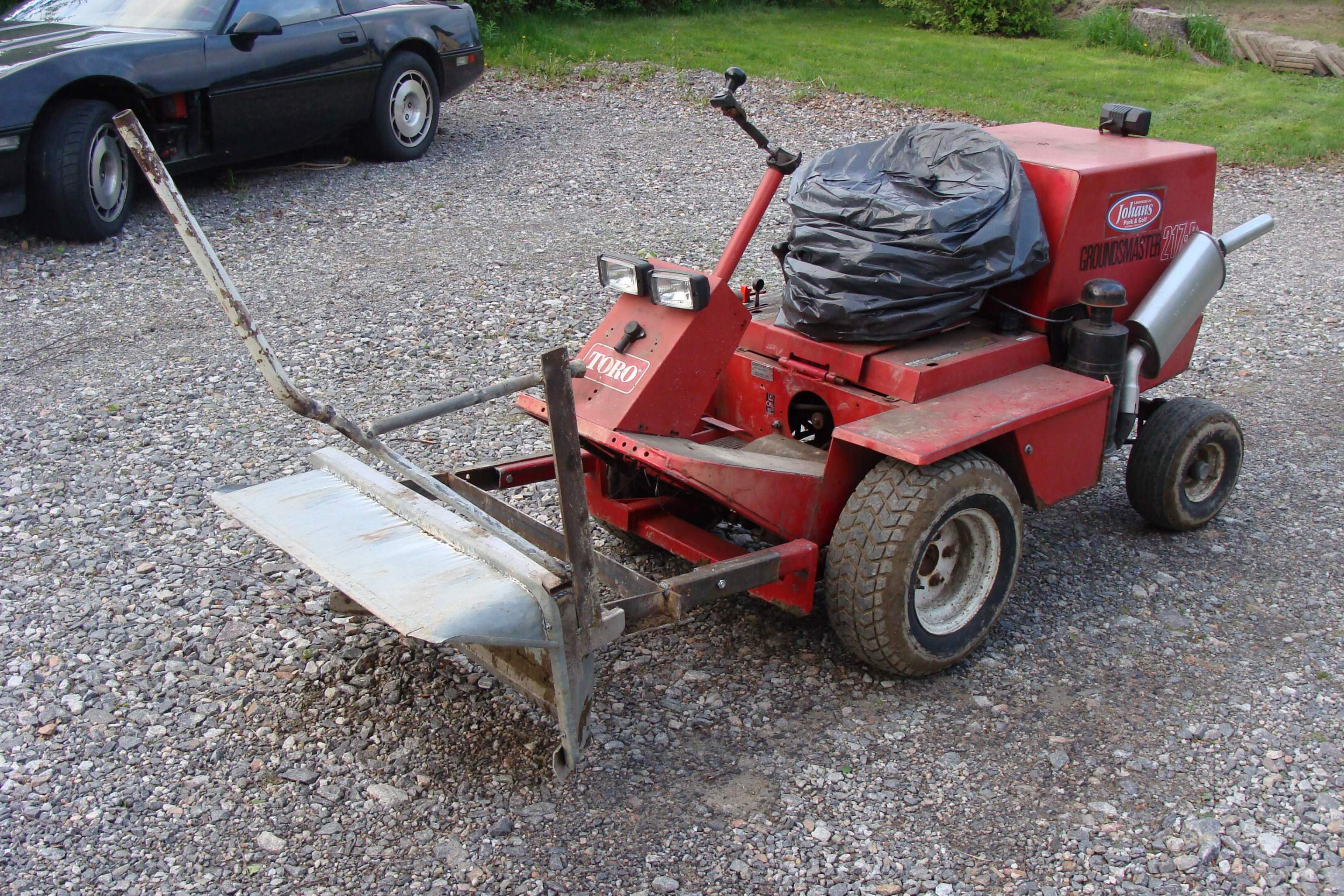

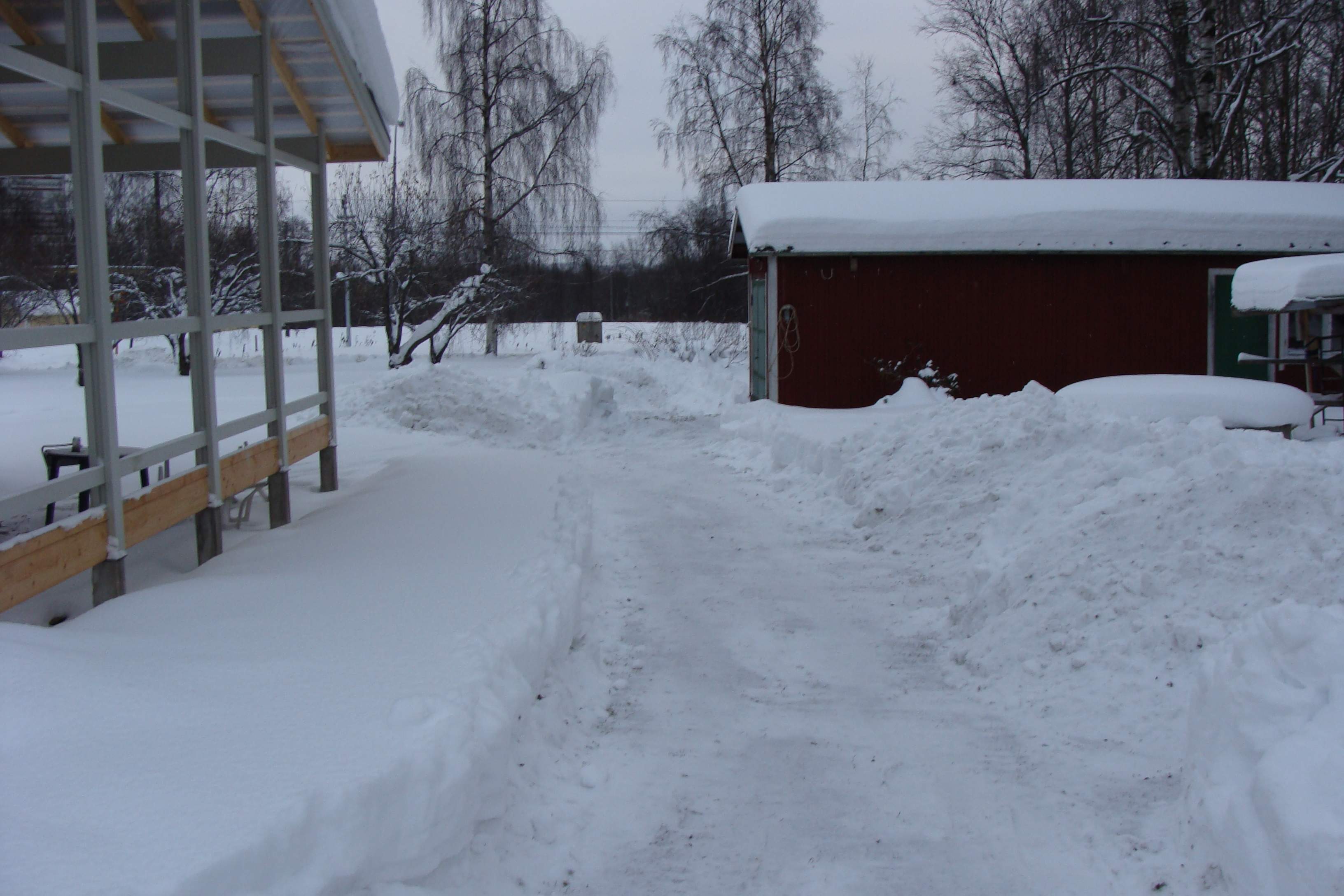

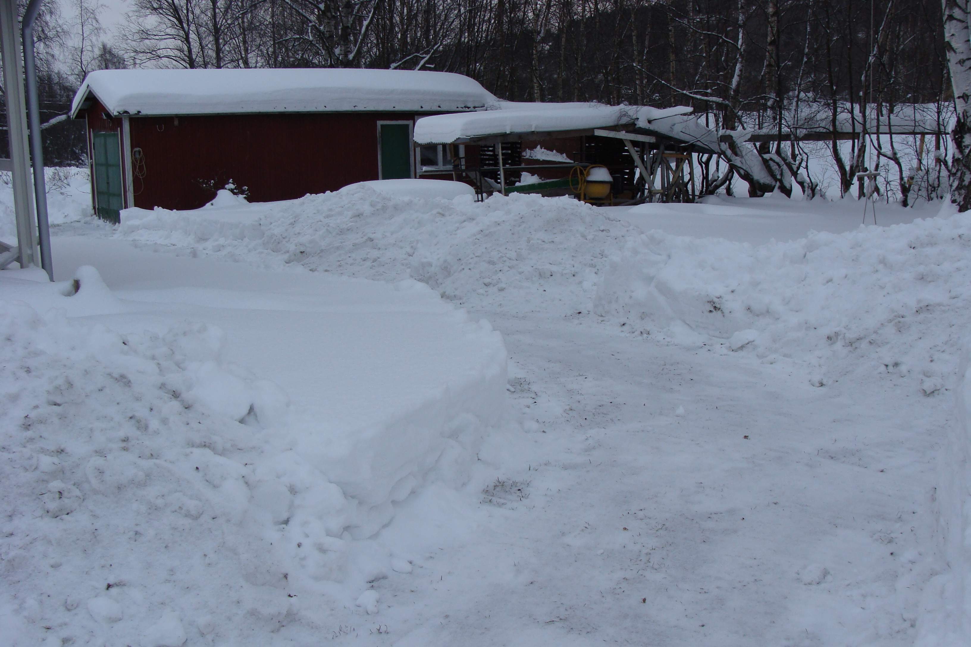

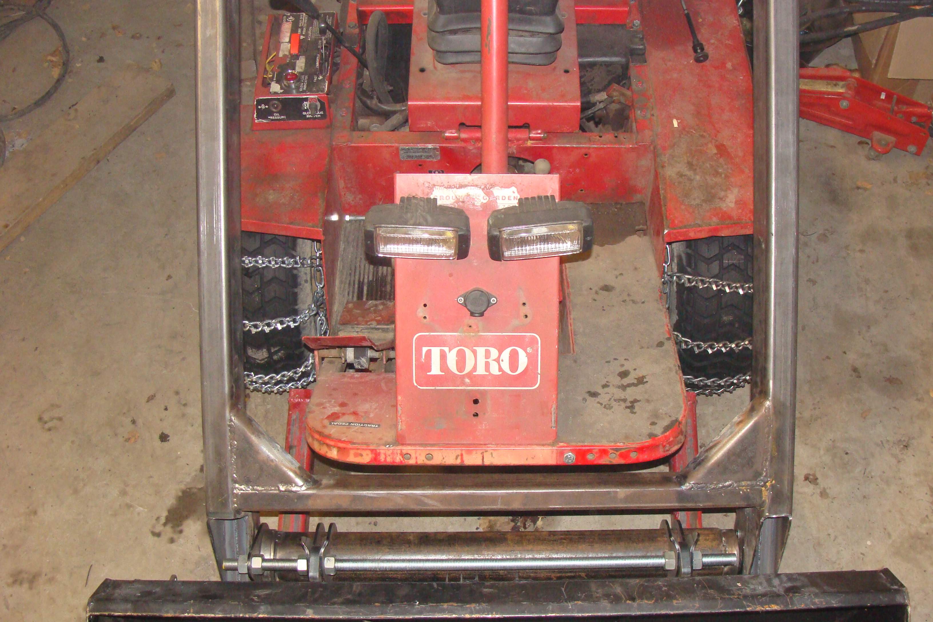

It started snowing so I made a simlple snow plow.

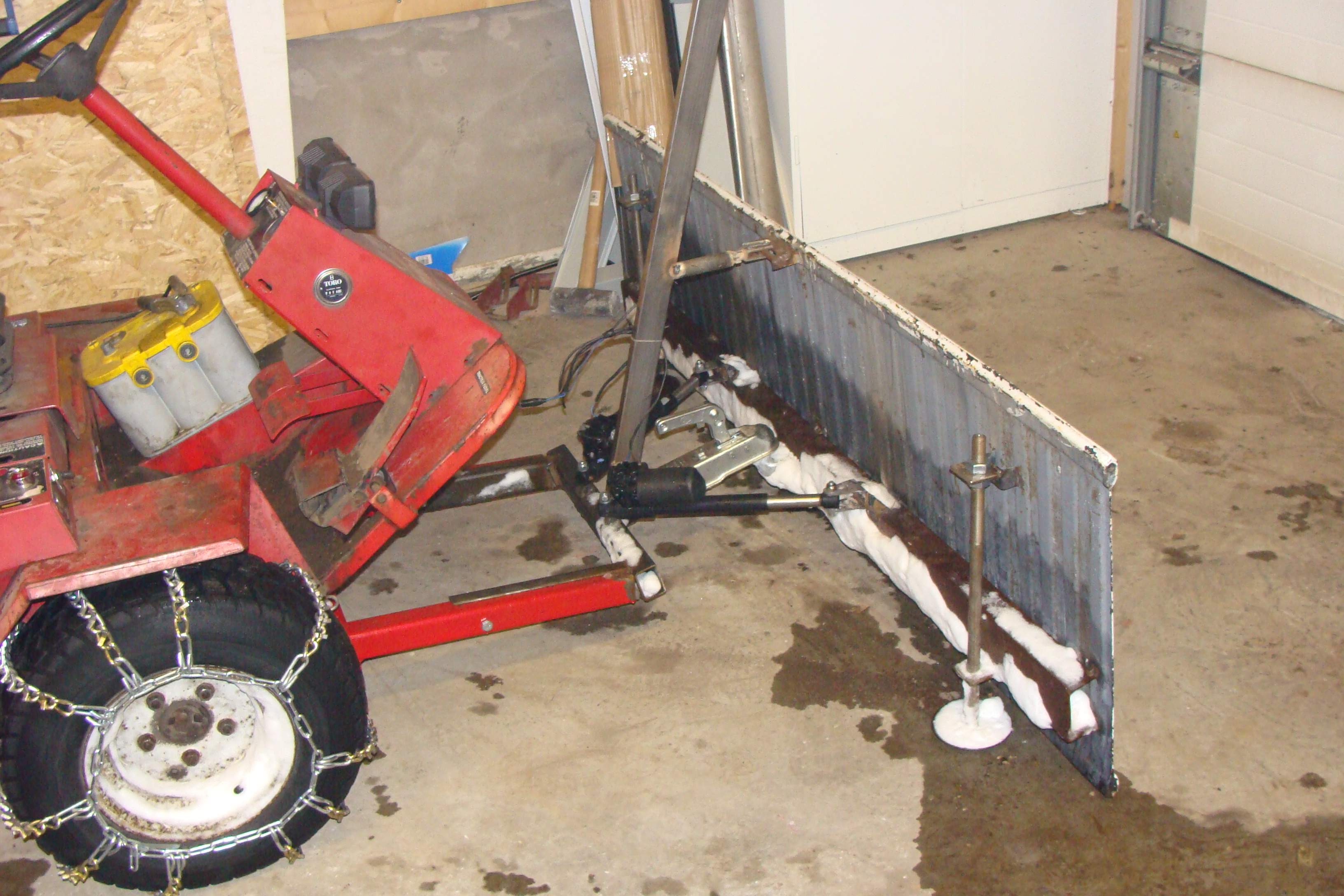

I had an old radiator and decided to make a slightley more serious snow plow from that. I used electrical actualtors to turn the blade.

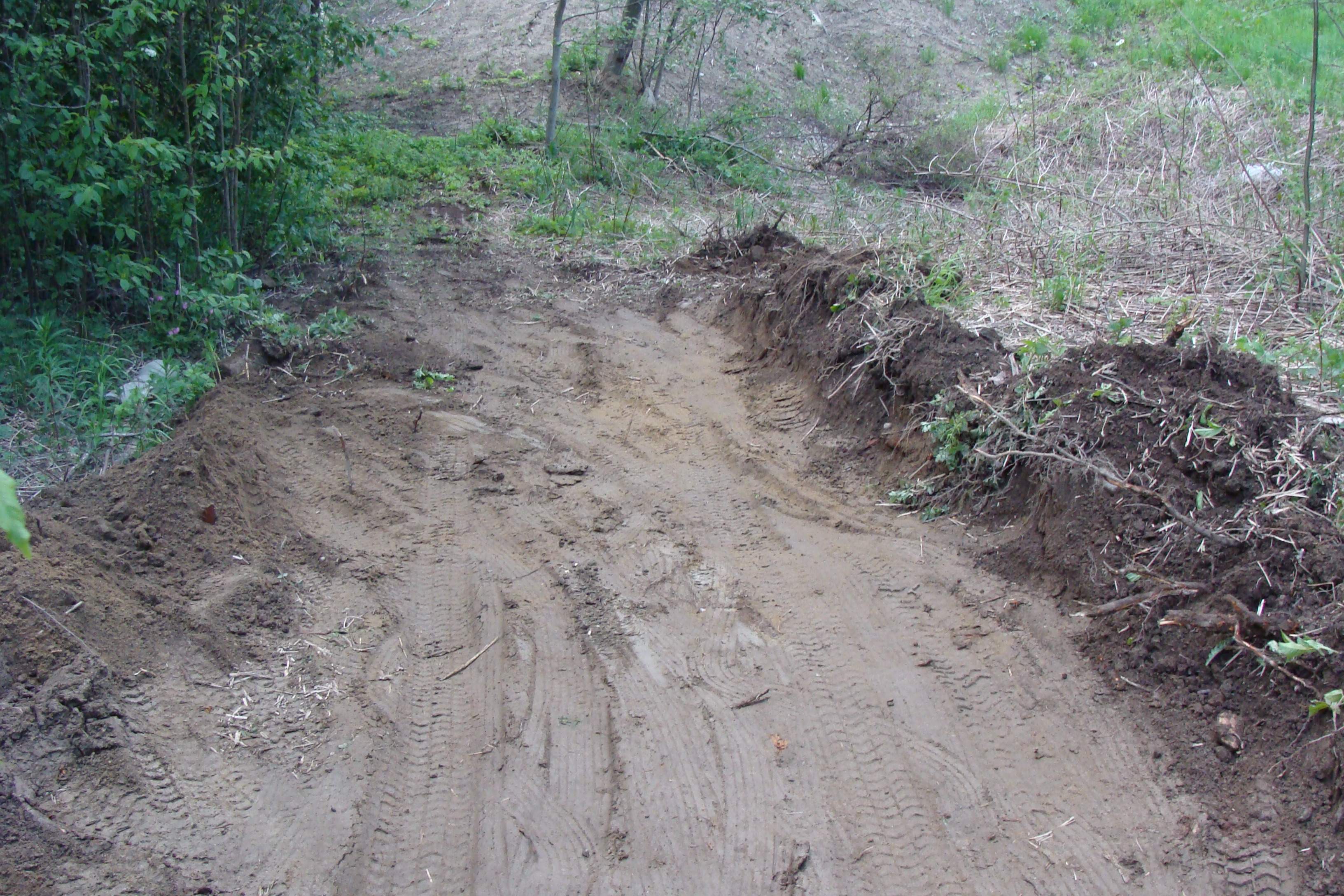

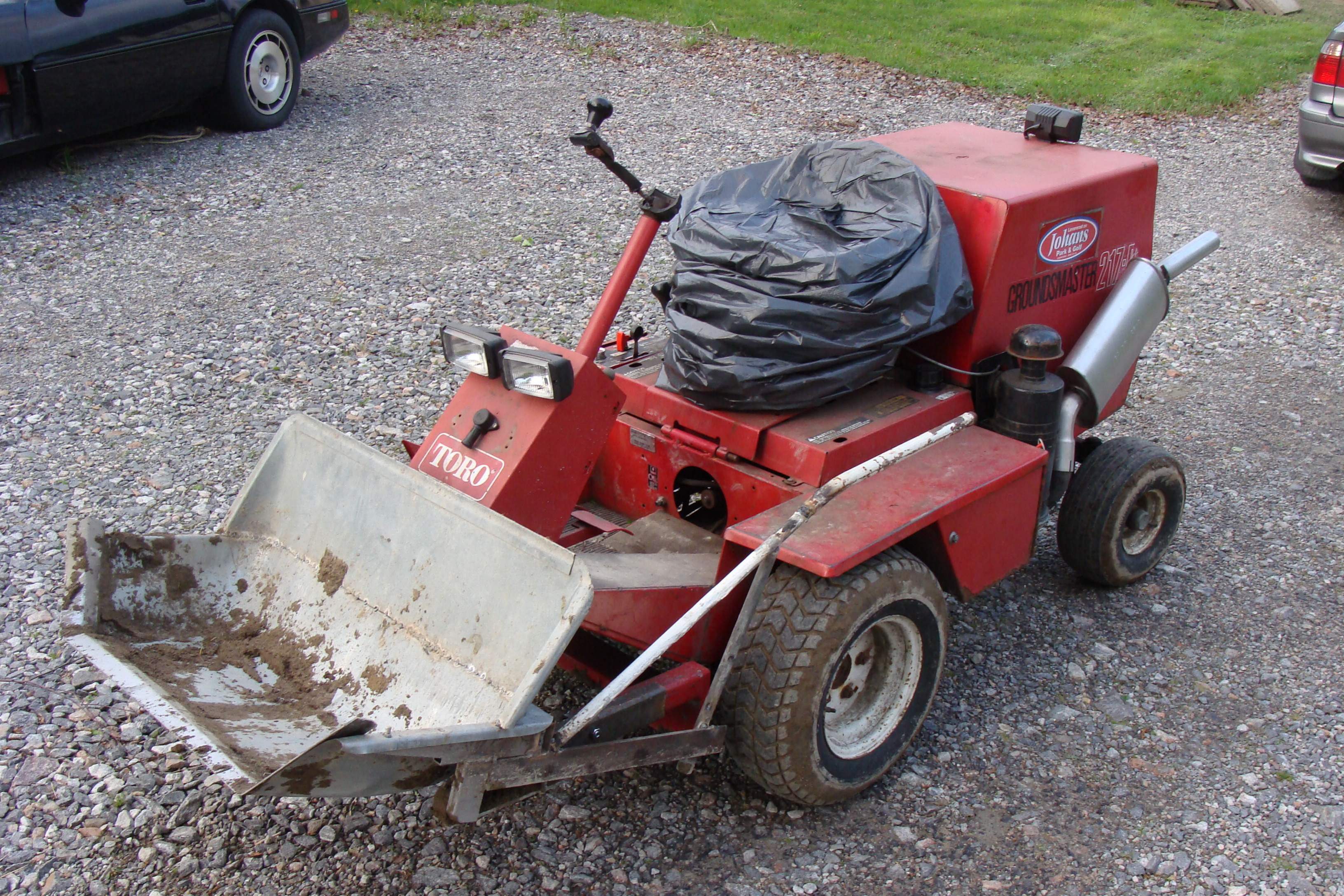

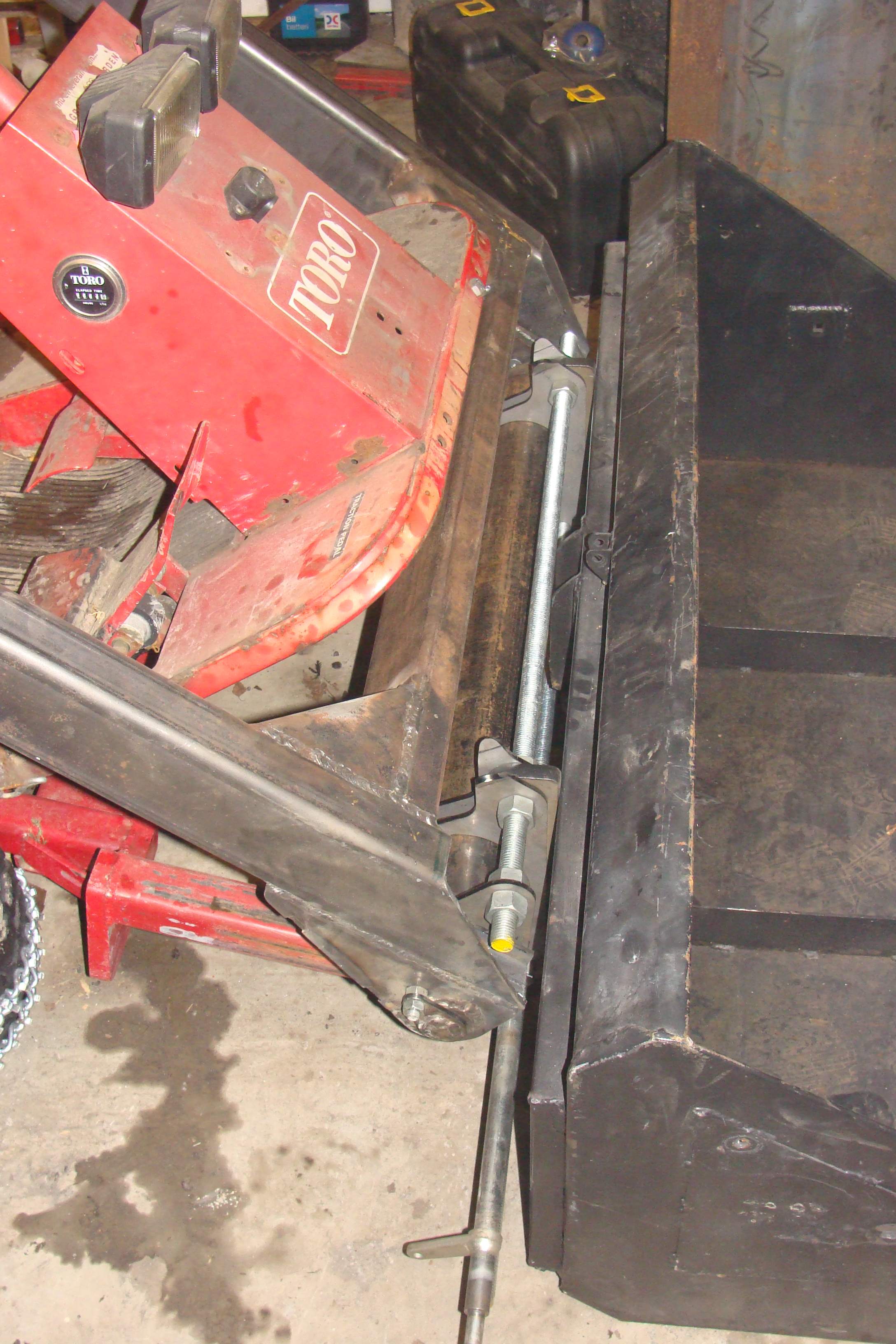

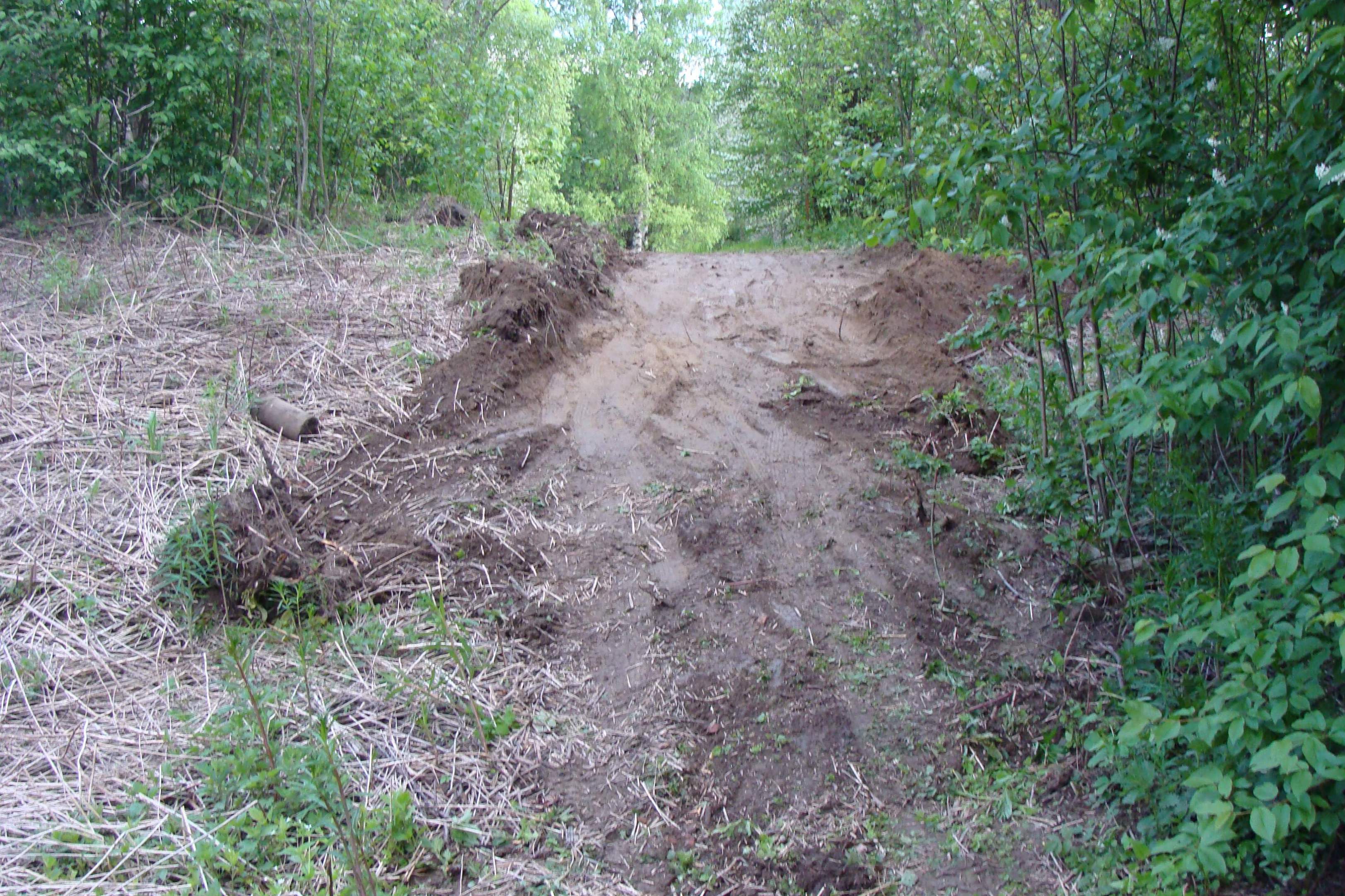

Summertime and I needed a wheel loader instead. Very simple but it was much better than digging by hand.

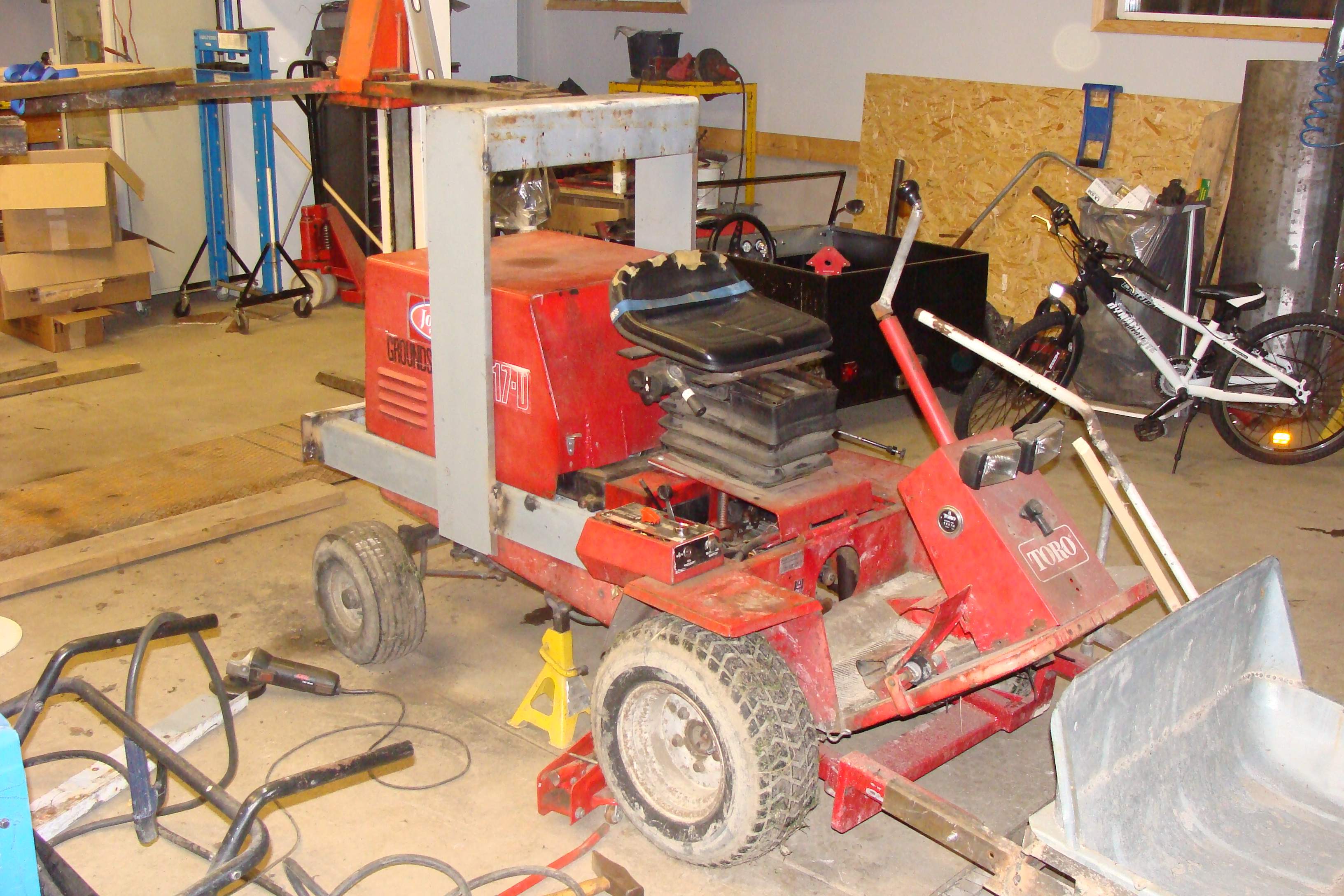

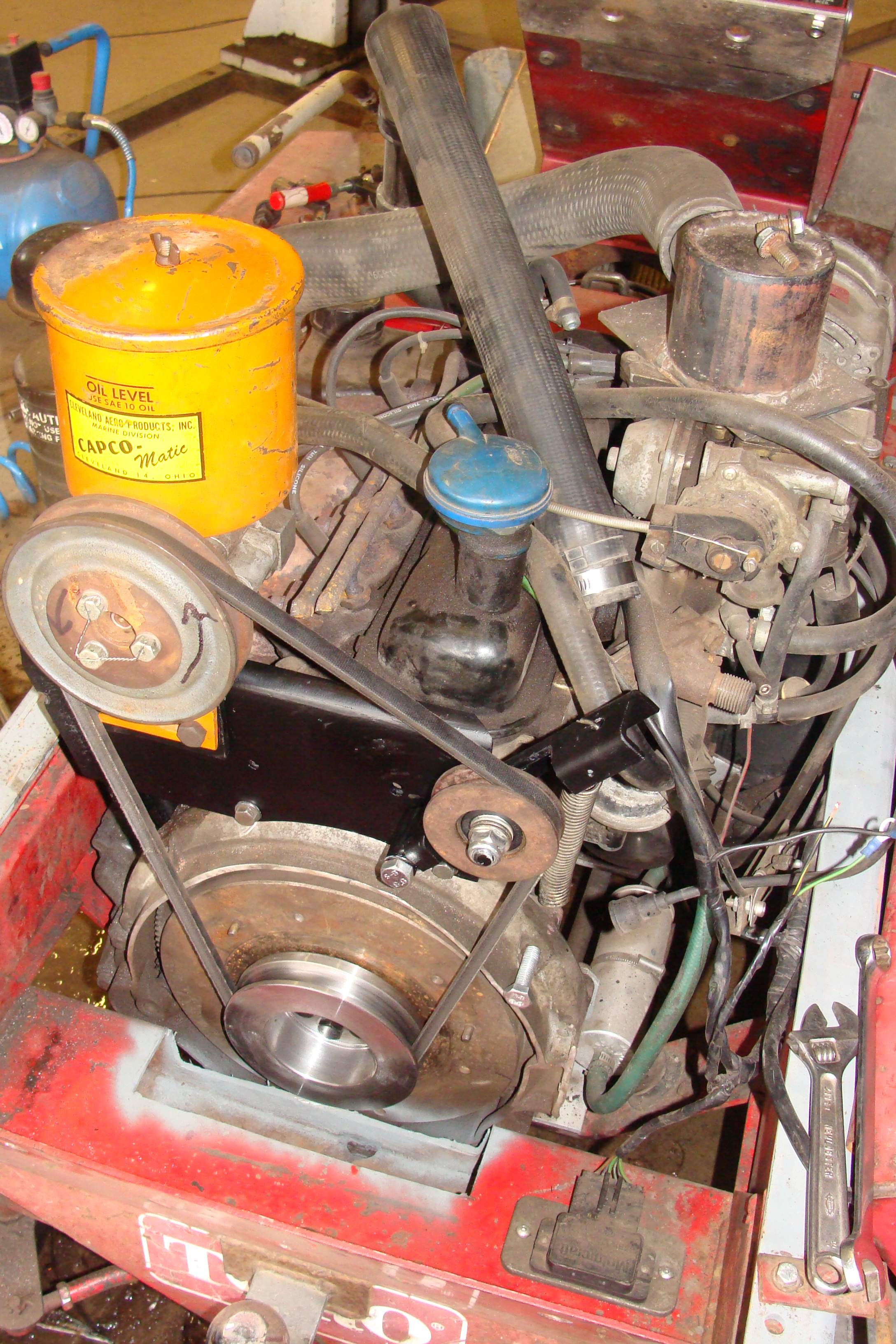

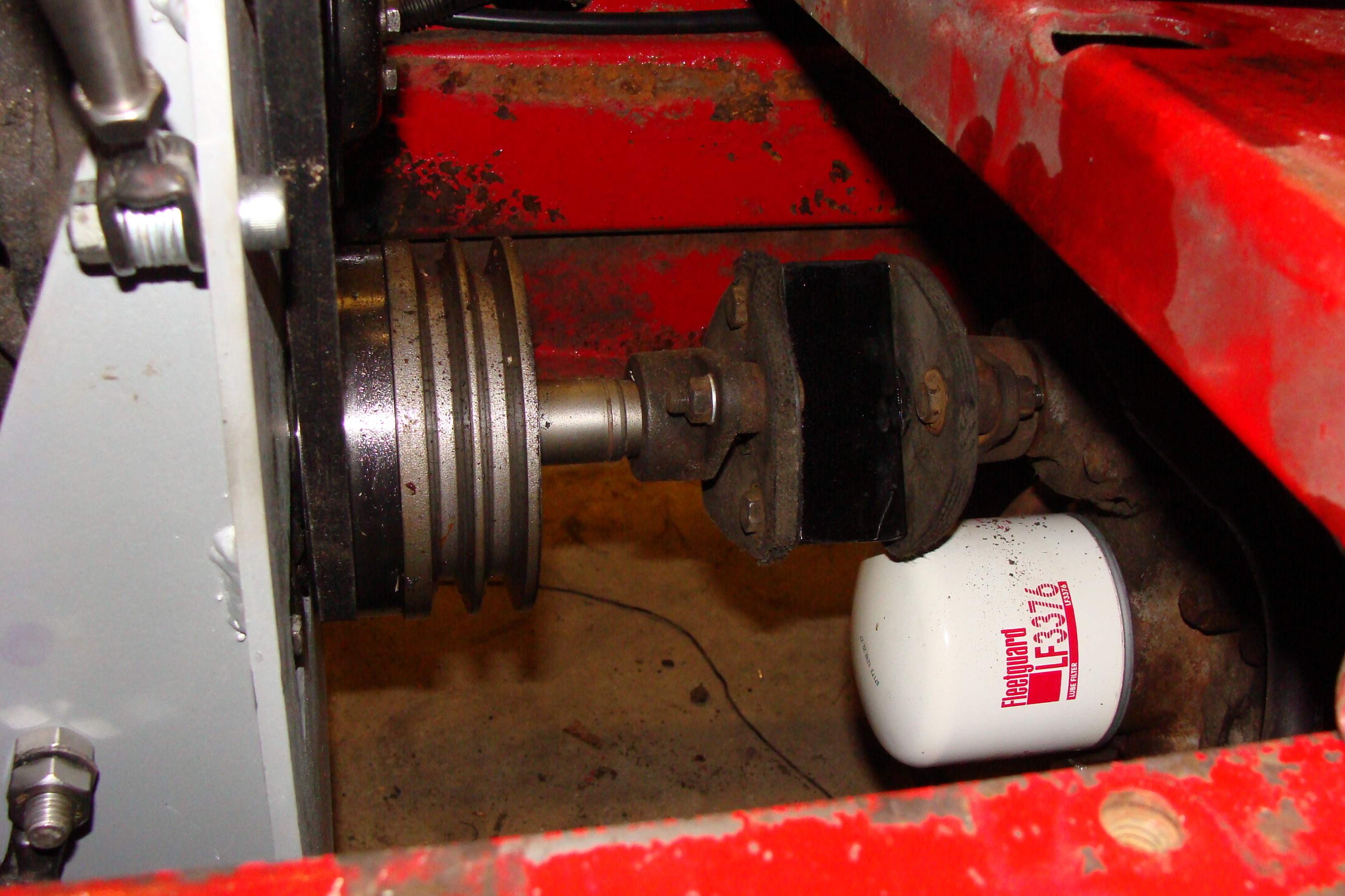

Well, it seems like it want's to be a wheel loader ... time to get serious
An hydraulic pump, and a new pulley on the flywhleel.

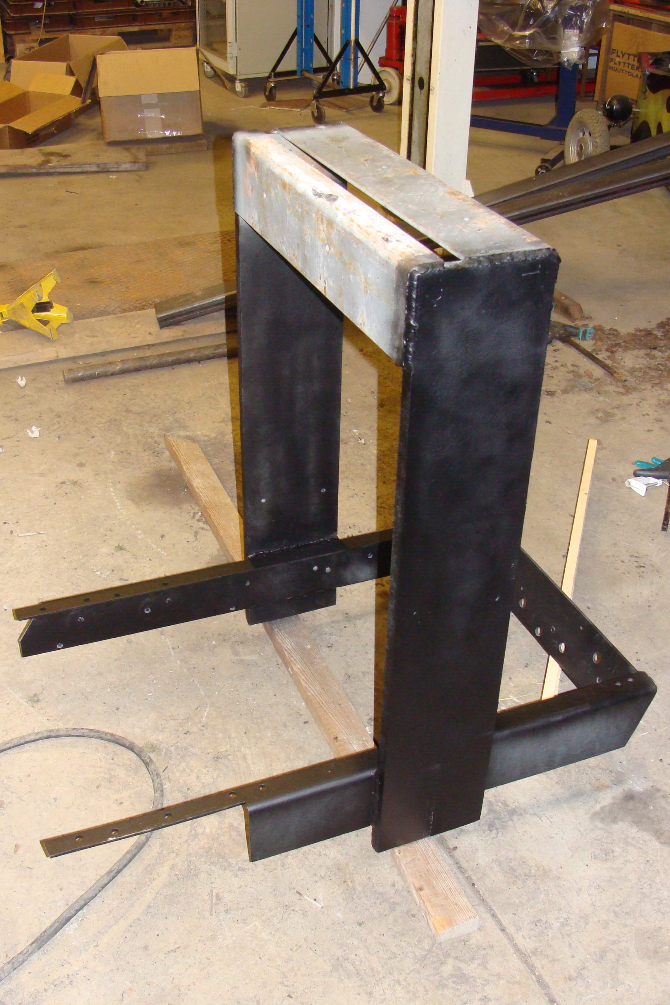

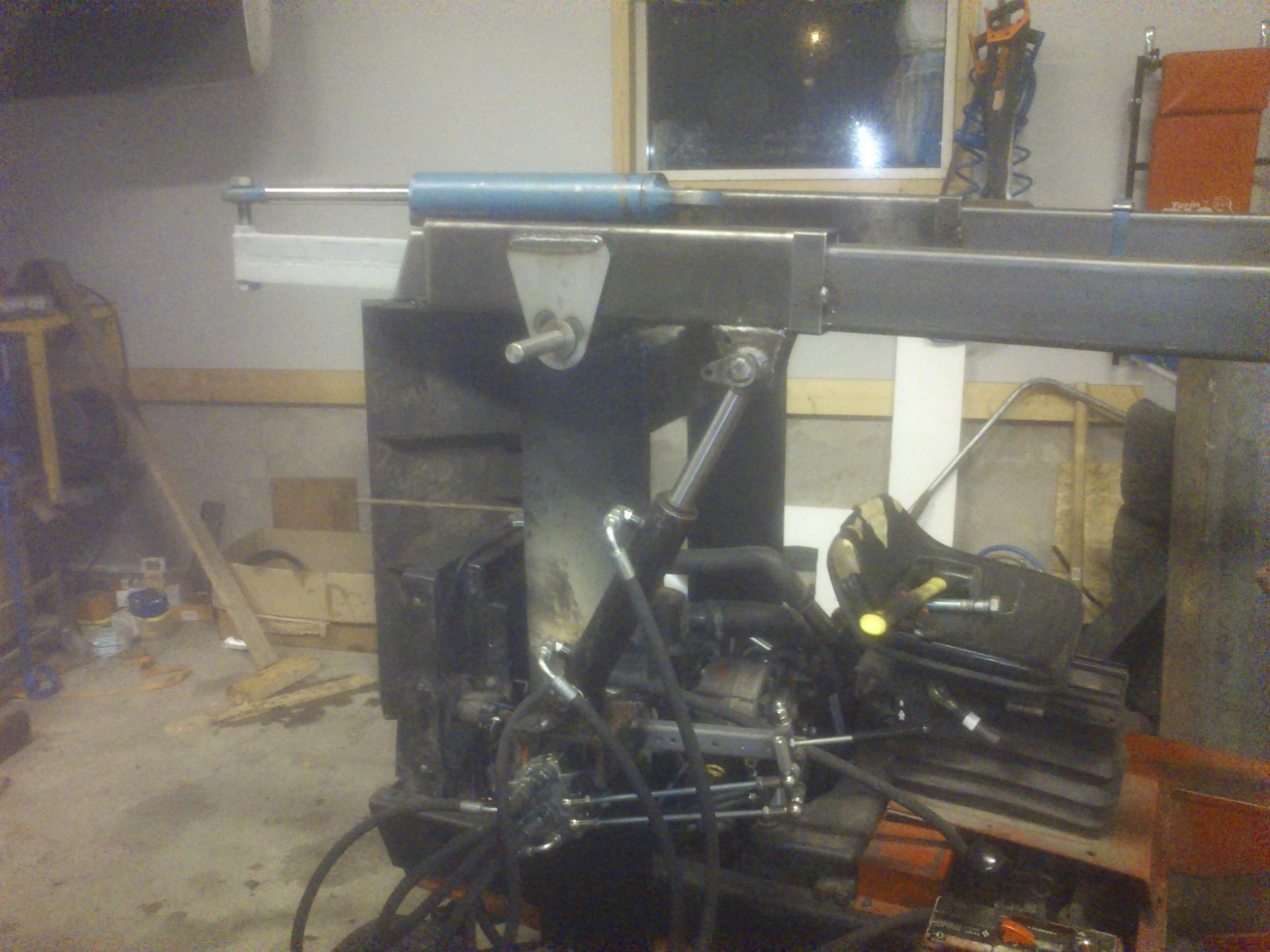

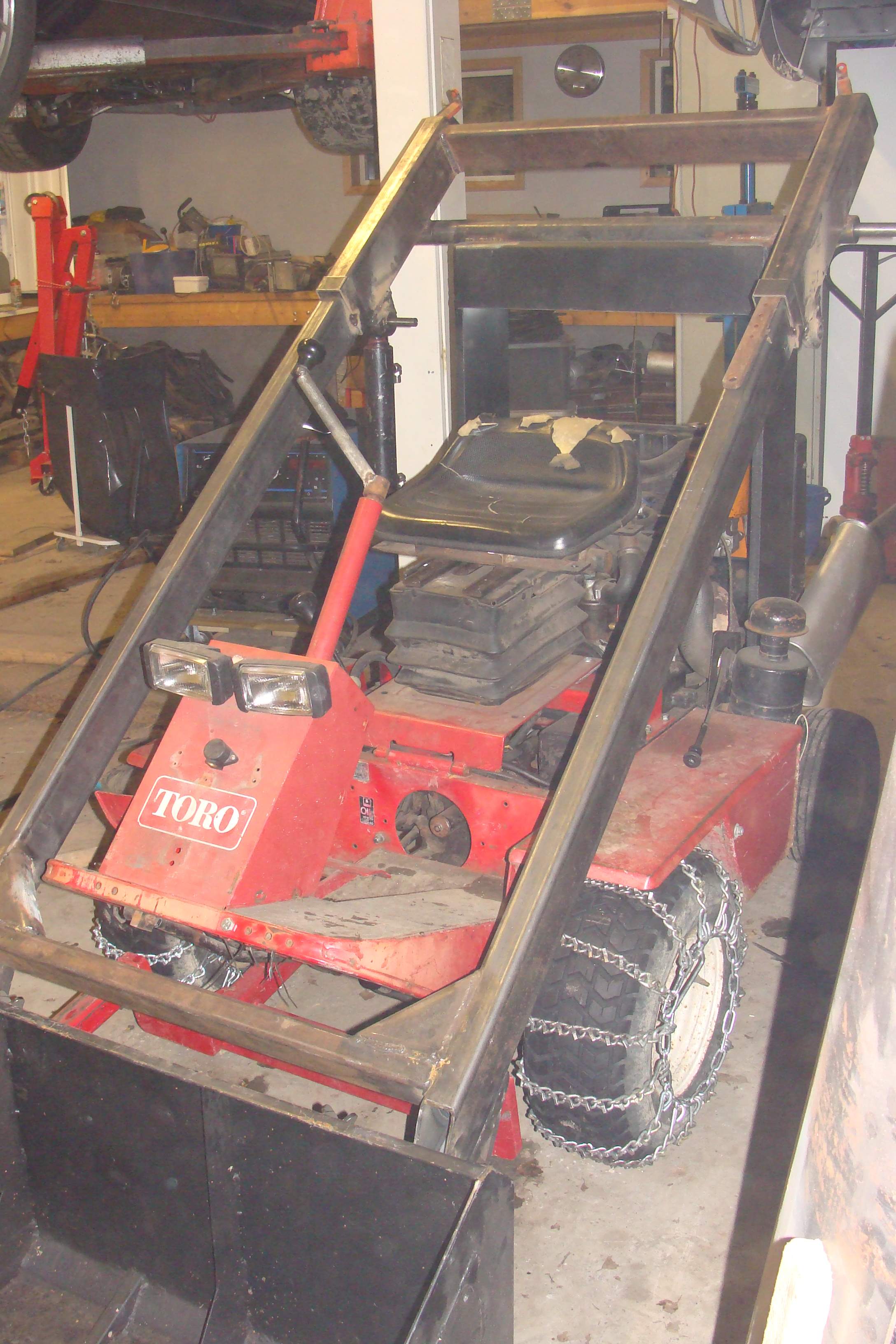

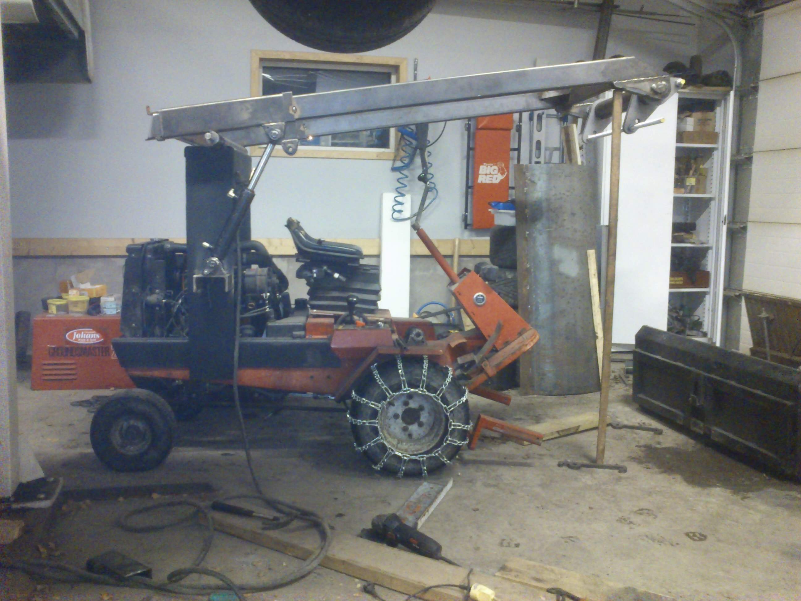

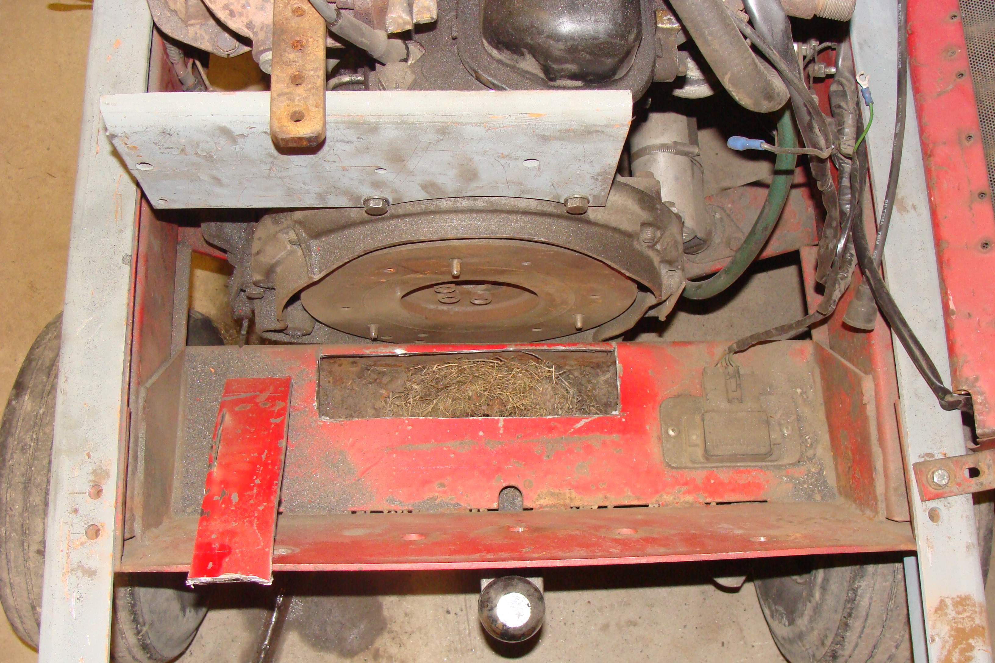

A tower behind the seat.

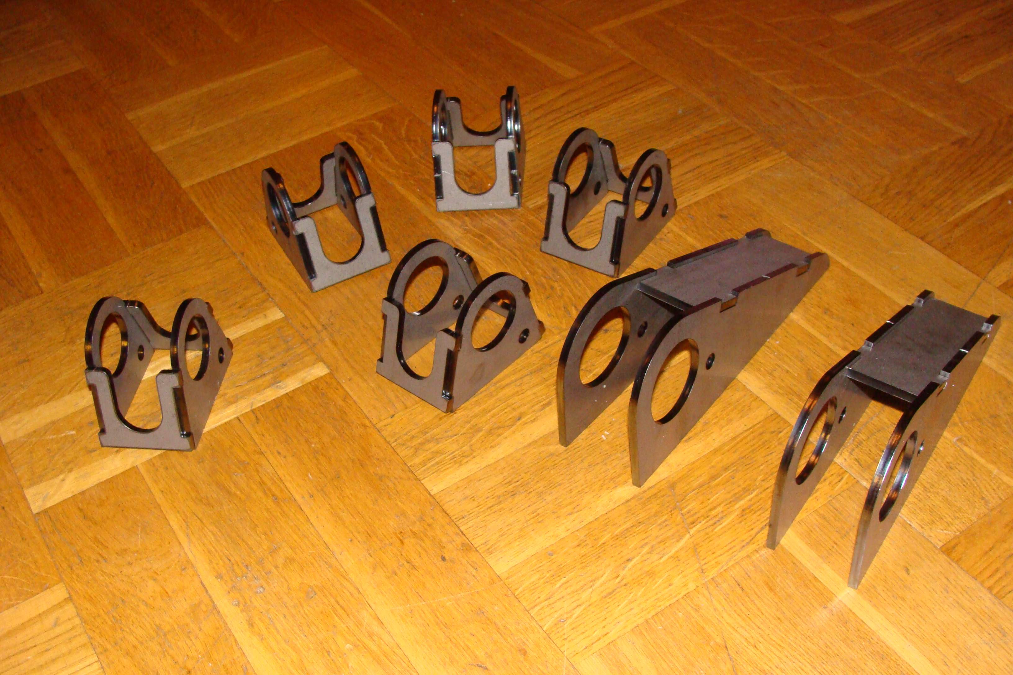

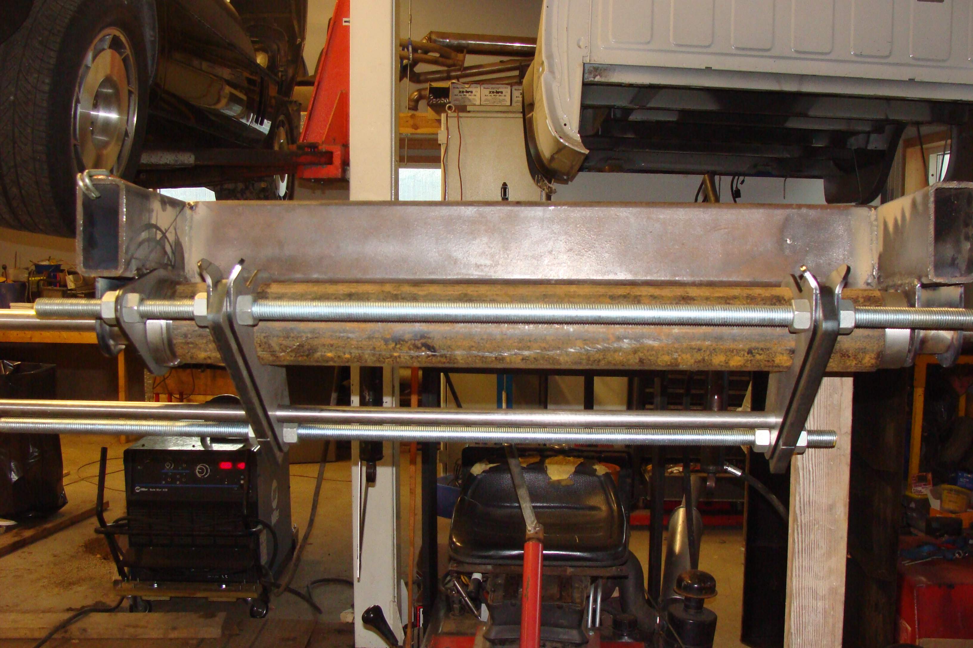

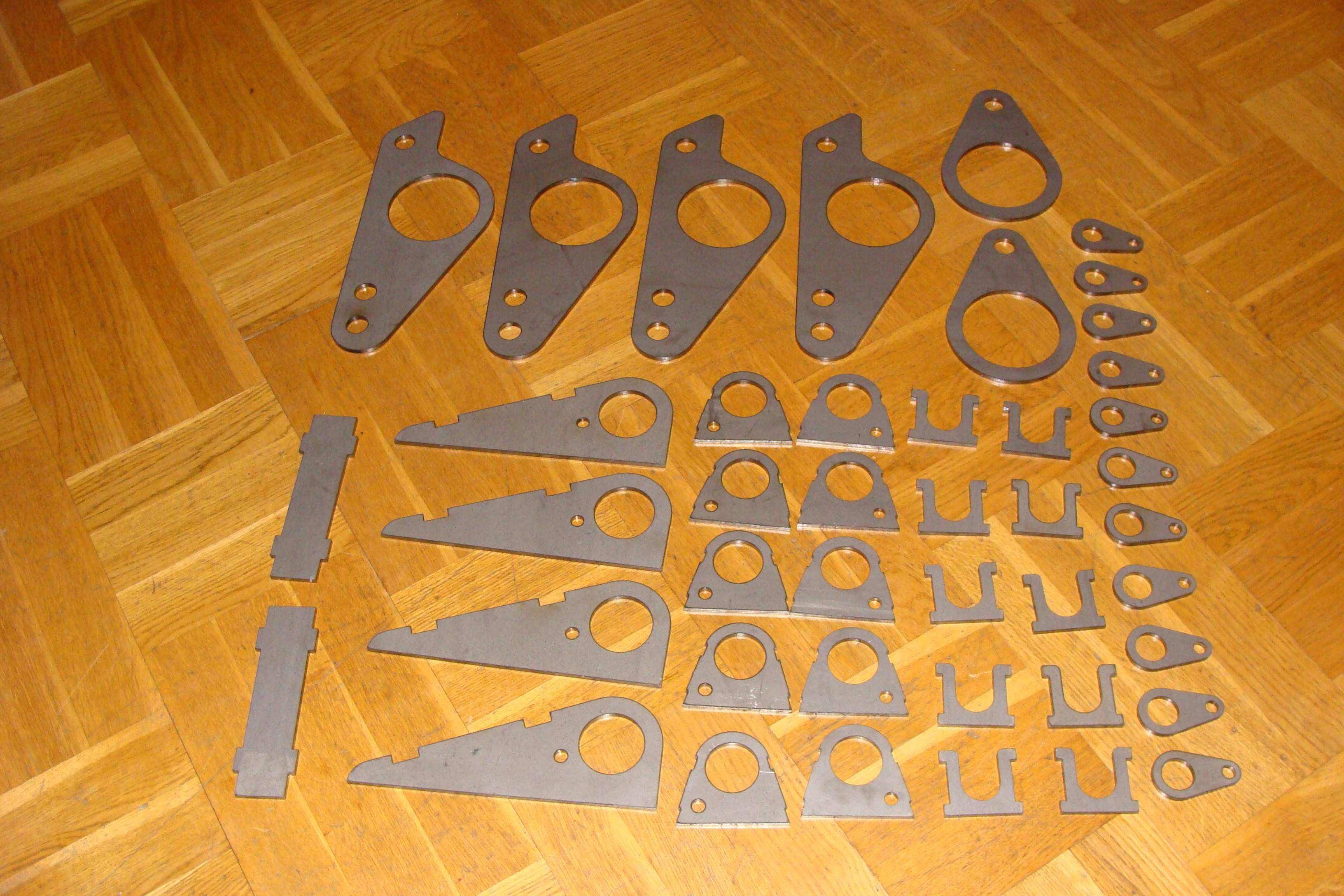

Got some parts laser cut.

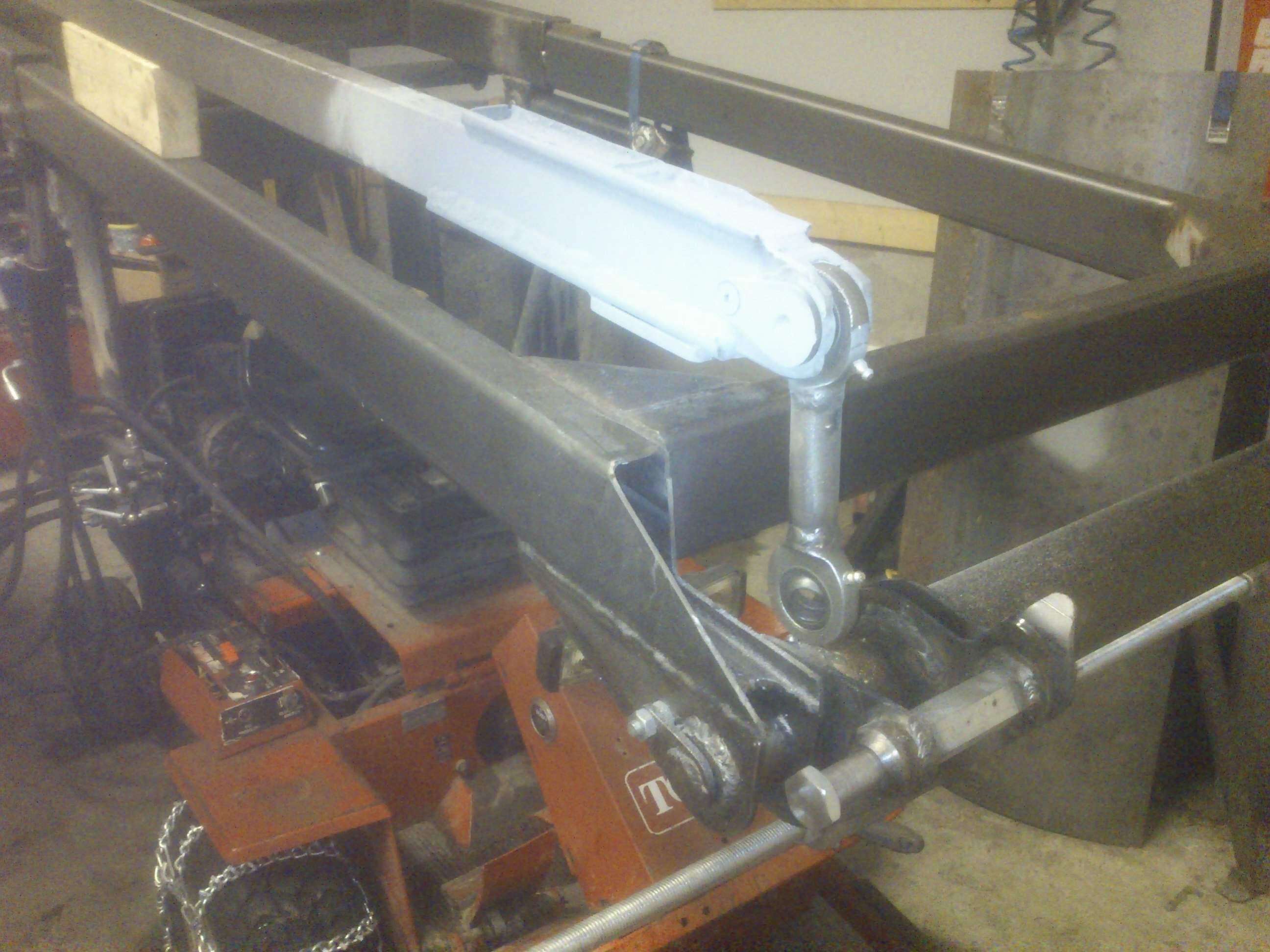

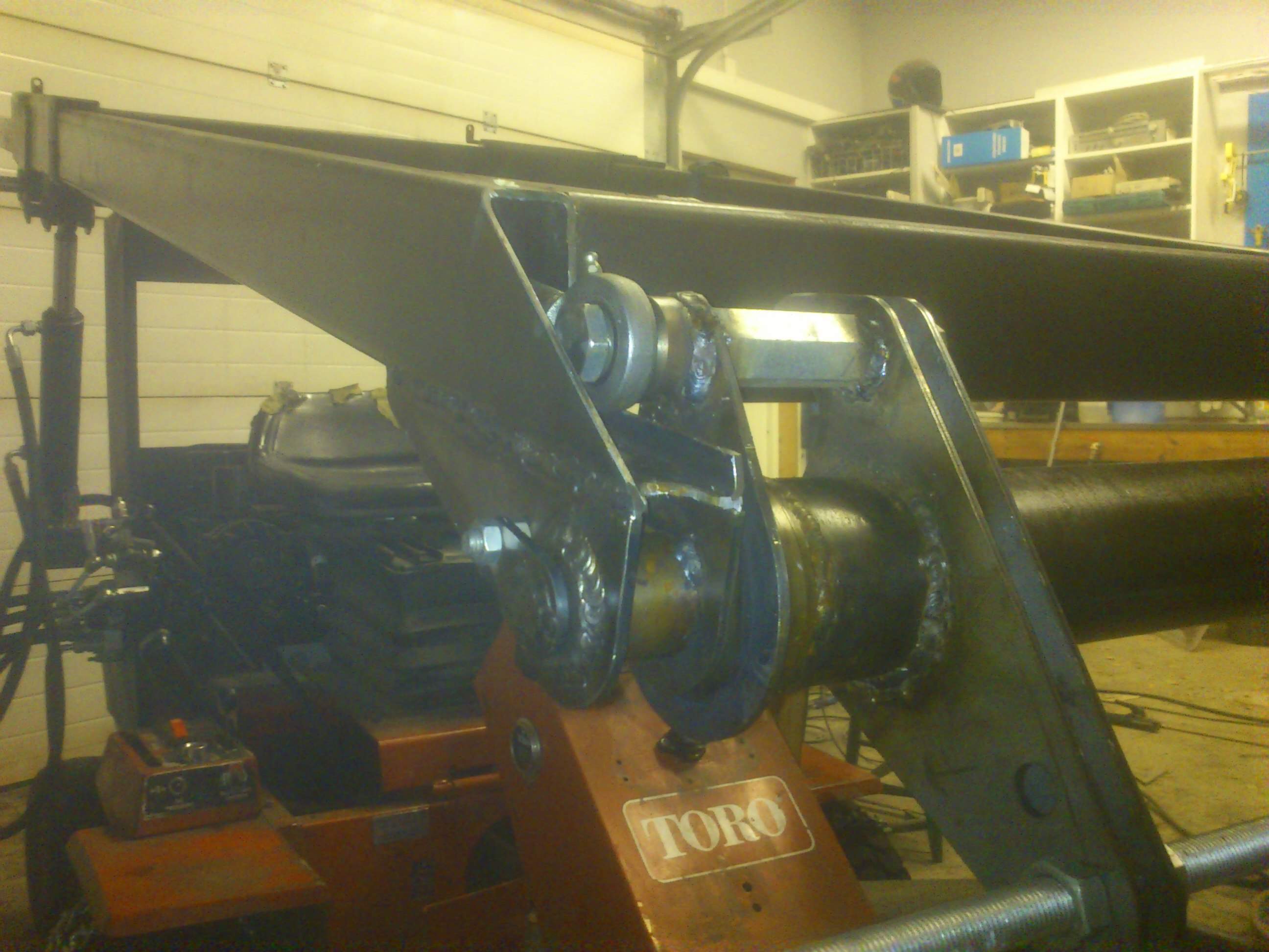

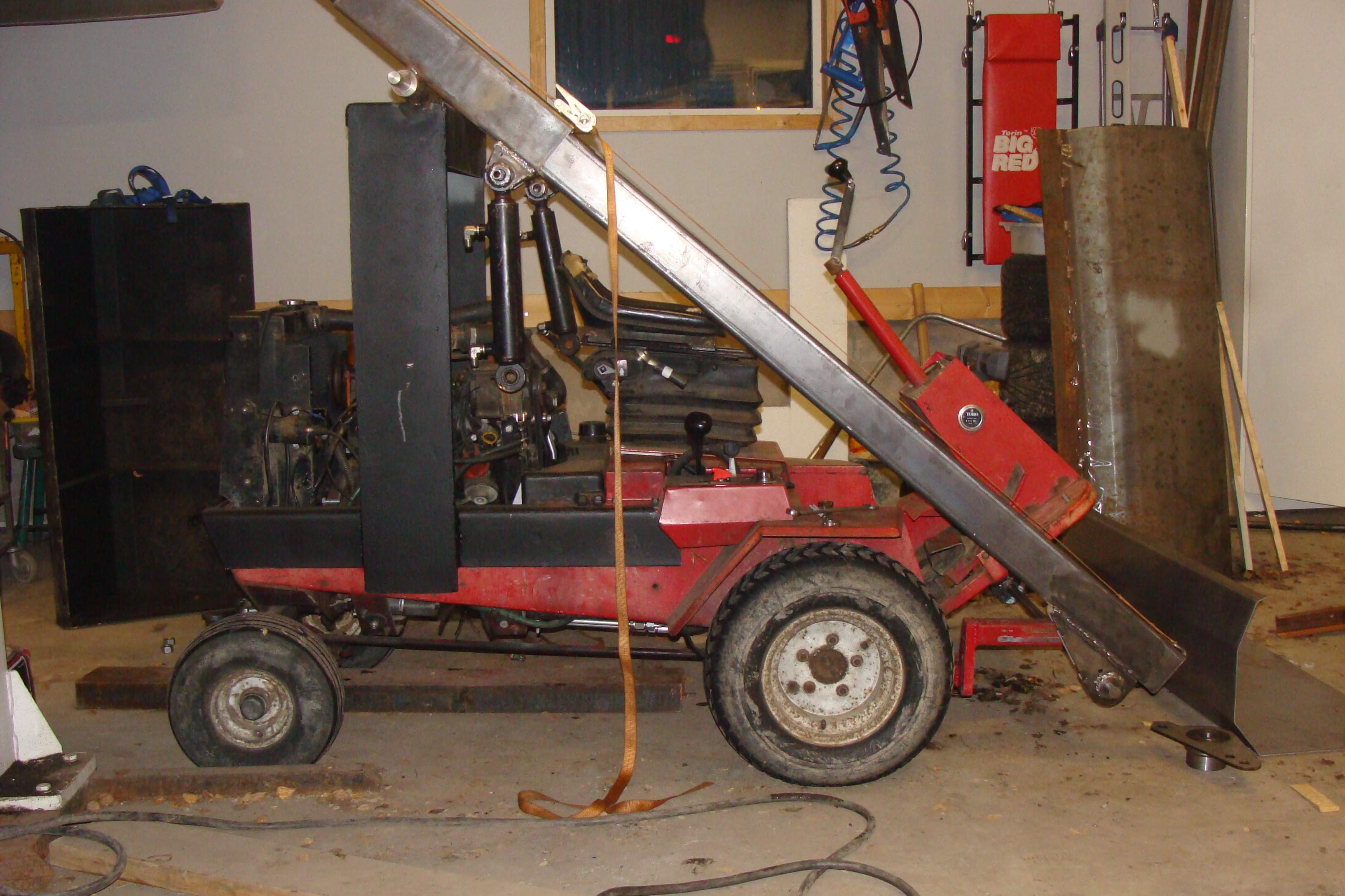

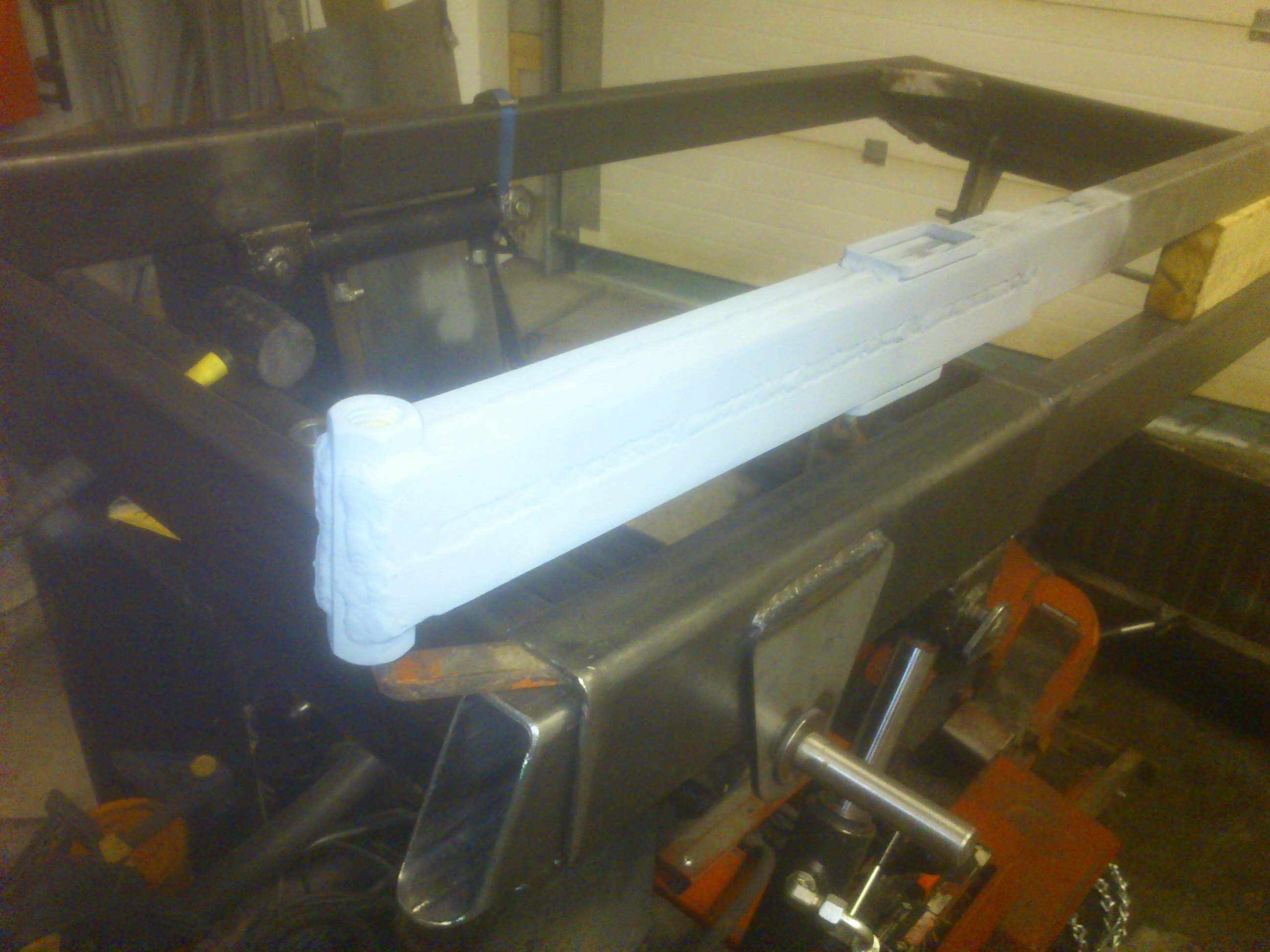

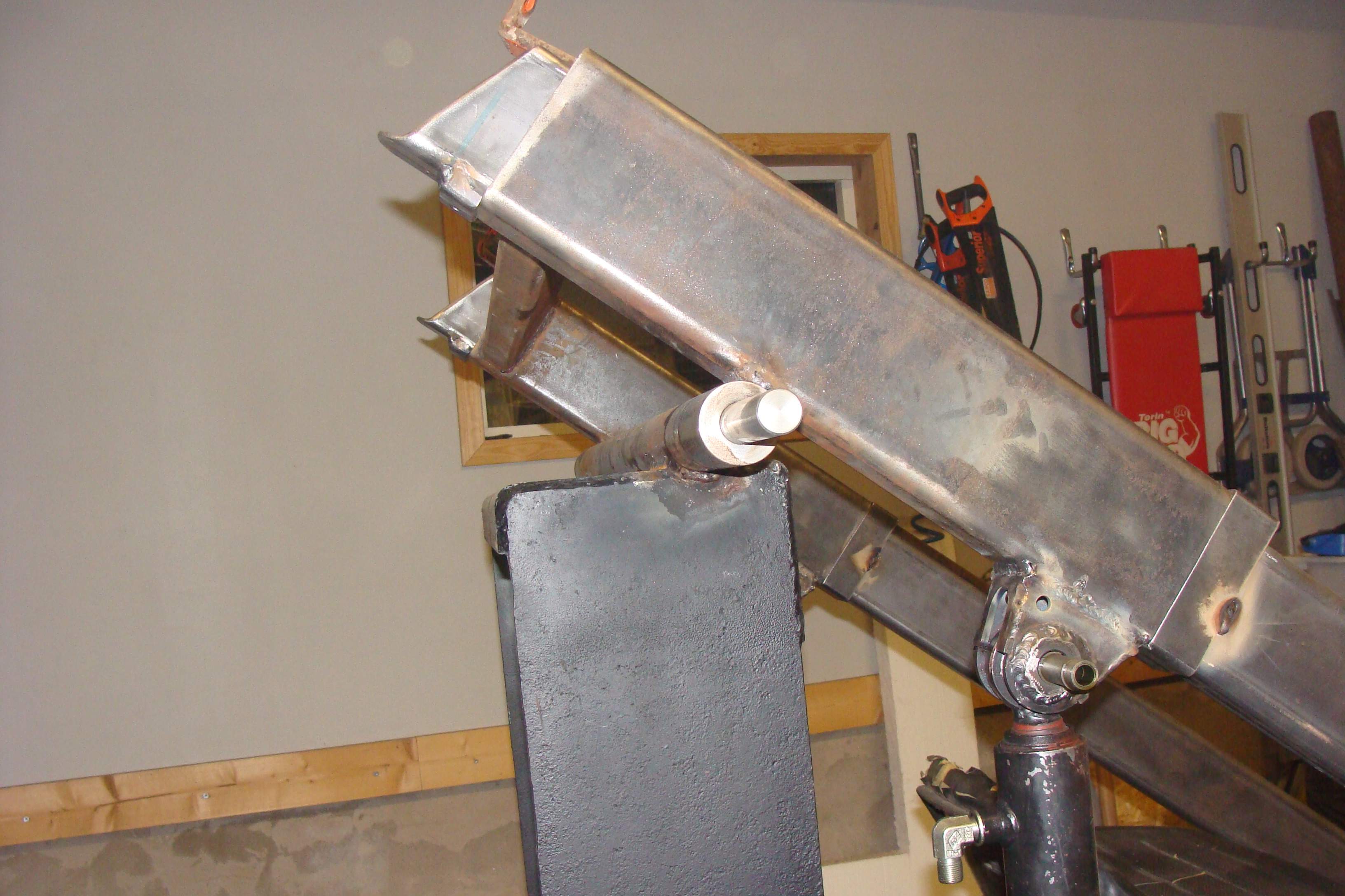

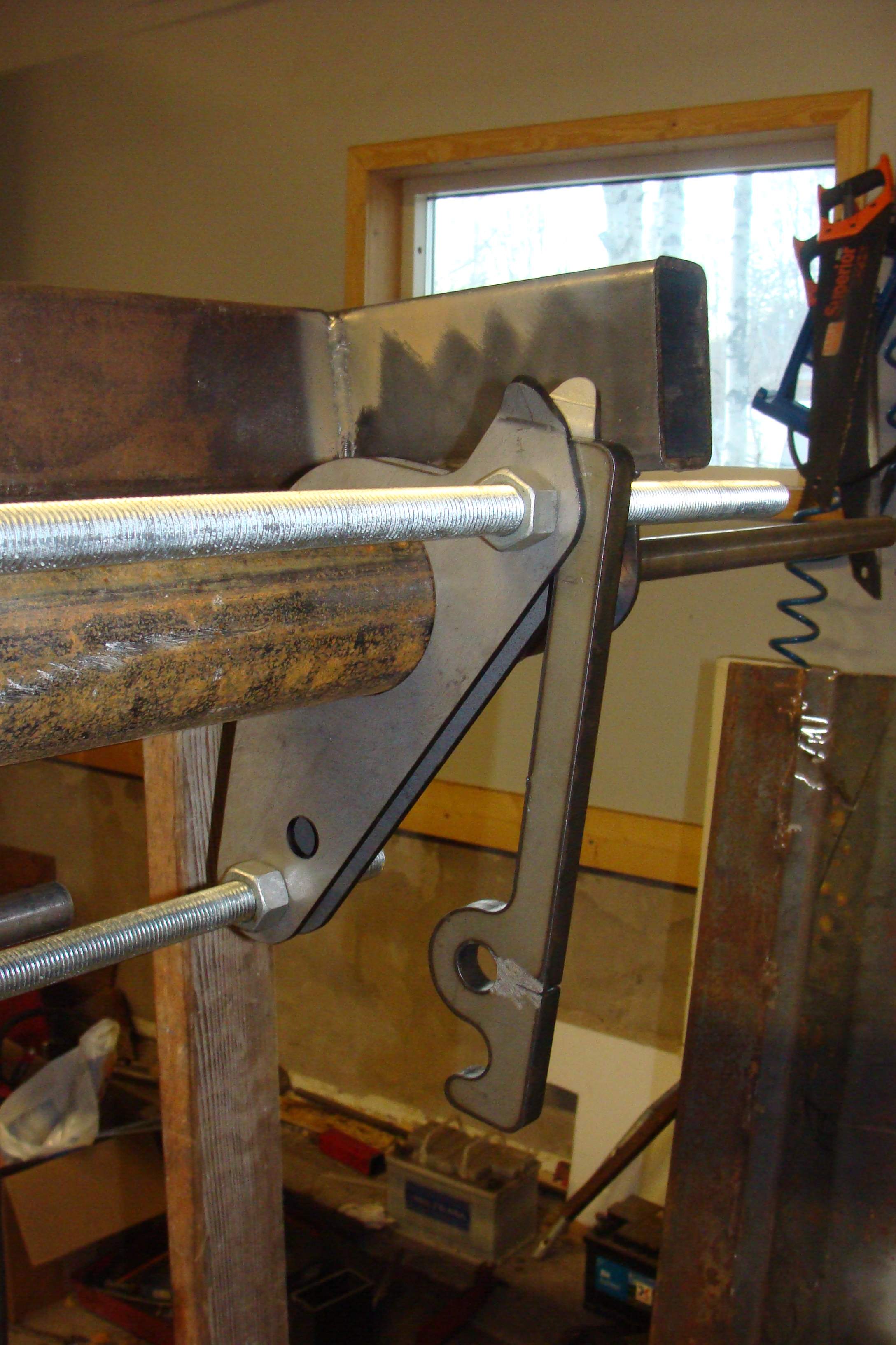

Building the lifting arms.
And the tilt mechanism.
DSC_0225.JPG DSC_0226.JPG*

The tilt works very well. It has almost the same strength thru the whole movement, and it also has a lot of movemet. I can tilt the bucket almost straight down at maximum lift.
With the tilt cylinder at the rear I can also get the bucket closer to the front wheels.
Actually I found your pictures 2 years after I built mine.

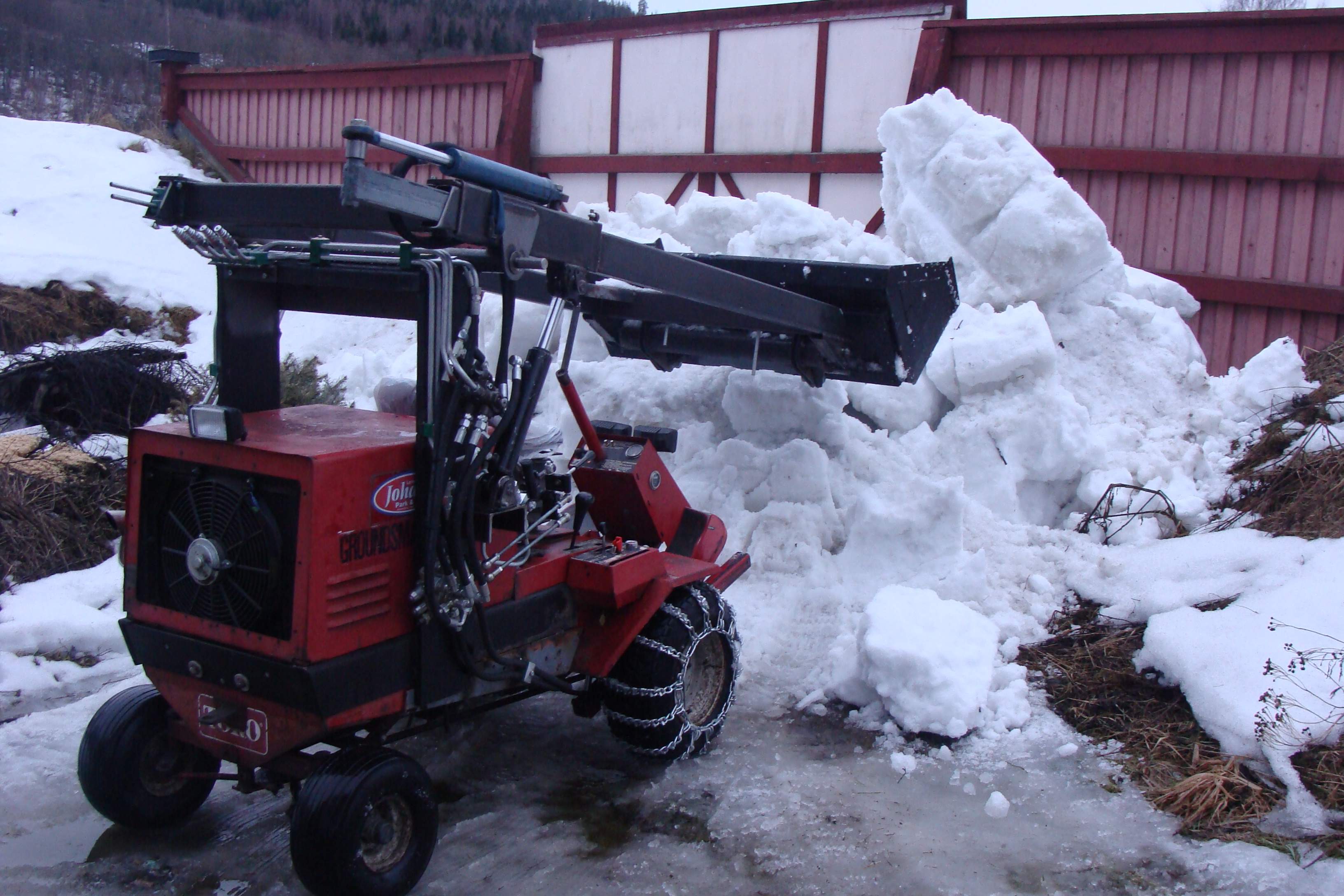

Moving some heavy wet snow. It will get a bit light at the rear when I get about 360 kg ( 800 lb ) in the bucket. The hydraulics will lift over 400 kg ( 880 lb ) at the front of the bucket.
